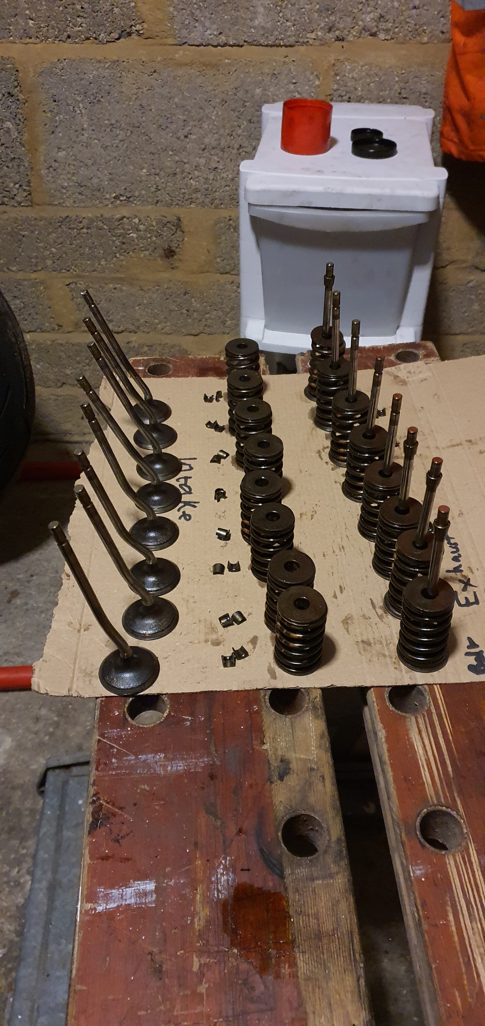

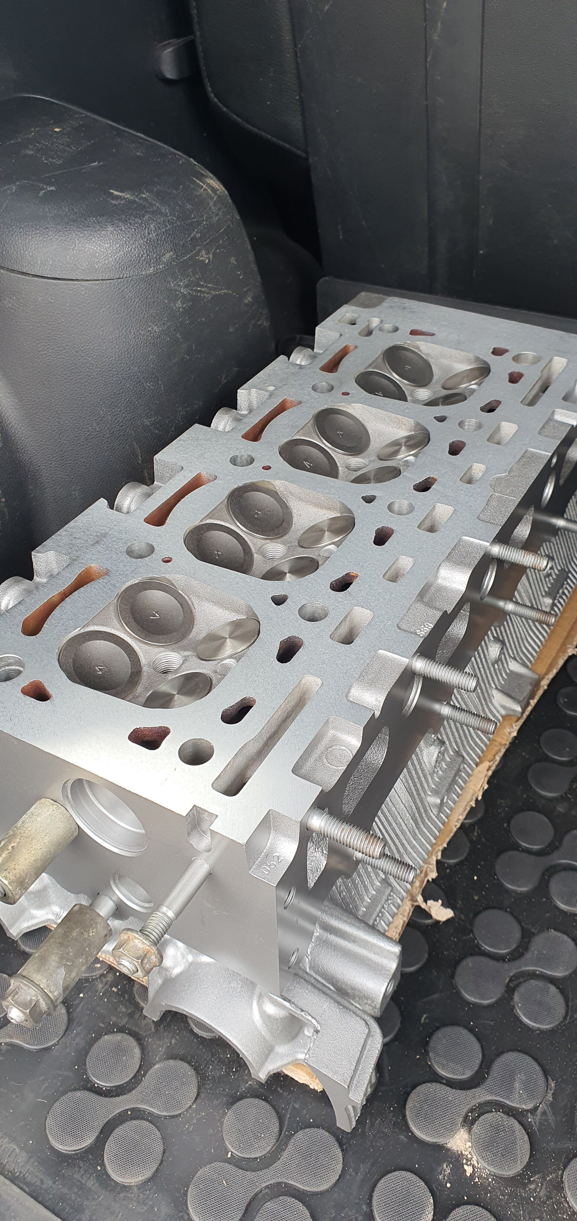

Happy snap of the the head the first time this happened and after instalmentof new standard valves
