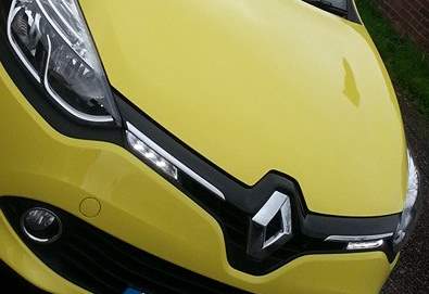

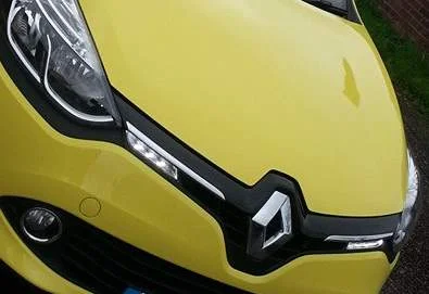

Hi,
I was thinking of getting a black gloss cover for my Renault badge. I have a Clio Mk4. However, because the badges are the new ones so they're bigger than the old ones, nowhere are doing covers for them yet.
So, maybe i could wrap it in a gloss black vinyl. However, i have never done this before so can anyone give me any tips on how to do this?

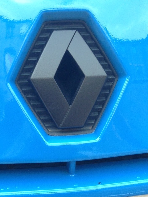

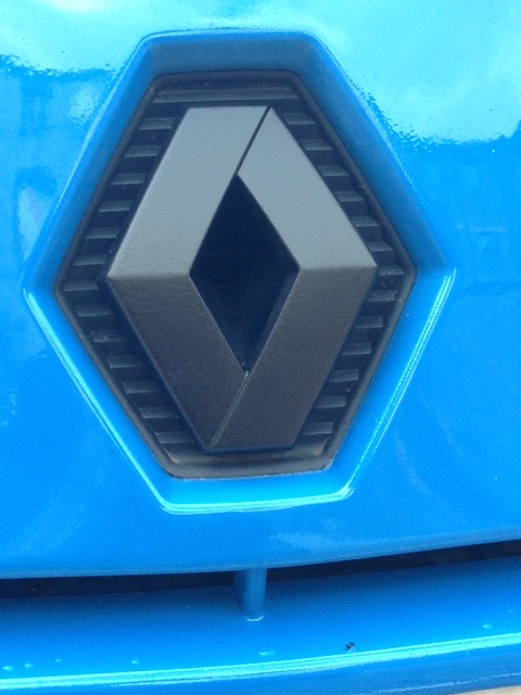

Plastidip is what you're looking for... Mask the surrounding trim and spray on a few light coats, building up the colour each time. £15-£20 a can on eBay and if you don't like it. it'll peel off.
Wrapping can be tricky to get perfect, but if you're dead set on that route, have a hairdryer, a felt squeegee, a craft knife and plenty of patience to hand!
As above, best off taking it completely off the car, whether you wrap it or plasti dip it.
I did have a look on youtube about how to do it and ive not got the patience lol i might look into it though! Thanks!

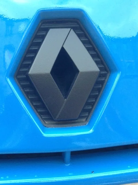

I used plastidip on mine. Very easy and as mentioned earlier, if you don't like it you simply peel it off.
Not sure if they do a gloss version, but think there is another spray they do to give it a gloss effect after putting the colour on.
Plasidip tip. Go light with the spray. Even if the first few passes look like a bit of a spatter effect rather than coverage.
4 or 5 very light coats building up give a much smoother finish than going for quick coverage with it.
Good thing is, if you're not happy with the finish just peel it off and try again.
