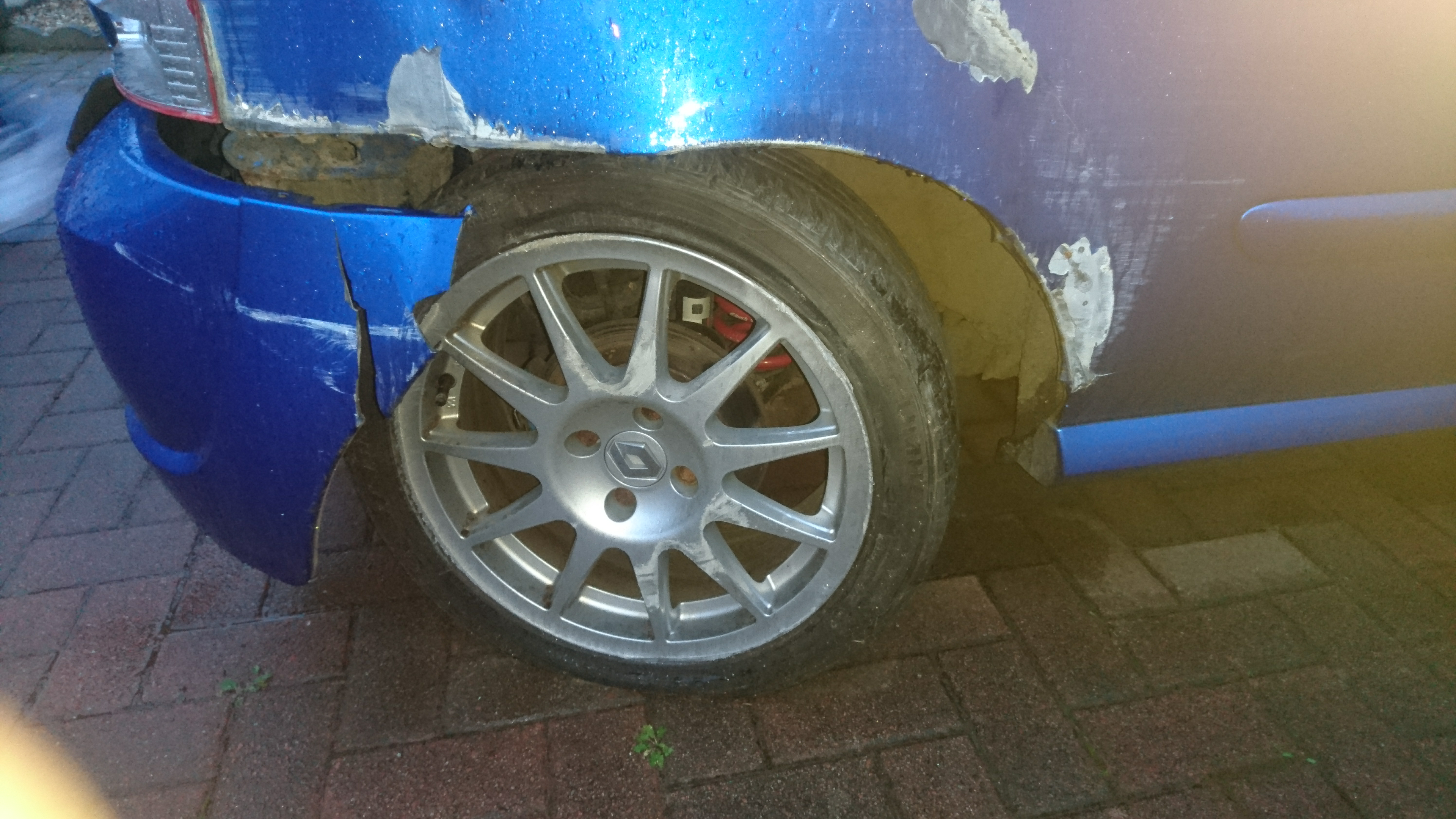

Sorry guys been really but with work had no time to get back on here or have a proper look over car.. I just assumed its a write off but could possibly be fixable.. I snapped a few quick pics earlier on which i will upload when i can.. Need to get the back wheel off and i can see the extent of damage just got no time at the moment.. I know feck all about cars either which doesnt help.
Came round a bend at just under 60 and lost control due to wet road and my s**t driving.. Back end slid out and back drivers side smashed into a metal barrier, back wheel is bent and doesnt move also moved the full tank back a fair bit.
Guys asking about alloys im afraid they are all scratched to pieces due to bouncing off barrier and hittiny kerb on other side of road.

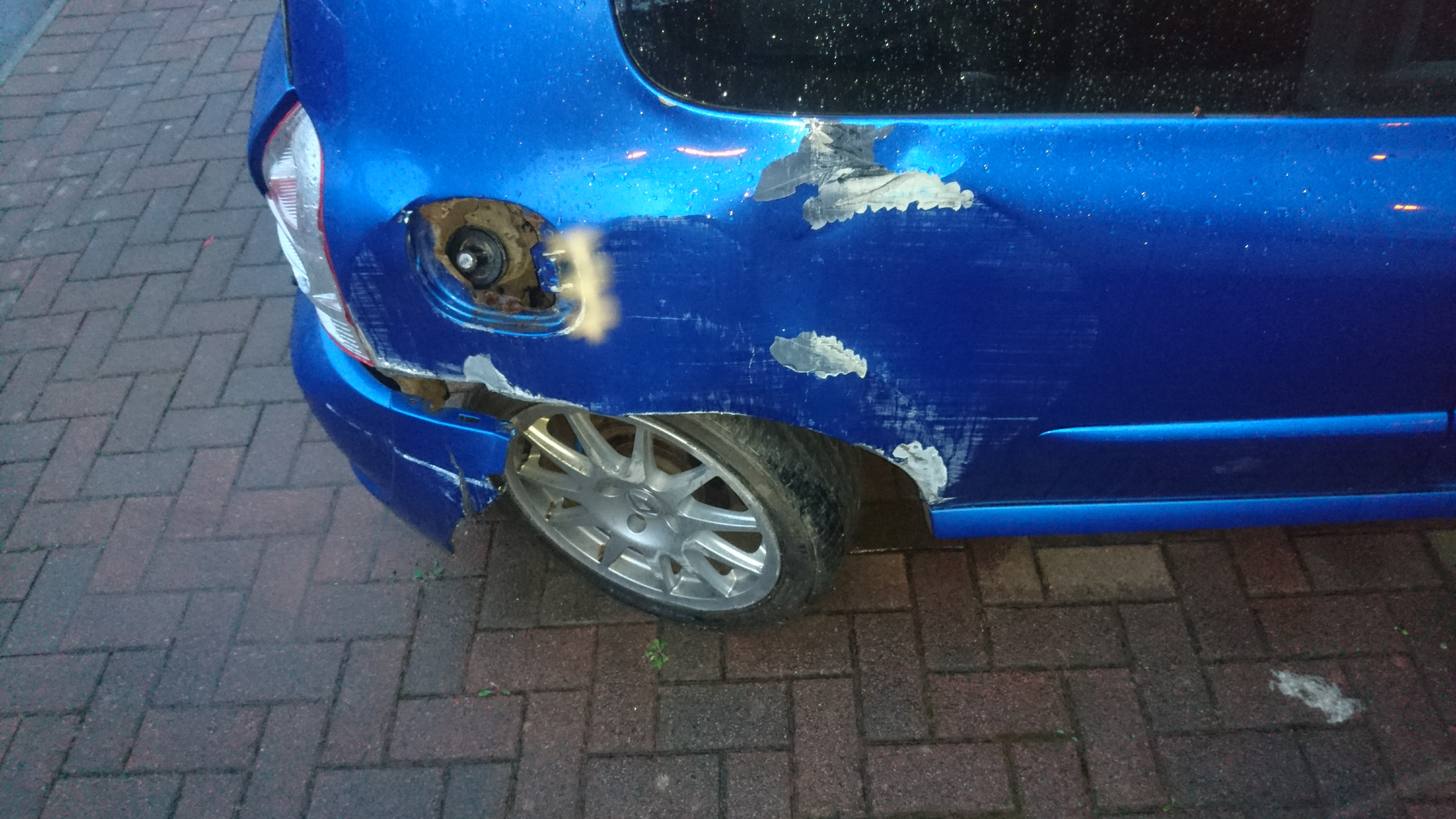

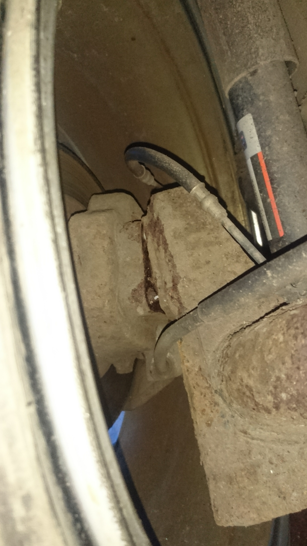

Sorry if pics are huge.. Can anyone tell me anything going off them? That all i can get at the moment will hopefully get wheel off and more pics tomorrow.

That would repair easy enough.
The stub axel is held on with 4 bolts, in that picture of the rear wheel bent around they look like they have bent.
The rear 1/4 looks like it's been repaired in the pass.

So this isnt as serious as i thought? Is there not a chance the chassis could be damage?
If its just the stub axle thats snapped as above its four bolts to remove it, theres a possibility other things are bent but you could fit the stub axle and take it to a specialist to see if theres anything bent that cant be seen by the naked eye.
Get a 172 cup stub axle tho as they are a different offset iirc.
You will need a new back bumper about £30 second hand and a your rear quatre sorting obviously.

Year i think it has been repair in the past.. Found out after buying it was write off in 2006.
How much am i looking at to get all body work repaired? Boot lid has a big dent in it too somehow..
