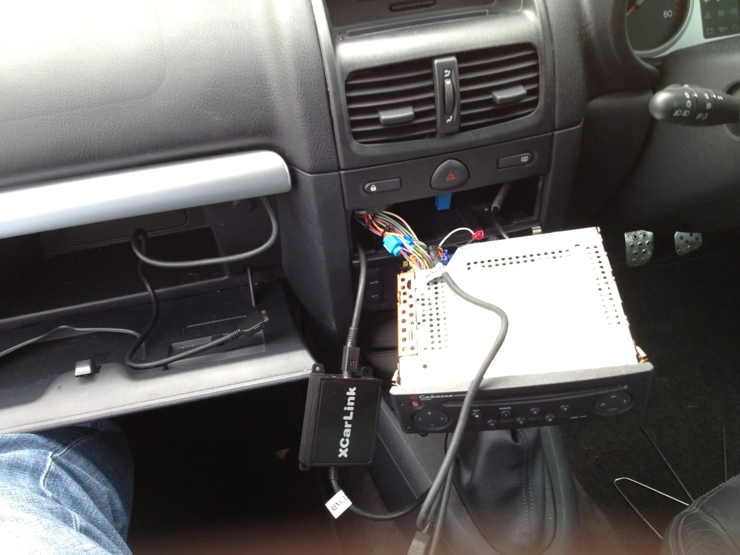

Just received my Xcarlink from MT Audio and installed it earlier today.(RS Clio 182)
Here's some photos if of any use for future ref.

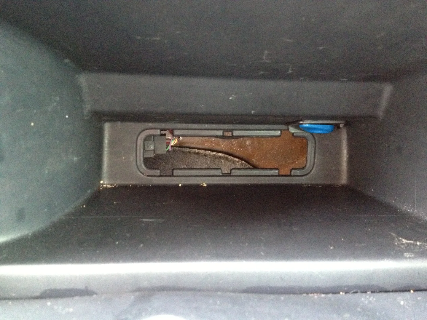

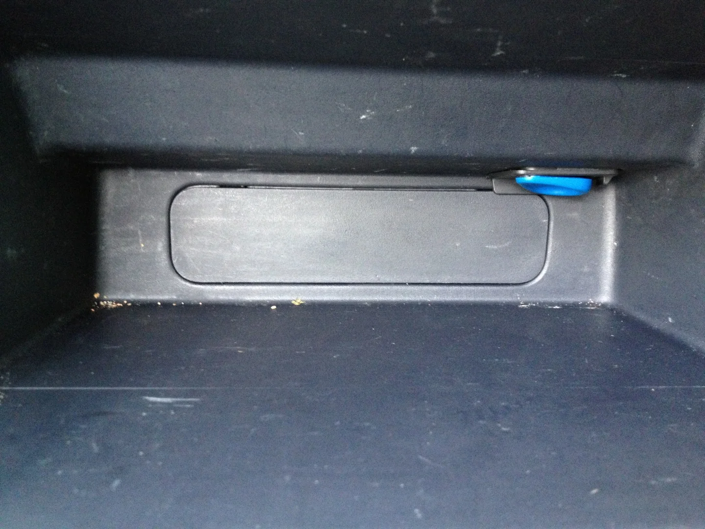

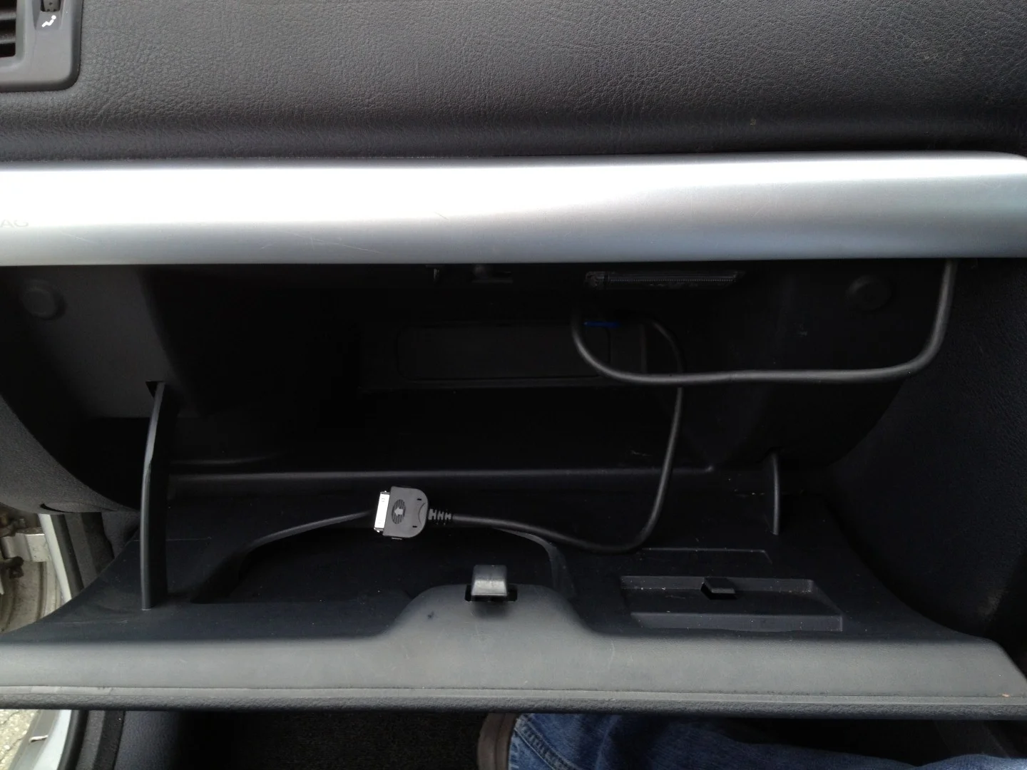

I installed the IPhone cable in the glovebox, i had the option of the rear panel which pops out,
but also a hole behind the silver trim from previous owner car phone kit -
so i went with that as it was easier to pull the cable thro.

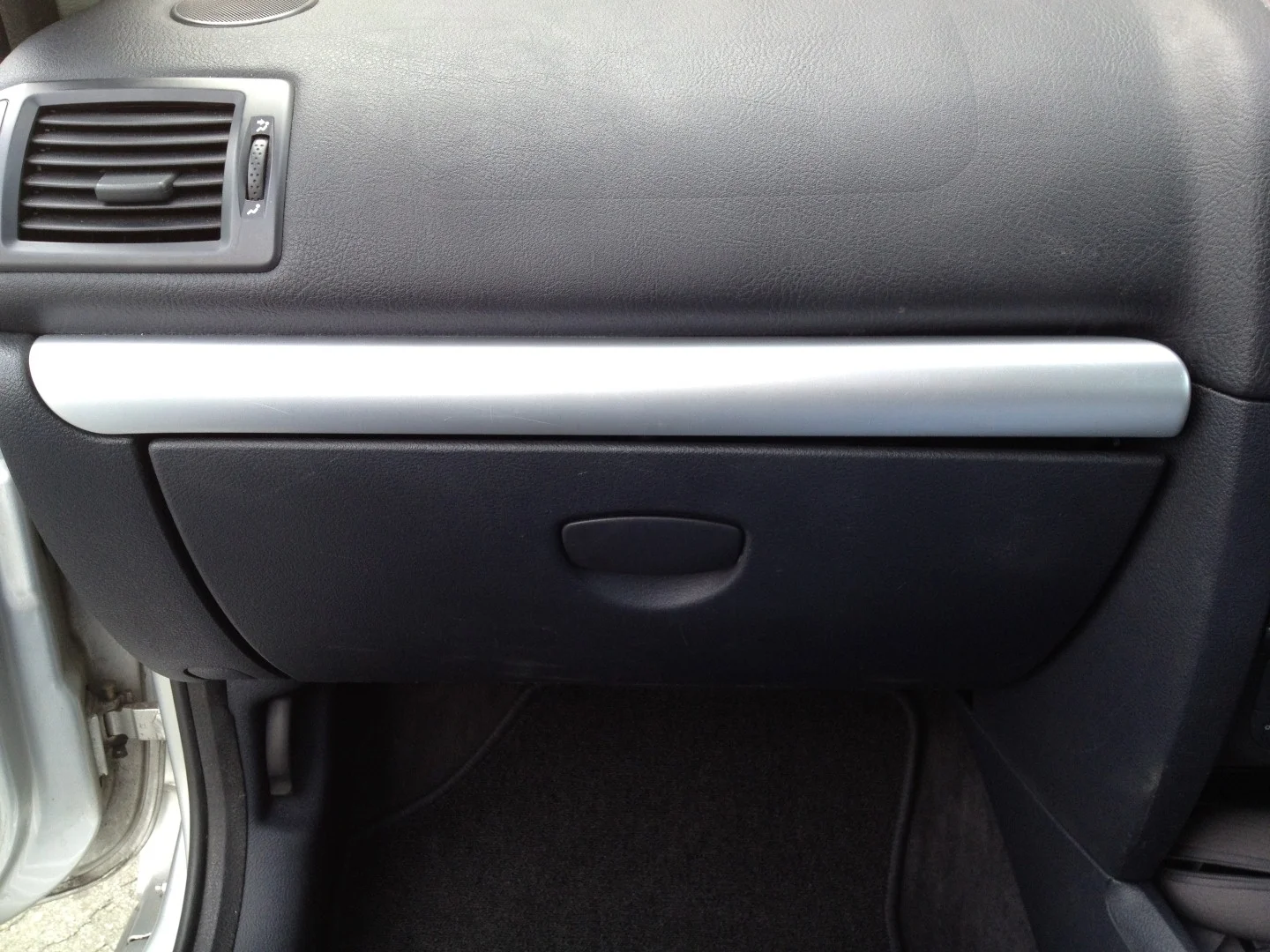

Sounds great, charges iPhone 4gs and controls work great from steering wheel,
glovebox closes fine.

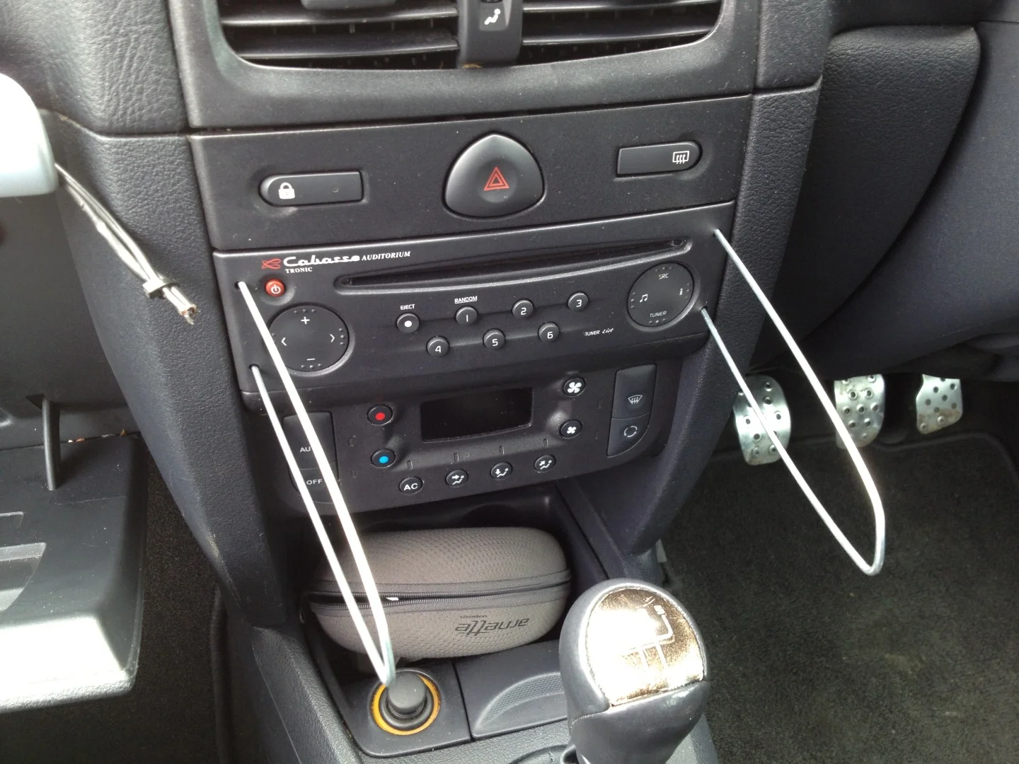

Coat hanger were the 'removal keys'
It's man happy time of a friday...time for a beer..
