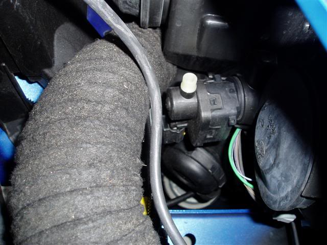

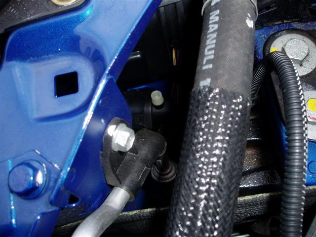

There's an adjustor on the rear of each light. It's a white allen bolt that needs adjusting.
Just make sure you do it with the engine on, otherwise they'll reset first time you start up!
Iirc you can adjust them with the little white allen screws . I think you have to do it with the ignition on from what i heard or they reset them themselves when you turn the engine on .
