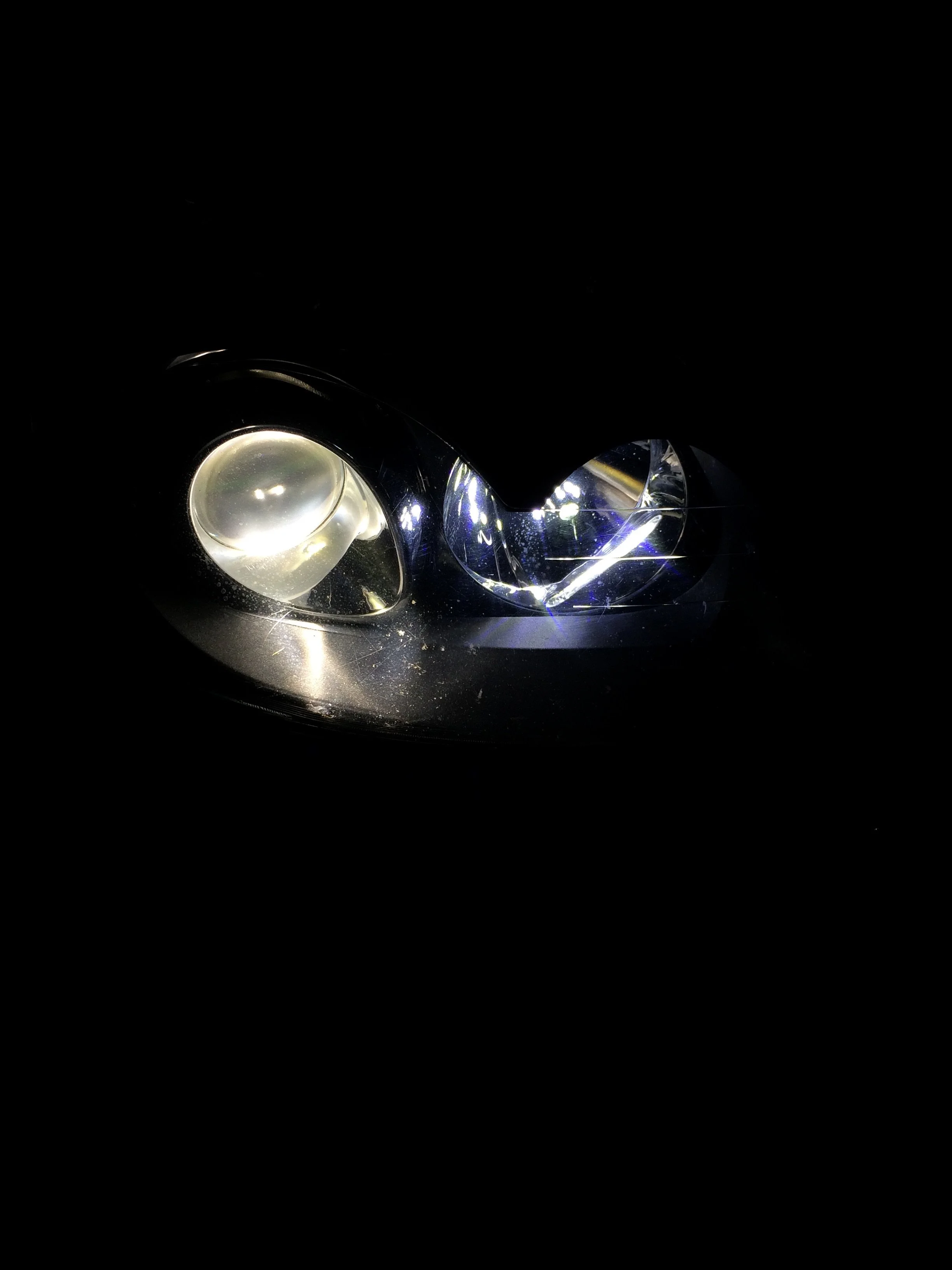

Fitted some new xenons today. Have a few questions.

As mine is a 1.2 do they still have auto levelling? I heard the motor going while I was lowering the car off the jack and often hear it, but don't see much movement in the lights. They are quite low already, It isn't a visible straight line, but I think it's because of my side lights. I know there's a sensor on the rear beam in the middle iirc? Does a 1.2 have that or do I need to manually adjust them myself?
