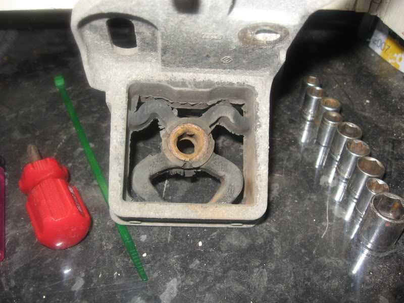

one of my rubber x shaped rubber things is saggy, how much are these from reno? or where else can i get one
and should i buy a pair?

They're about £17 from Renualt. About the same from K-Tec.
Order from K-Tec using your CS discount (Found in the K-Tec sub section of the Trader's area on the forum)....and they're £12 each.
yeah the brackets are crap theres a guide in the guides section on how to make them last longer.

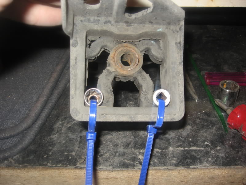

Yeah thats the one. I found you can use nuts (the ones from bolts!) instead of socket heads. Theres plenty of other ways to do it if you do a search.
yeah ill try that later if i can find some nuts, thanks alot saved me over 30 quid i reckon
done it,well one side lol the side that was sagging by 2 inch`s ,
before
after
sitting much better now, but defo gonna have to do the other side at one point
