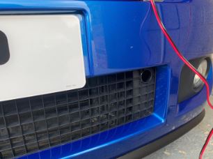

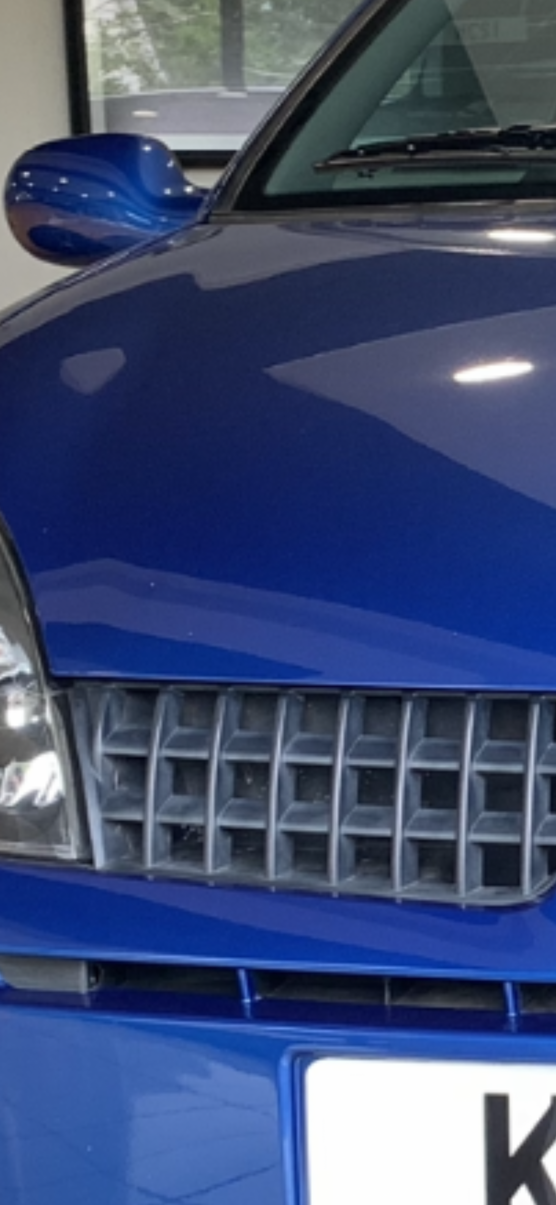

So I have used Autoglym Bumper and Trim Gel on the lower grill and the results are great although not sure how long it will last, it however made no difference to the upper grill. I'm considering using the Gtechniq C4 but it worries me that its going to be a bit fiddly and if its not applied evenly the finish wont be that great.
Should I just leave it as is, I mean it doesn't look bad, think I just remember them being less grey, any suggestions?

I've used C4 on the upper grills and can recommend it. Just make sure its as clean as possible before applying and it doesn't get wet for about 12 hours so has time to bond. Once you apply it wait a few mins then lightly wipe with a microfibre cloth so it gets an even finish. It should last around 1-2 years before needing done again. C4 Also works on the rubbers around the window, foglight surrounds, wing mirror plastics and rear bumper black plastic. Although on the original Cup splitter it doesn't work very well.

Ok excellent, I will give it a go, did you use the recommended cotton pads to apply it on the grill, id imagine that being difficult?

Thanks, going to give the C4 a try first, can always have it painted if I completely balls it up. I recently applied Autoglym Polar Seal, I assume the Gtechniq Panel Wipe will remove that?
  172 CUP / MG4 XPOWER
The C4 has been applied, prepped it with an undiluted citrus pre wash then panel wipe, used way more of the C4 than I thought I would, probably 10ml of the 15 just on the front grill, seemed to waste a lot getting into every corner although it looks pretty uniform as I’ve buffed of the excess, guess I will find out how it looks in a few hours

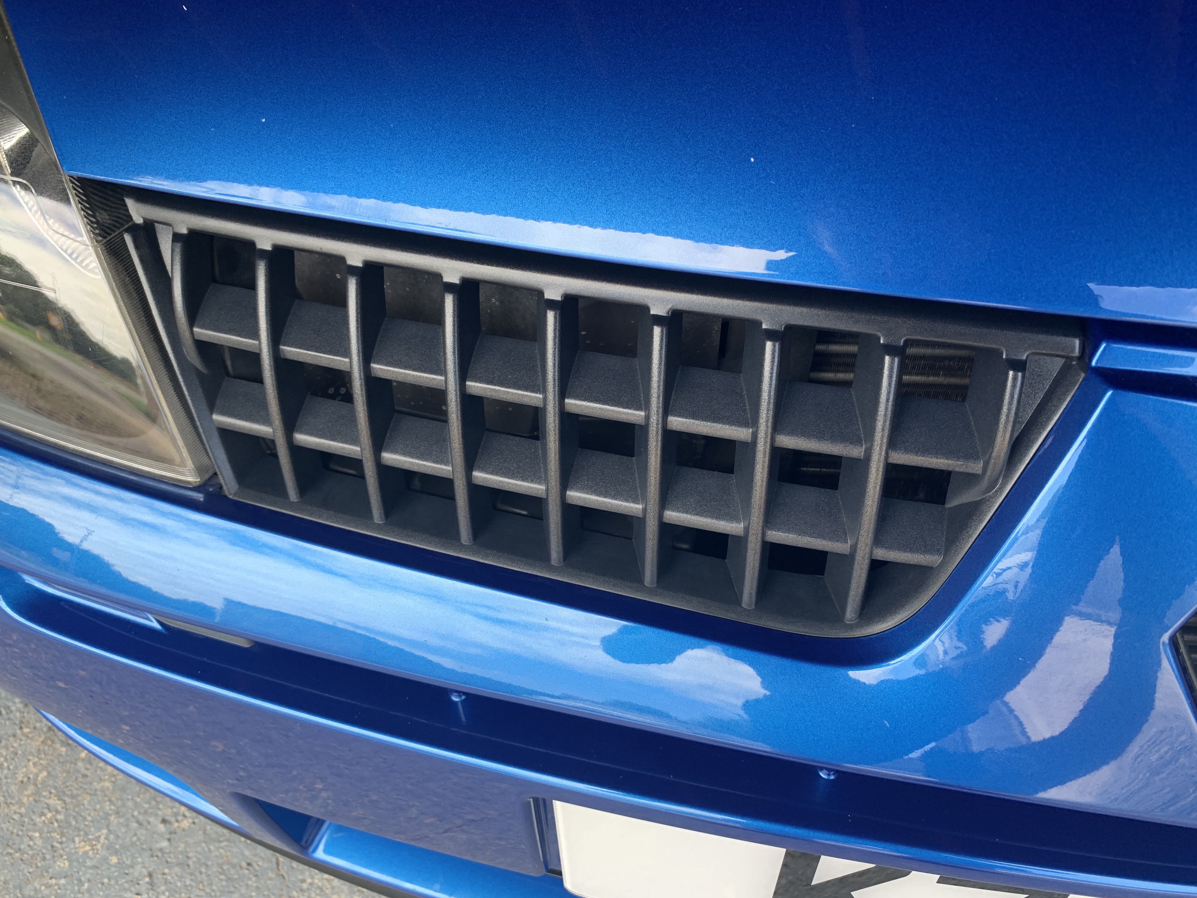

After a couple of hours. Keep in mind Autoglym Bumper and Trim Care made no difference, I’m pretty pleased, looks quite natural
