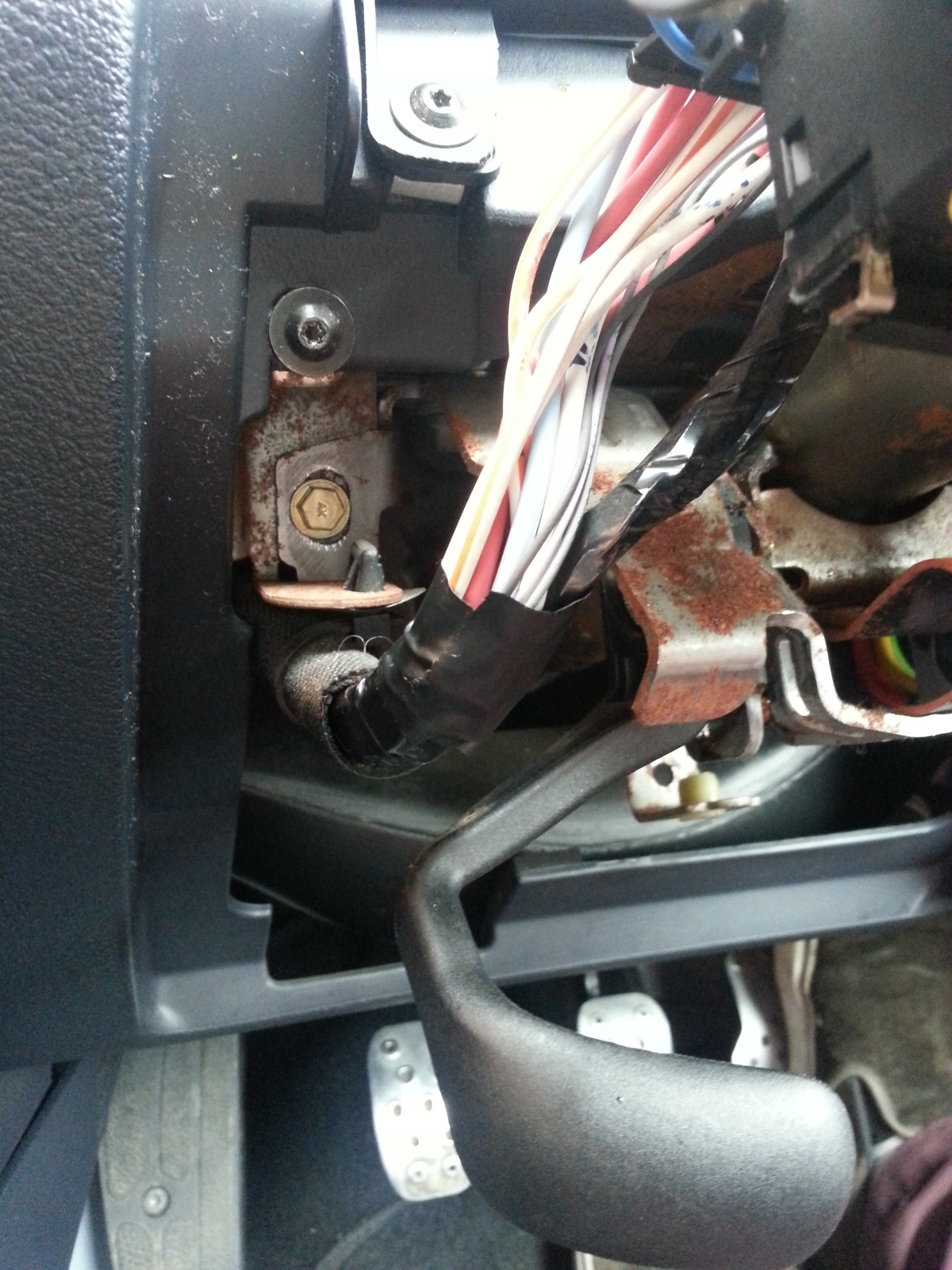

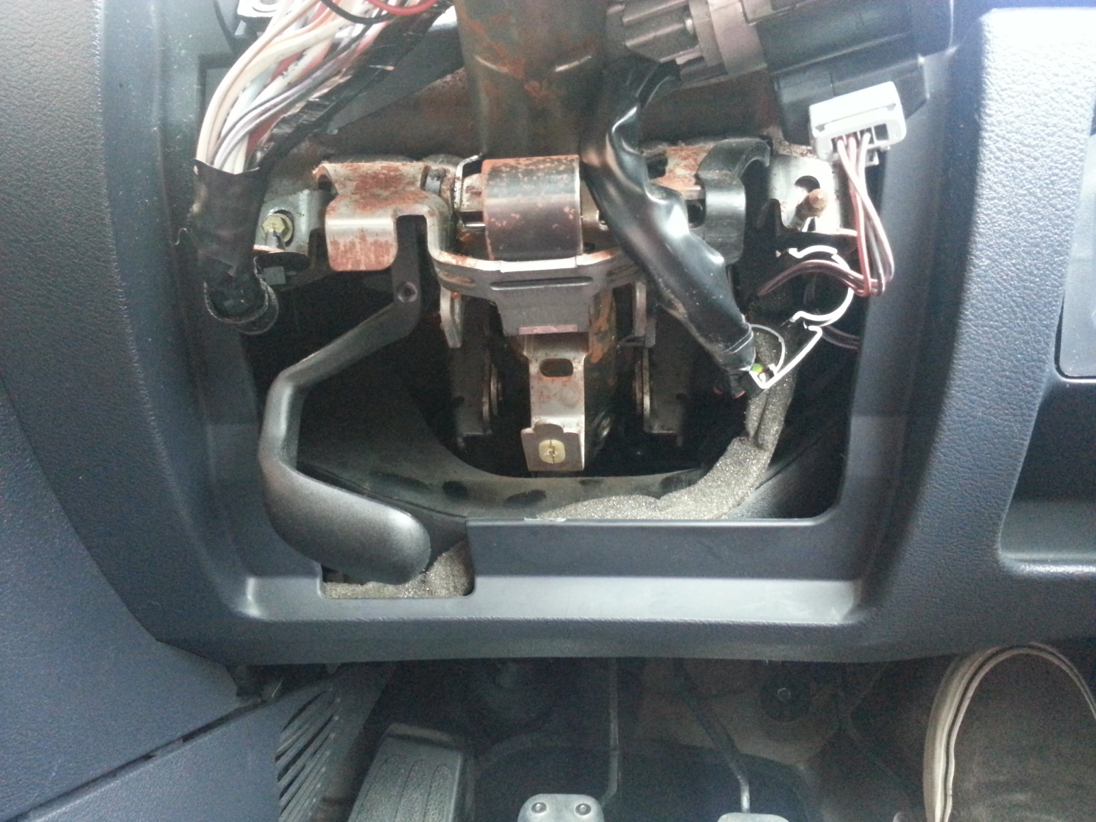

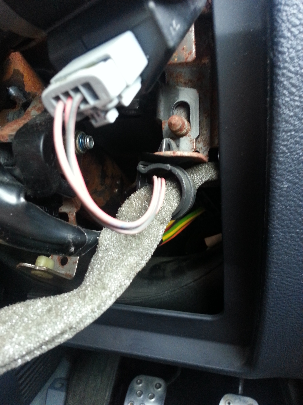

Hopefully just a quick question for those who have lowered the steering column the burpspeed way (using longer bolts).
Basically, I seem to have two brackets either side of my wheel that appear to be stopping the wheel from dropping when the four original bolts are removed.
I do have a little movement, perhaps a drop of around 5-10mm but these brackets/tabs seem to be stopping the column from going any lower.
I have tried to picture them the best I can, but I guess my question is:
Do you have these on your car? Where they stopping the column from dropping? And if so, did you just bend them / cut them out?
Ideally I want to try get this sorted before Llandow, so I am hoping the above makes sense.
Thanks in advance :)
Alex

I just realised its probably not that clear which brackets I am talking about, so I have highlighted them in this picture.
The more I look at them, the more I think the just need to be bent downwards but it would be re-assuring if someone has done this before could confirm.
  172 RaceCar, VW-T5
Thanks guys,
Just bent one out of the way, and it went easier than I expected :)
