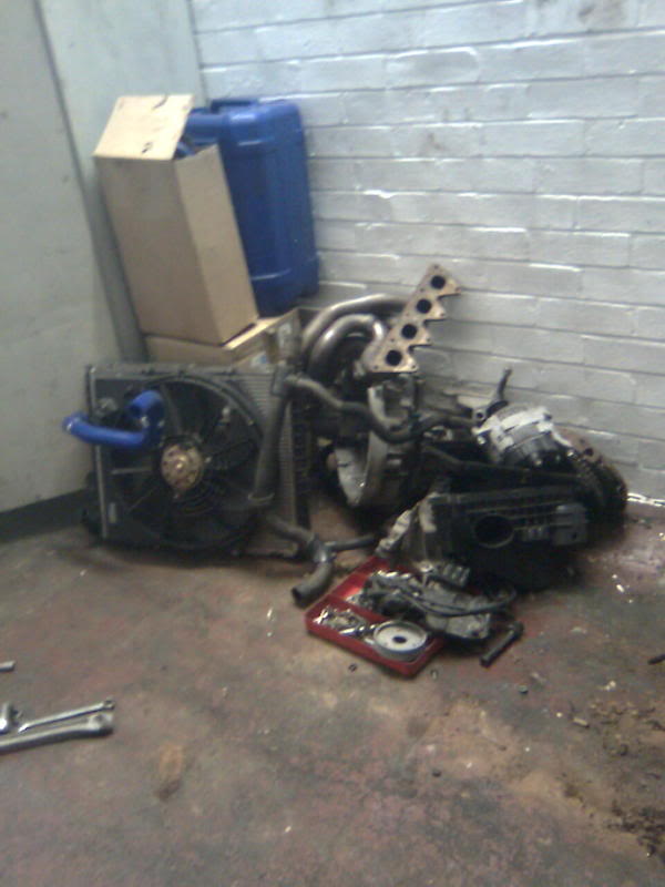

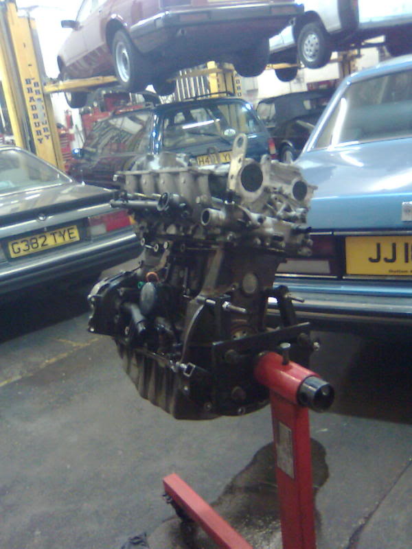

never that bloody simple though is it, after quite alot of messing about. no a monumental amount of messing about,,, i finally have 95% of the parts i need.

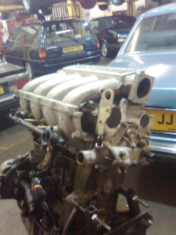

engine arrived today, so went straight up on the stand for a bit of a clean
and my pile in the corner of the workshop lol...

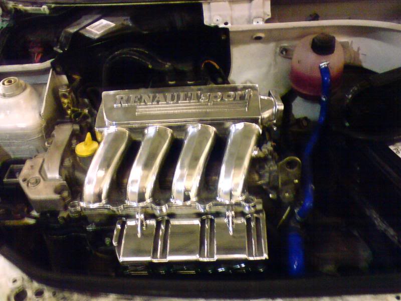

its all getting a bit of a paint/polish up, still undecided wether the heads coming off for a mate of mine to work his magic on or not..
but whatever happens progress pics etc will be on there way:D

exhaust wise ive got 172 manifold at the moment a 172 cat i'll probably be going down the decat route dependant on how much renault want for my list and a new stainless magnex cat back (which i already dont like)

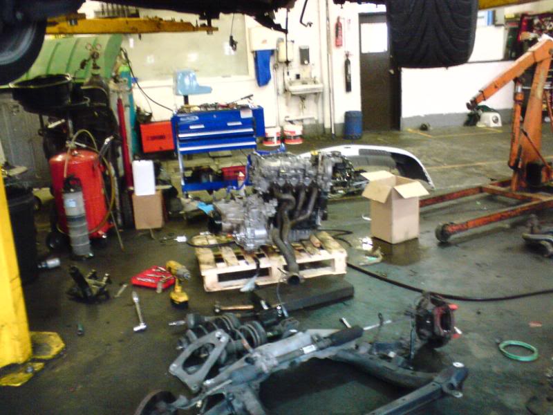

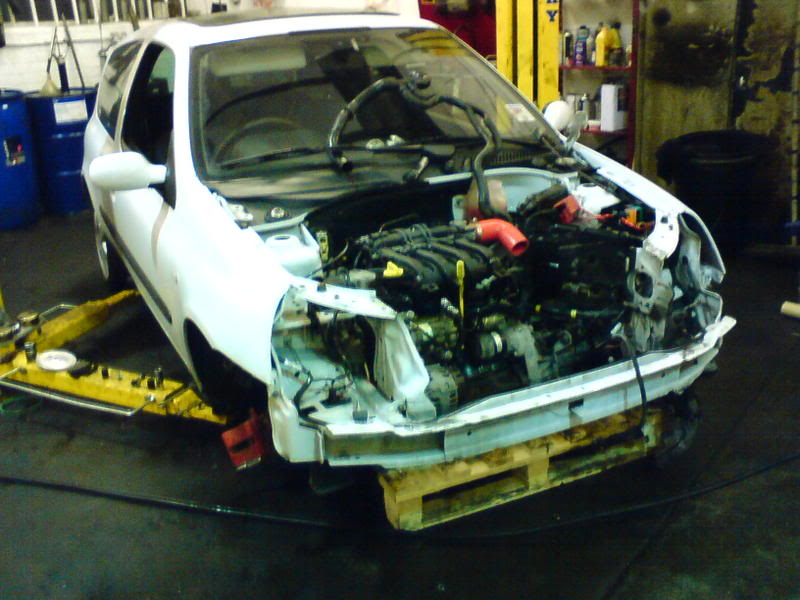

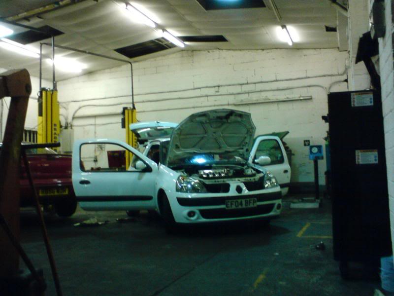

  LY 182

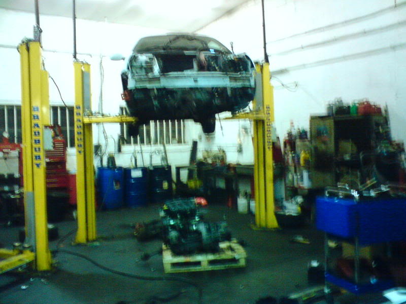

oh dear god.......
got the engine out tonight car came in at 5 i had the engine out ready to go and remove a plenham for b16doe by 6.
found a few niggly problems but im sure i'll get there in the end
got a nice 182 manifold and cat to throw on there,, im back there at 6 tommorow morning so more pics on there way!

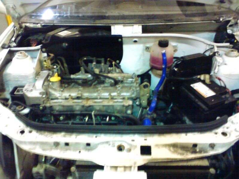

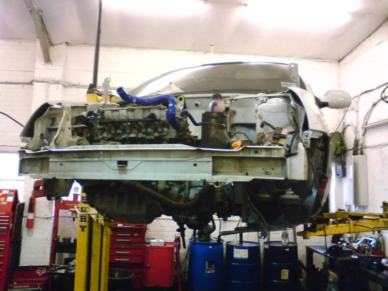

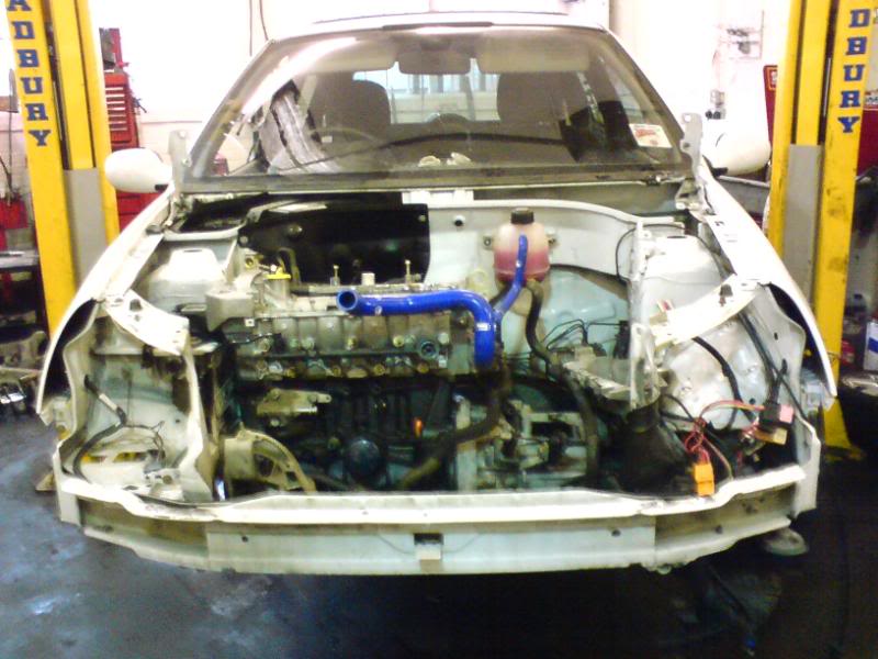

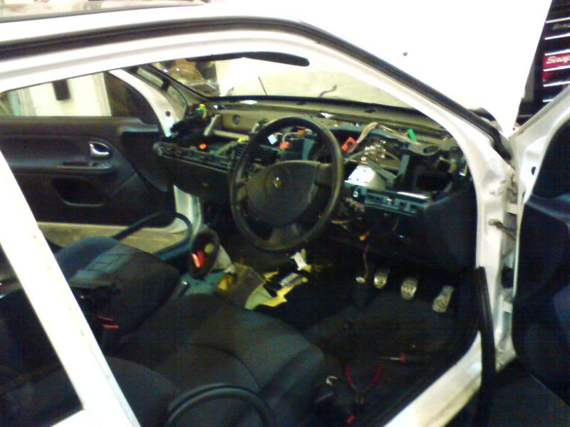

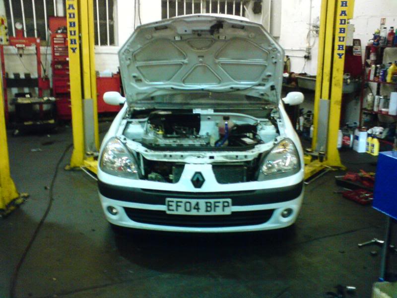

  LY 182
what a nightmare,, made some good progress today though engines in ready for the dash wiring to be done
i knew i had a problem with the 172 engine loom a section was cut off but couldn't sus what it was, now worked out it was for abs and the complete lighting on the front of the car.
so thats taken me alot of time working out what does what and splicing it in to the 1.2 loom,, few pics i took.
for those interested i used complete 1.2 running gear inc 1.2 subframe i modified to fit the lower mount.
all ready to go in
then as if by magic
then all bolted up/plumbed in etc
then started pulling the dash to bits
and how i left it tonight
not bad for a days work i dont reckon :)

ashy, the dash i have a 172 dash loom and uch etc but i have different looms from different cars so theres been alot of messing about cutting and joining wires
luckily all the multiplexed stuff was complete so i was able to sus most of it out with a power probe, i have no diagrams to go on.
same with the lights.. the 2 engine looms i was sent both had the interior connection/vehicle lighting section cut of the them, so today after fitting the dash loom i spent the rest of the day figuring out feeds for all the lights and splicing them in to the 1.2 loom.
so far i've got headlights, mainbeam, sidelights and indicators+ side repeaters working, still got fogs and the headlight levlers to wire up.
ive got the fuel pump priming (after loads of pissing about finding a knackered relay) and it was cranking over but i have a burnt out starter motor (i have a 182 manifold which sits completely over it)
so basically all thats left is get the immobiliser coded, swap the rear loom (plugs are different) then wire up the doors myself (more cutting and joining, again the plugs are different)
my experience so far of doing this conversion is its far from plug and play.. my advice to anyone considering it is unless you can get hold of a full and complete engine, dash, rear and door looms from a cup its not worth doing as there is so much to work out for yourself

  LY 182
nope staying as is.
not much progress couldnt get motivated tonight, ive now got all the front and rear completely wired up.. still need to figure out how the hell im going to wire the doors and plug a few bits and peices in under the seats
then need a new starter new alternator,,
try to start it go through the endless faults and try get it running
then somehow i need to figure how to mate the 182 manifold and cat up to the 172 magnex system
  Mondeo TDCI 130
Good progress there matey!!, Just one query, where did all those million year old cars come from that got in that pic??!!! It looks like the picture was taken 10 years ago!!:clown:
