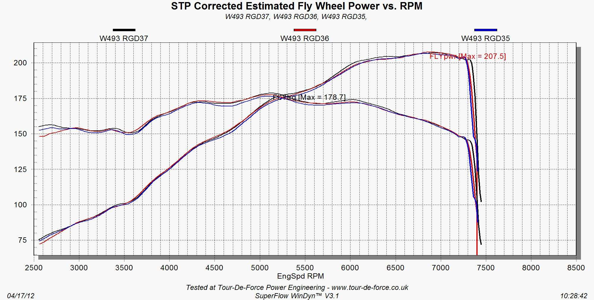

Well I have mapped several 172s on bodies and none of them pulled as well at 2-3K as when I mapped the Rs2 on our phase 2.
Lots of RS2 cars make 150lbft as soon as 3Krpm, and 140 as soon as 2500rpm, where as with bodies you are looking at nearer 4K instead for 150lbft of torque, which in fifth gear is gettin on for 90 odd miles an hour before it really starts to want to pull.
With bodies you'll match the standard inlet at low rpm, but you wont match what an RS2 can do down there IME
Plus TBH bodies are a waste without cams really as you'll only gain a few more BHP than you do with an RS2 for all that extra hassle, so most bodies cars realistically will have cams as well which exagerates the lack of bottom end torque.
Does depend a bit on bodies length of course, if you are prepared to lose the slam panel and put it on bonnet pins (not ideal on a road car IMHO) then you can get closer, but even then Ive yet to see a bodies car that can compete at low rpm with a good RS2 one for the same spec engine.

I cant comment on the exact values on that graph specifically as im not familiar with TDF's rollers TBH, that doesnt marry up with what Ive seen from cars on rollers I am familiar with though TBH so I wonder if perhaps there is a bit of a difference in readings, but even on that graph its still making nowhere near its peak torque figure at the bottom end, its very much only from 4K onwards it really gets going torque wise.
IIRC thats bigash's graph? So on long bodies and lost slam panel etc, which like I mentioned does mean more bottom end torque but more expensive and less practical than most of the bodies setups which people put on roadcar 172 as opposed to trackday ones, so it was more the "normal" short inlet length bodies setups I was referring to with the bottom end issues.

That's bodies and cams Mike, bodies will make less.

That's my graph from 2 months ago, on 90mm trumpets and 428 cat cams. Can go bigger lol.
Ah it looks very similar to ash's from what I recall.
Certainly a nice result, but obviously we're comparing two different spec engines on different rollers so not really a very direct comparison.
