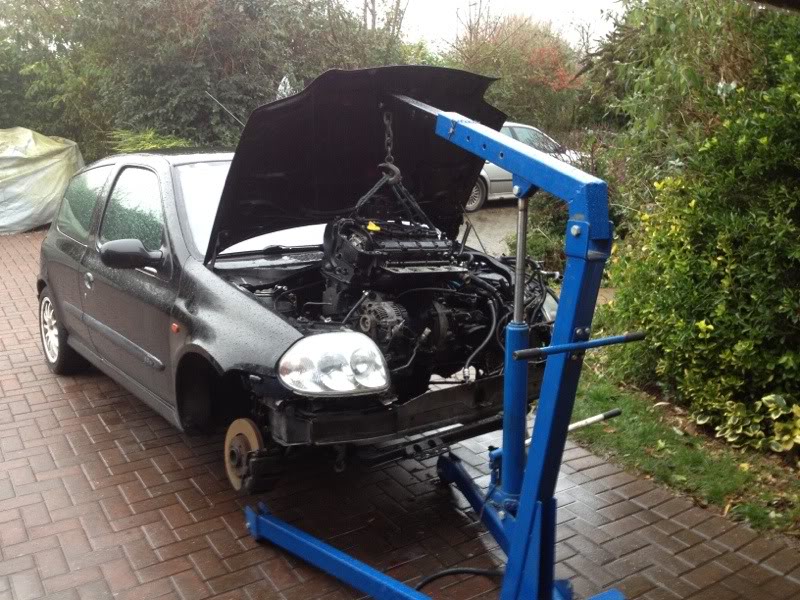

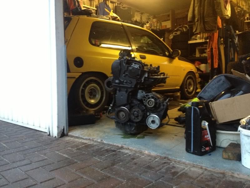

Going to be January before I get a chance to actually rebuild it but I thought today while I had a spare few hours and it wasn't raining much I'd quickly whip the old engine and box out so I've got the block to hand for machining.

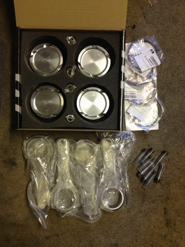

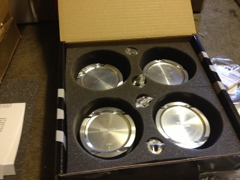

first of the rebuild parts turned up this week too:

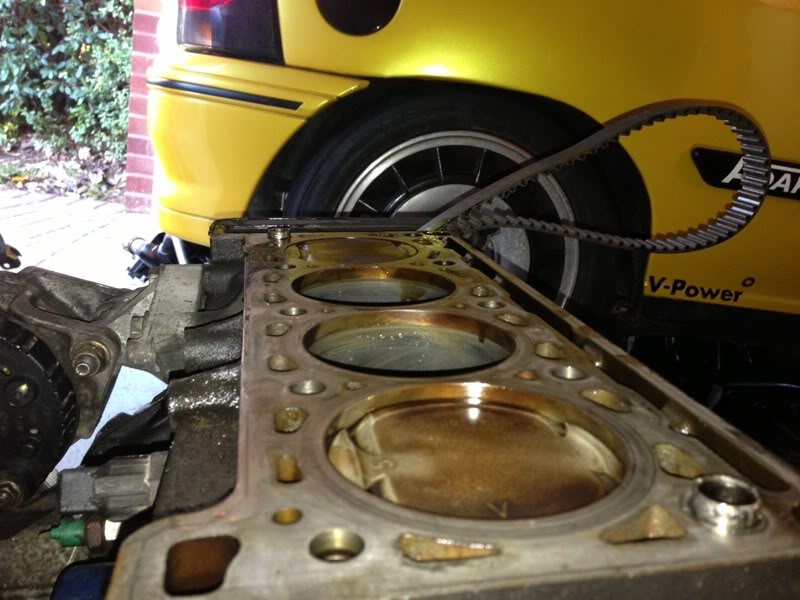

I'm not looking to increase power really with the rebuild, just want a bottom end I know I can rev a bit more if I need to coming out of a bend and wanted some fresh new bores as the block was very worn even before it was turbo'd originally.
The intercooler/turbo/manifold combination I'm using is only really suited to around 280bhp or so, but that's ideal for on track anyway, more than that in a fwd car is of limited use really and I like how it drives anyway so no need to change the spec.
Will add some supertech valves in the interests of reliability though.

Look forward to reading up on this Chip. What rods have you went for?
They are just the generic steel ones that people like pec and ed sell mate. Nothing mega fancy as they don't need to be at this level so bit silly if I spend arrows money on it. Same ones I used in porkies throttle bodies engine and that seems to take a beating nicely :)

Working in the rain ftw lol
I just caught the tail end of the rain for the last hour or so luckily and it wasnt too heavy, sadly the nova is already up on stands in the workshop along with my mates corrado on a spit, so I'm stuck with the driveway at the moment or the garage and the garage hasnt really got enough room for moving an engine on a crane about etc.

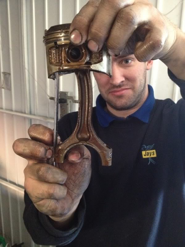

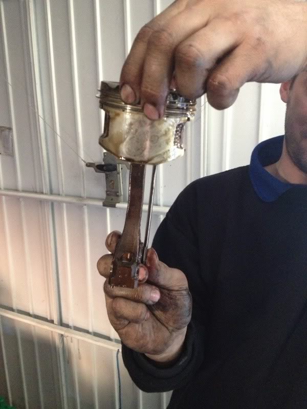

Crazy thing is, it was still going really well.
Ive only used it a couple of times since silverstone, so realistically it was probably bent by then, so that video I posted of it on here of it flying past a whole load of stuff on track, was almost certainly with the Rod as bent as in these pics, lol

Would've been interesting to see much longer it went for before completely lost it.

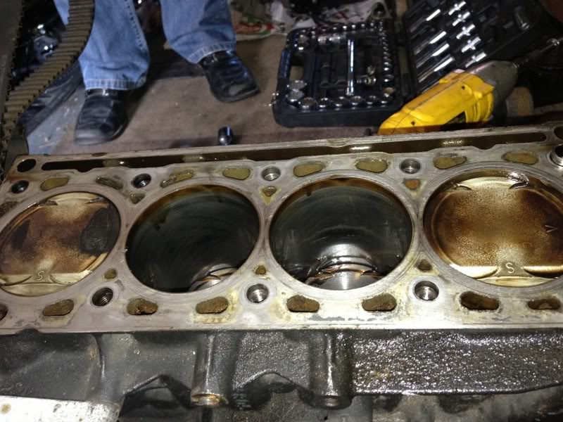

Ordered up all the belts/bearings/gaskets/pumps etc today from that Adam guy who Fred is always recommending to people, what an absolute star, totally knocks spots of every other renault parts person added together that I have ever dealt with TBH, he carries LOADS of RS specific stock, and actually totally understands all the little bits and what they do so when you ask for something he knows what it is etc.
Have provisionally booked the block into a mates place for boring next week, so as long as I get a bit of time this weekend to finish stripping it I can hopefully get it over to him monday night and get it back bored on wednesday night, then I can spend a bit of time on it over xmas hopefully, although as always sadly I have loads of other (paid and hence more important, lol) work that needs to take priority.
I've decided to go for a 172 head gasket which will put me at about 9.5:1 based on the quick measurements I took of the piston and head chamber volumes with a syringe (sadly my beaurette got broken the day before and I didnt have chance to grab so I couldnt measure it exactly, but TBH I only need to know the ballpark not the exact figure anyway for this)
Based on how well it was working before at very slightly more CR than that Im keen to keep it quite high so it still works well at high rpm.
