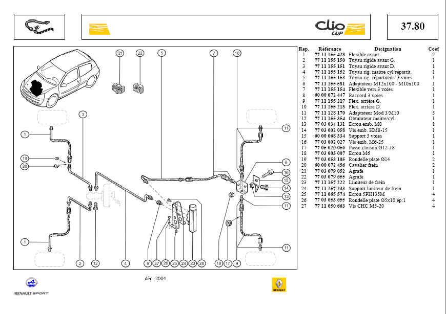

a bit of both. Figures are lower than I would have expected, also under braking it pulls left although when I stuck it on the brake tester there was an imbalance across the front which I am in the process of resolving.
scotiamr2t
  Mazda 2, Ph1 172
@bloke the brakes are plumbed in as per this diagram

@JamesBryan helpful yes as it tells me that they read lower than a 182. What do your fronts do?
