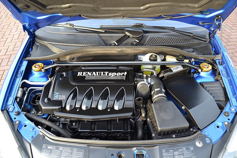

However, last year within the month of doing my coolant it turned a horrible orange/rusty colour instead of staying green, I also bought a new coolant bottle at the time.
Am i doing something wrong? As this time round i want it to stay green! Look all pretty and nice [emoji4]
Photo attached is robbed off a forum member off here, don't know who though. I want my coolant to look like this! Yes, i did buy the Renault Type D coolant.
Any help/advice would be appreciated!

Mine has done the same, the bottom half of the tank is a different colour - took more than a month to change though mind. From what I understand it should change colour over time as it can be used as an indicator of when the coolant is ready for a change (only what I have been told in the past though, not gospel). Its never going to stay clean/bright green with it going through heat cycles and the steel engine block.
  BG Clio 182
I'm thinking it's more to do with all the s**t in the radiator and everywhere else. I think you'd be better doing a few full flushes through to get rid of all the crap first

It needs flushing. It took 3 fills and empties last time I did it. Basically fill and drain until the water comes out clean, then fill it with the correct coolant.
You could flush it through with a hosepipe but I'm not convinced that would get it all.
