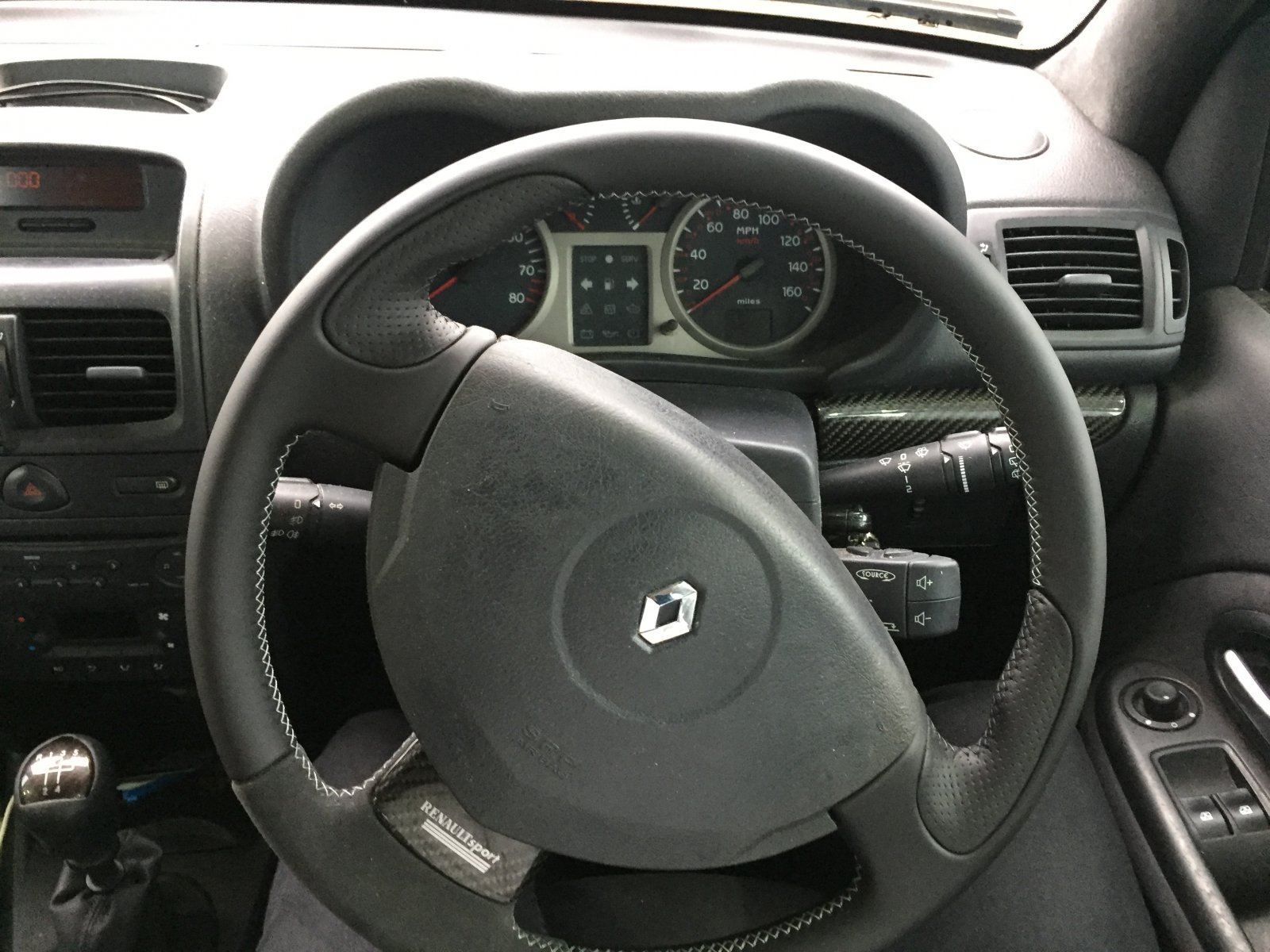

Managed to get the bits fitted. Had massive difficulty fitting the wheel for some reason. Is it suppose to be incredibly difficult to get it off/back on the splines? Oh, and after all that, it isnt straight. Cba to do it again yet.

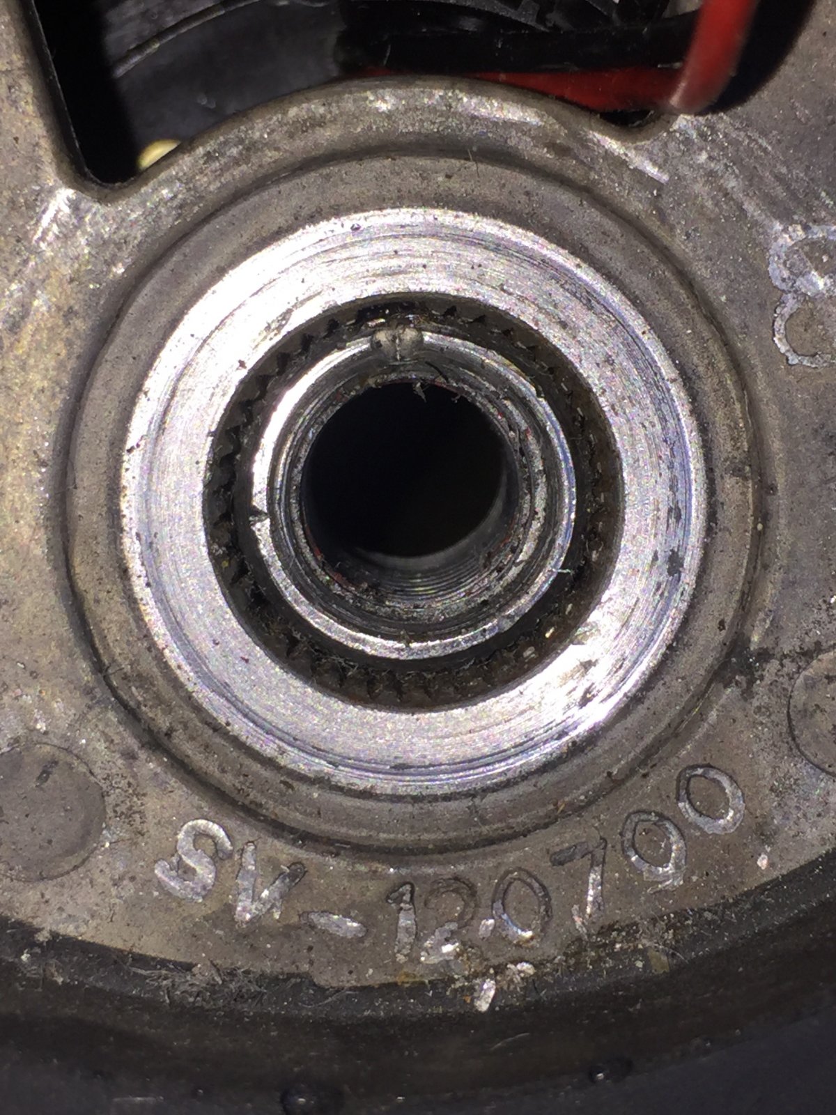

How it should be..

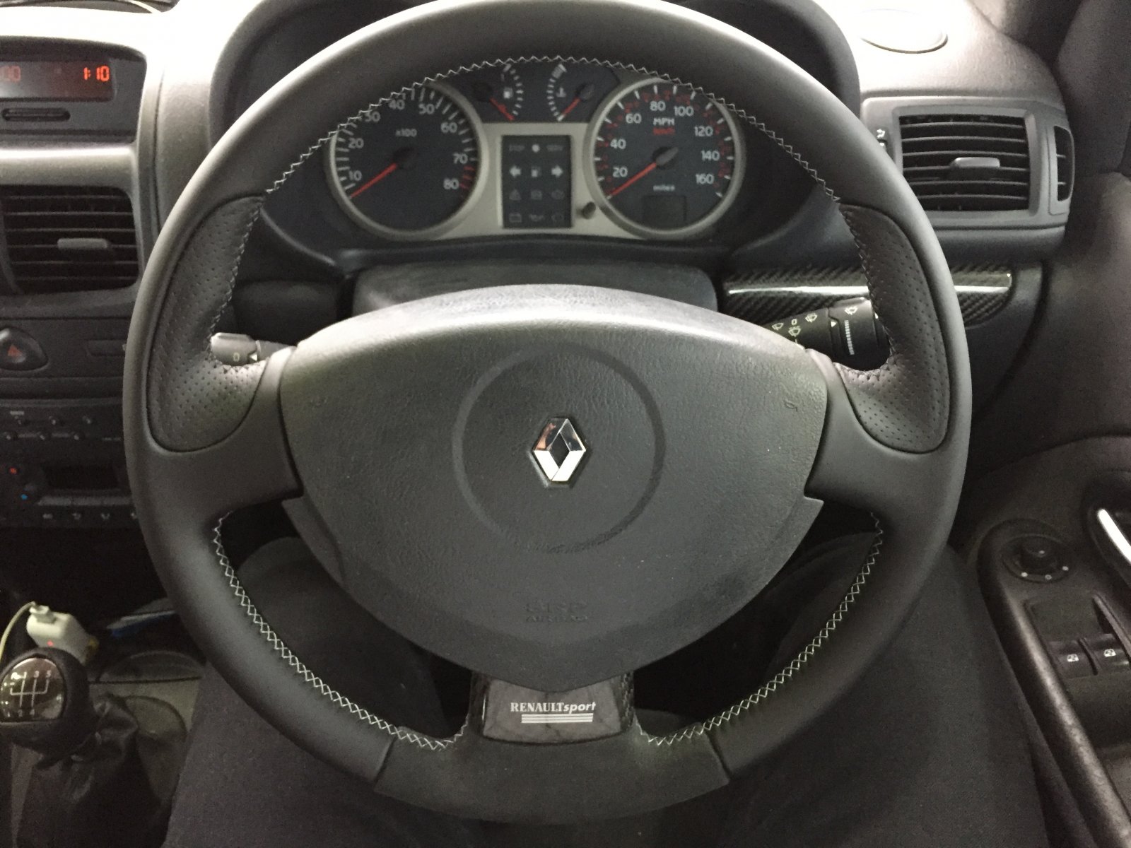

'Straight..'

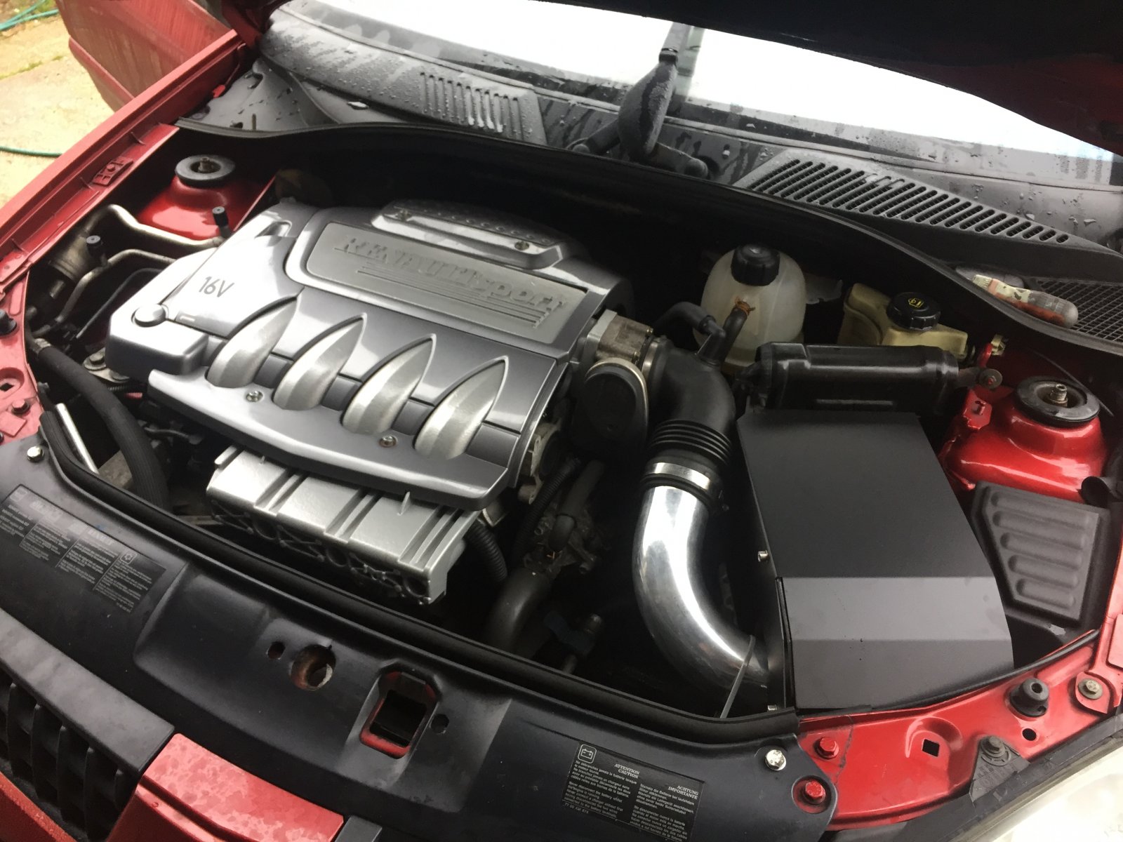

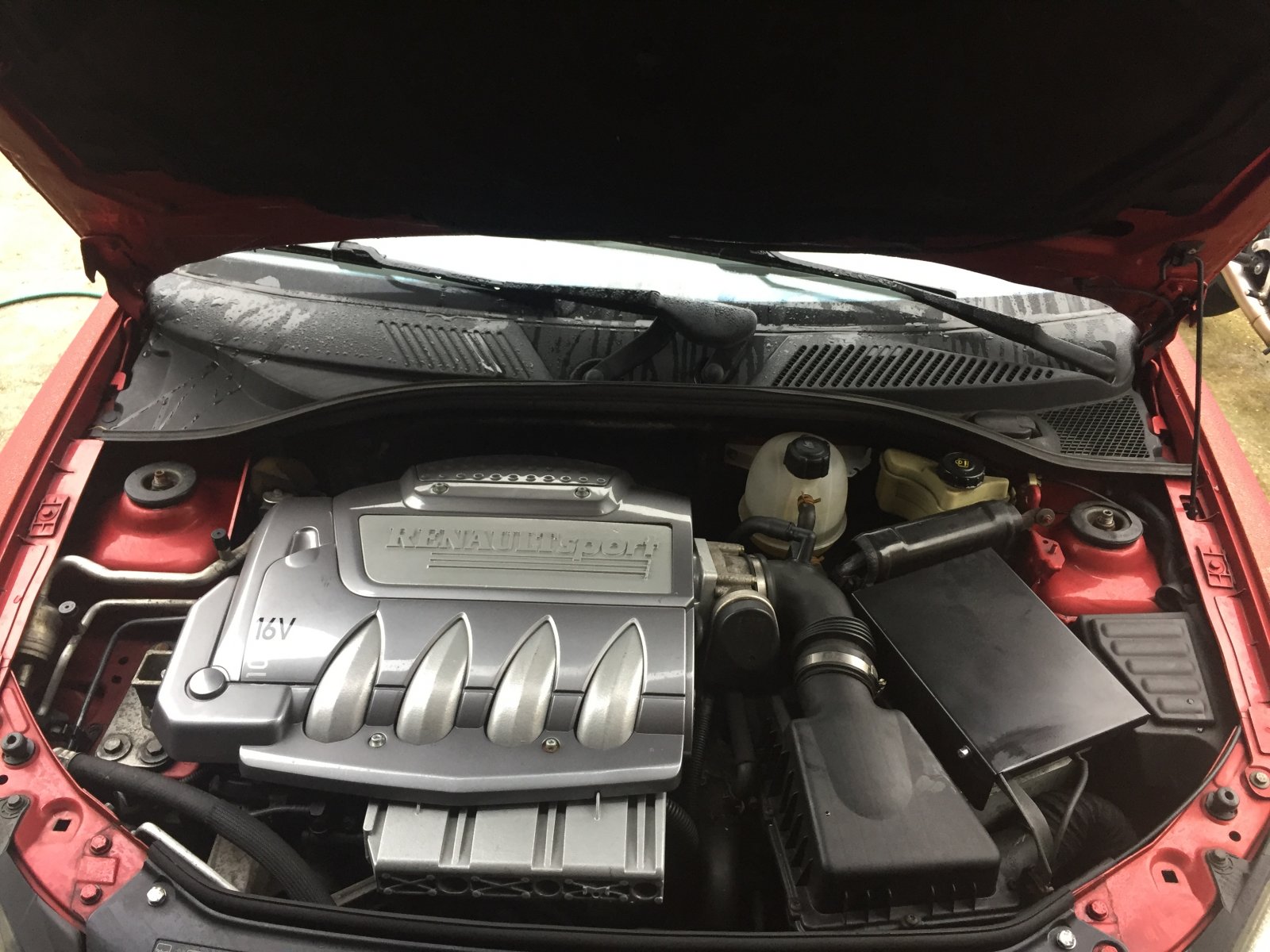

My bay, from..

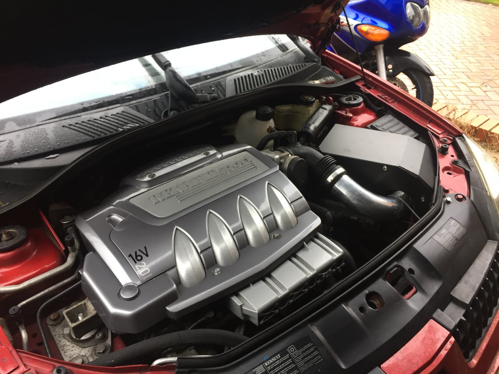

To.. (I know coolant is a bit low :( )

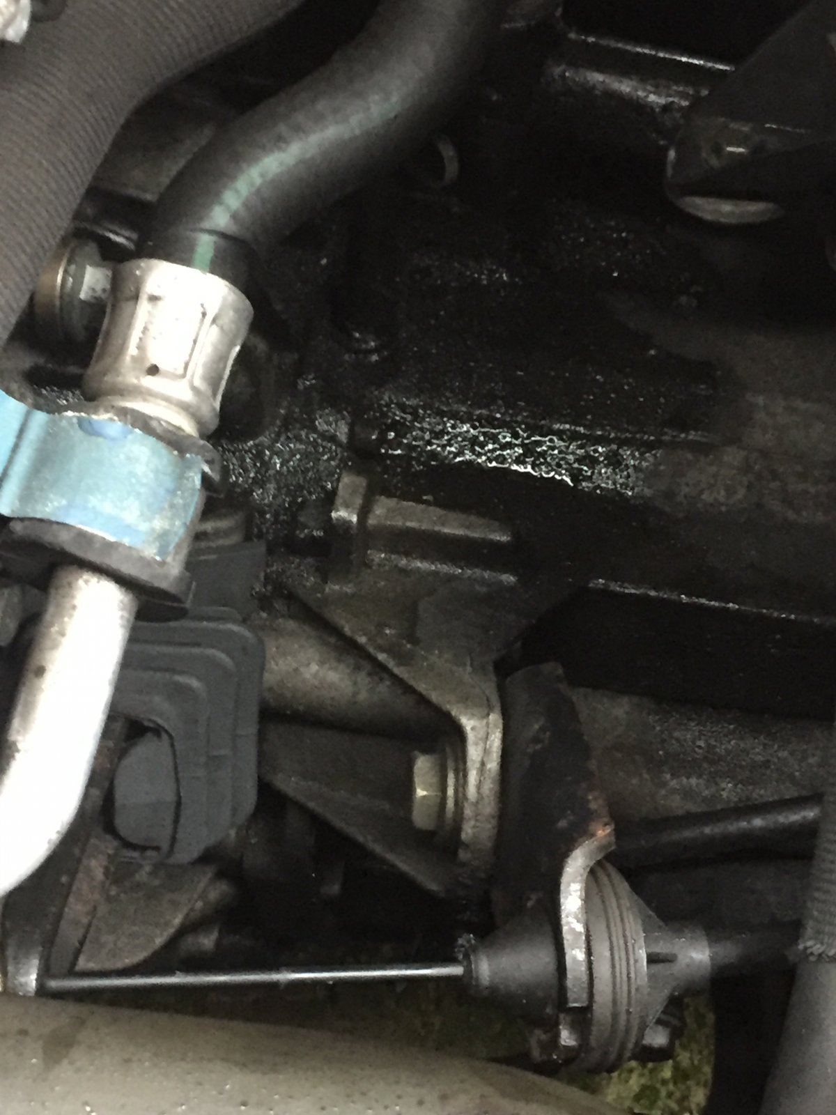

However, removing the airbox uncovered this oil leak. Any ideas?

I know it'll be early days but found any advantages from changing the filter from the panel filter to fattys?
Thinking about doing the same with mine and getting one of the battery covers in the 2nd GB.
leedsboy
  Bean 182 + E70 X5
Fatty all day long
I've got a K&N panel filter at the moment in the standard air box as it was in there when I bought the car. Does it actually make that much difference to the sound? Understand there's not many gains to be made in terms of performance.
imprezaworks
  Mk5 Golf GTI :)
Standard filter noise is zero. You would notice the difference immediately. Suprised you haven't got that set up tbh. The noise is great :)
leedsboy
  Bean 182 + E70 X5
Standard filter noise is zero. You would notice the difference immediately. Suprised you haven't got that set up tbh. The noise is great :smile:
@leeds2592 sounds standard low down the revs but as soon as you get above 3.5k revs or so it sounds brilliant, definitely worth the £30 or so.

Are you sure your wheels are straight? If you look ill guarantee that your wheels are slightly facing right. You cant put the wheel on wrong.
  dan's cast offs.
epic fail on the wheel...have fun getting it back off:laughing::laughing::laughing::laughing::laughing::laughing:
i did one that had been put on cockeyed, nightmare to get it back off. if you look there are three thick splines to locate the wheel straight. don't bother disconnecting the battery to unplug the airbag.

I struggled to get it off in the first place, had to hit a piece of wood behind the wheel for bloody ages. Was extremely hard getting it on too. Cant wait to remove it...
How come not disconnecting the airbag? Also.. regarding the 3splines, is it obvious how they locate it?

three splines are easy to spot when you look for them. wheel should come loose with a swift bang to each side so could of been on cockeyed to begin with.

Isn't that exactly where the gearbox refill/overflow is? So could just be oil from when it was filled? Mine is the same there.

Can't fathom how you have managed to end up with it like that though, as the steering wheel splines have a slight groove at 12 'o' clock so it can only go on one way. Unless by smashing it on you have managed to somehow do without the groove 😂 I recently took my Snappy wheel off and refitted it same day (wrong boss arrived for aftermarket wheel but only noticed after taking wheel off) and it only required a bit of forceful wiggling to get it off/back on!

Haha ive not a clue mate. It was seriously difficult to get off and put back on, so im wondering if it had been put on wrong in the past. I'll try again at the weekend mate and ill give you a message if I somehow fail again!!

Yep that is how it should be mate, that bigger centre spline at the top is the groove I was talking about which can only go on one way.
Glad you got it sorted.
