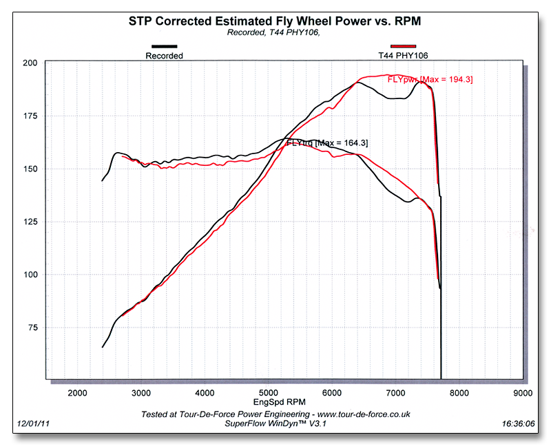

I run jenvey itb's with omex - 2nd hand kit, all in cost me about £2300 including mapping.
Went from around 169 standard to 194bhp - big jump
People on here who have fitted just cams and a remap have also seen 190ish bhp - for about £1500

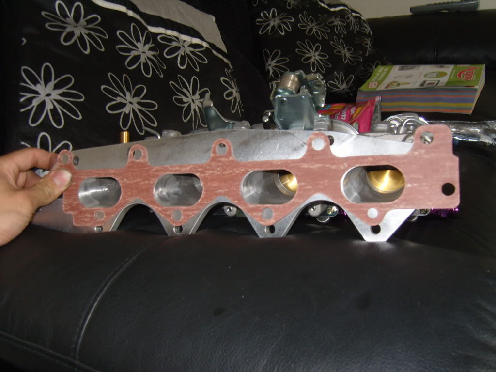

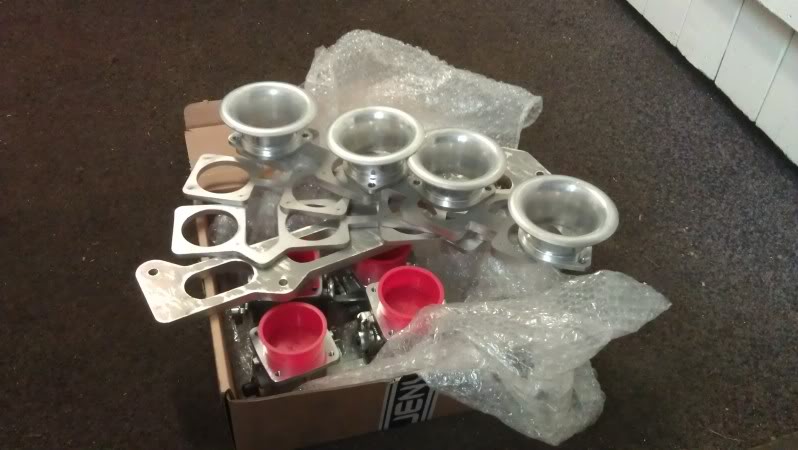

Thinking outside the box a little though, have you seen the way that Danlp6 did OBX honda bodies onto his ph1 years ago?
450 quid new delivered from the states for this:
And this is how well it matches the inlet so no big deal to modify to fit:
If you get a good deal on the cams and ECU and use the OBX bodies, I actually think that you could manage bodies and cams on your car for 2K using all new parts let alone secondhand if you are capable of doing all the work yourself.

Lol, other than the mapping which isnt massively expensive anyway, there isnt anything that you cant do as an enthusiast with a bit of time and effort, changing cams IS a ballache im not going to lie to you, but its certainly not beyond the capabilities of anyone moderately intelligent who takes their time.

That's pretty cool - you would need the skill involved to modify inlets etc.. though
You only need to drill some holes and grind a couple of bits off, its not like it needs portmatching as the fit is so good to begin with.
More of an issue if its a road car is the fact you need a hole in your bonnet to clear a filter though.
Not saying its for everyone, but just trying to point out there are other ways to skin a cat thats all.
