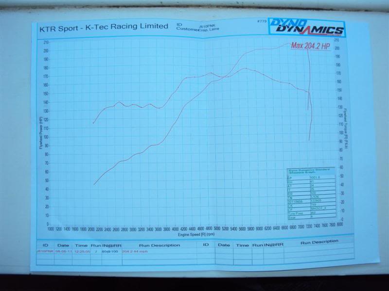

Heres my old graph, co-incdently 204bhp peak like the 421'd car lleywelyn drove. Couldnt be any further from flat if it tried. Wonder if the car wasnt running right?
