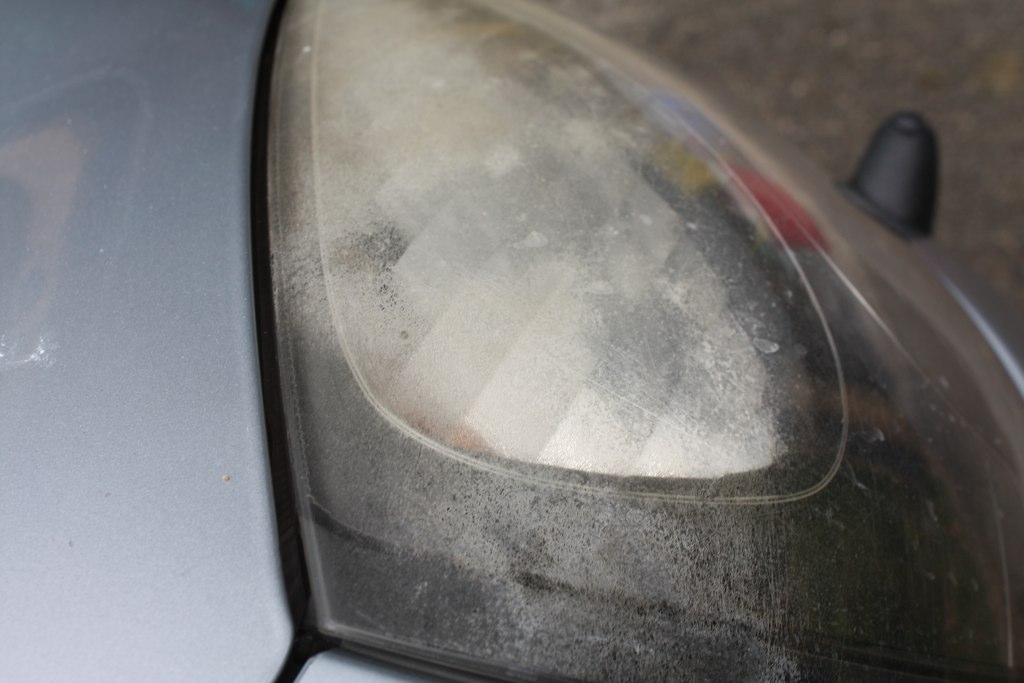

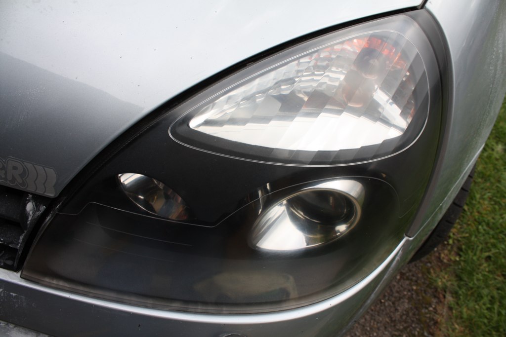

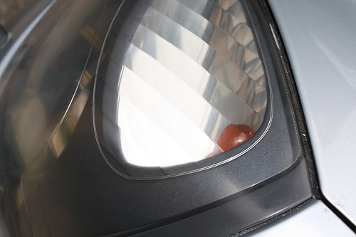

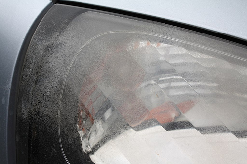

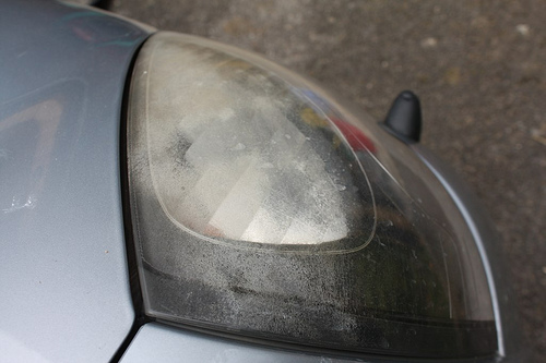

Heres mine I did using Megs heavy duty kit I picked up in the States last year.
Before:
Other side was worse with lots of pitting:
The Kit:
Whilst still wet
Dry after 1st abrasive (1000grit)
Dry after 2nd abrasive (3000grit)
After Polish with PlastX and UV protectant
1000 grit, pitting still there but I didnt want to spend hours!
3000 grit
Polish
Close up of pitting.
Overall I was happy with the kit (only cost about £15) took less than an hour with 15 mins spent ensuring i had masked well!
There is plenty left in the kits to do lots more headlights or redo these if I have the patience to really clean up the pitting.
