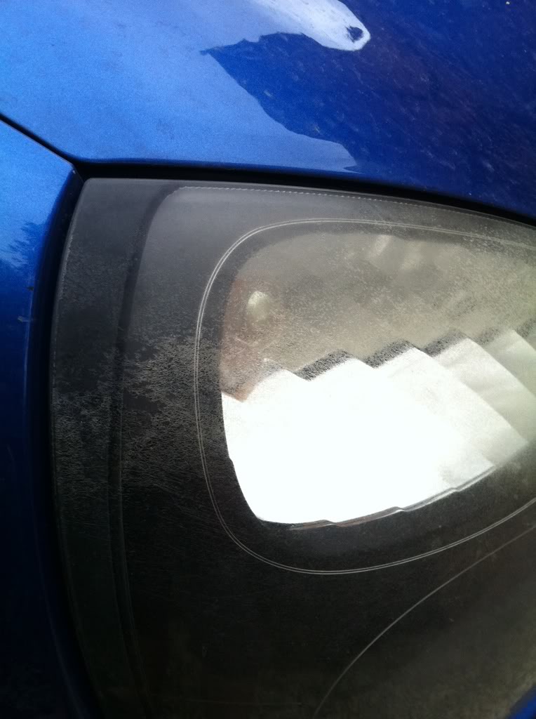

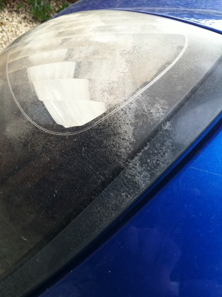

Here are mine from today.
Before
After
Started with 1200, 1500 then 2000 wet dry followed by megs on a pad attached to a drill worked much better than expected to be fair.
Thanks cs for the guide parts cost £25 and took less than 2 hours.

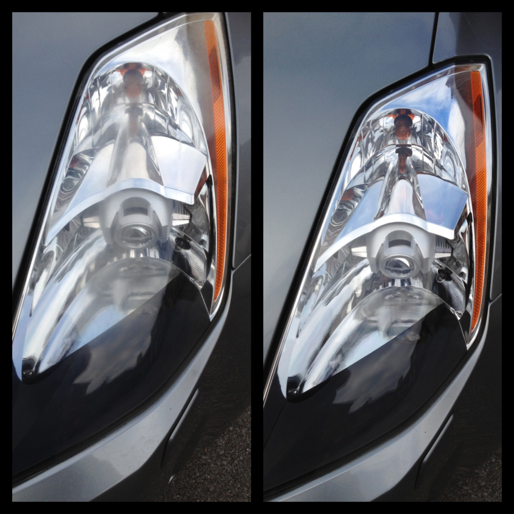

I did my headlights yesterday. I didn't wet and dry, I just used Meg Metal Polish by hand.
I'm massively happy with the result, the fine scratches and yellow tint have been removed.

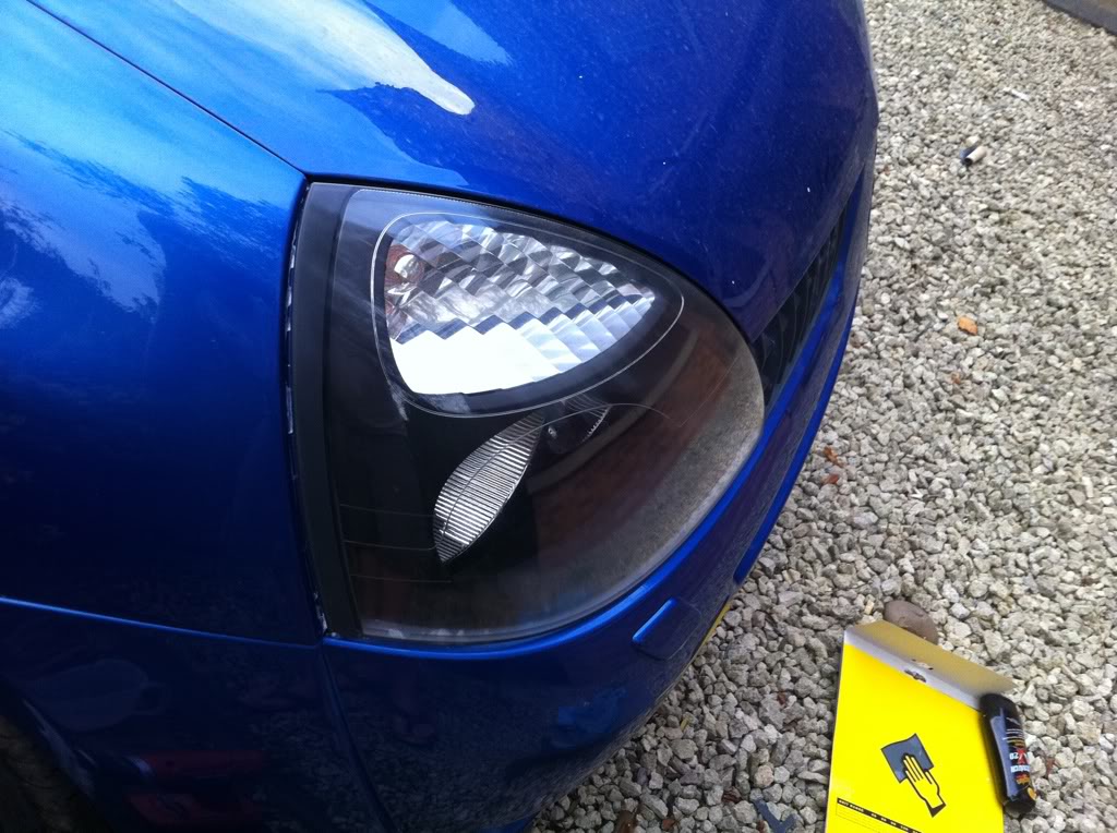

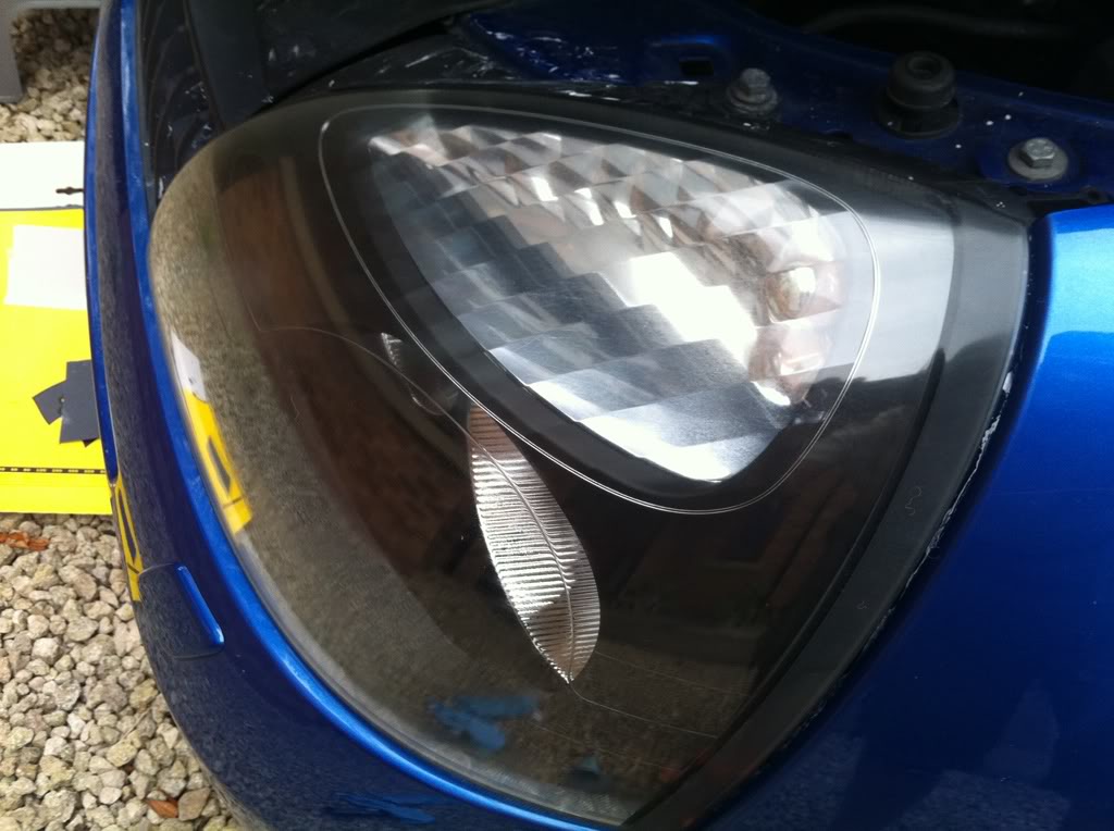

I was bored in the house earlier so went outside to attack one of the headlights.
Didnt do a before of the one I started on, as both headlights were in identical condition.
Started like this
Ended up like this.
Soaked wet and dry paper for a while.
I only sanded over the top two inches of the headlight, just in case I knackered up the whole of the part in front of the main bulbs, as they are actually in good condition there.
Its just the crazing at the top which looks bad.
Started with 2000 grit, spraying regularly and checking heat (none at all by hand)
Went up to the finer 3000 grit to get the sanding marks out that I'd just put in.
Polished up with Menz Intensive Polish, a coat of Autoglym SRP afterwards. (polished by hand with yellow foam light cutting pad)
There are still some marks there where I've polished up to, but this will be sorted out with the PC/rotary tomorrow/next weekend.
I have to admit, I'm happy with the level of clarity and gloss I've achieved, as a lot I have seen end up looking cloudy.
These will be sealed with a few coats of Carlack68 after a UV stable sealant.
