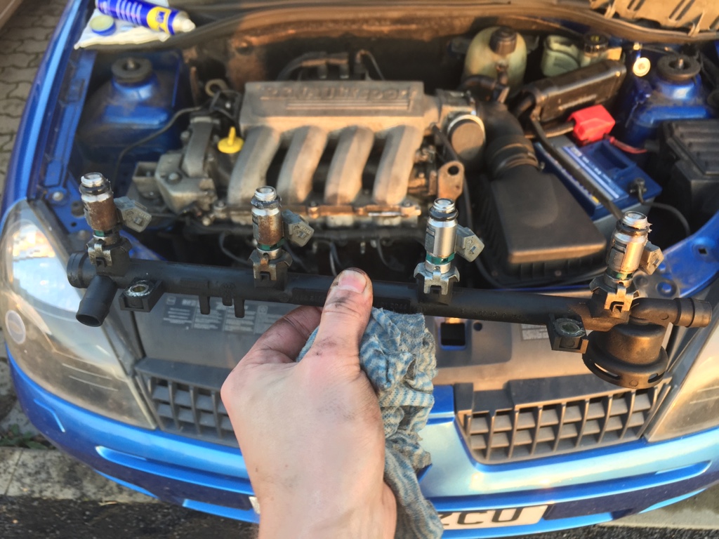

Ah awesome! Well i have very limited tools out here in Berlin but from what i've read its a couple 13mm bolts for the guard, 2x 10mm for the rail and thats it? Did you do anything else? Disconnect battery and fuel pump? I was going to get one new from Renparts for £32.50 on eBay?
  Westfield, 182, 200
10mm nuts on mine for cover and fuel rail.
You have to unclip the connection on the fuel rail, and the electrical connection on the injectors, pull carefully and wiggle the rail, only the o rings are holding the injectors in!
Switch off the ignition and you'll be fine.
I only went to ecp as I needed the part urgently!
  SchwepTek™
When you say unclip connection on fuel rail, you mean fuel connection? Is that simple and did fuel spray everywhere? lol
Just checked ECP as fairly desperate too, looks like they've gone up to £40! haha
  Westfield, 182, 200
Ecp was an extra 5% off today!
Yes unclip fuel connector, wrap some tissue around it as some fuel will spill out.
Mine didn't have much pressure even though I drove it in my garage.
  SchwepTek™
Brilliant. Cheers man. Have ordered from RenParts as I'm not back in the UK for a week anyway. Will be in touch! ;)
  SchwepTek™

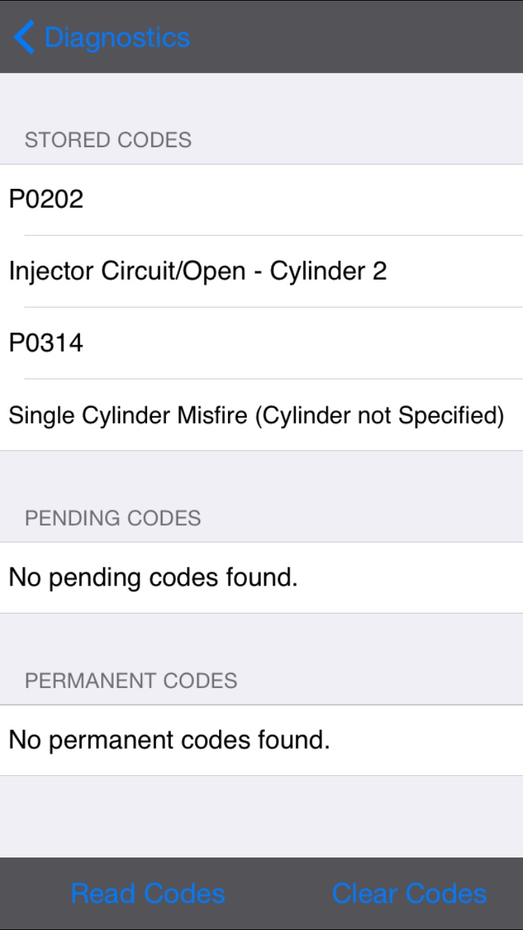

So finally got round to it today. Cup had 1 10mm and 1 13mm nut for the rail guard but otherwise was dam straightforward. Even able to clear the fault light with Dash Command on my iPhone. :D
