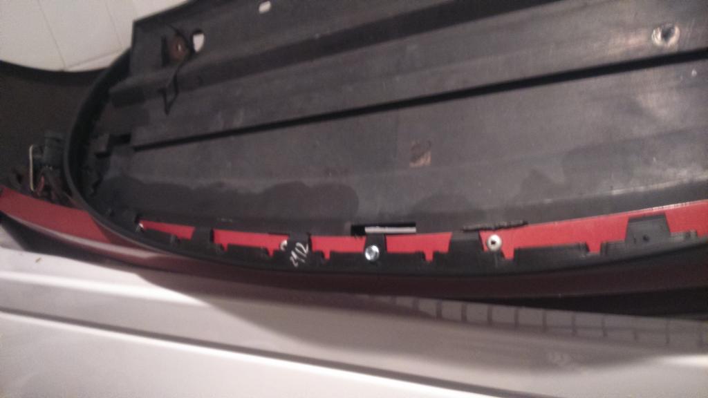

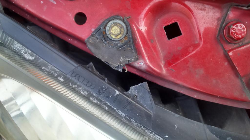

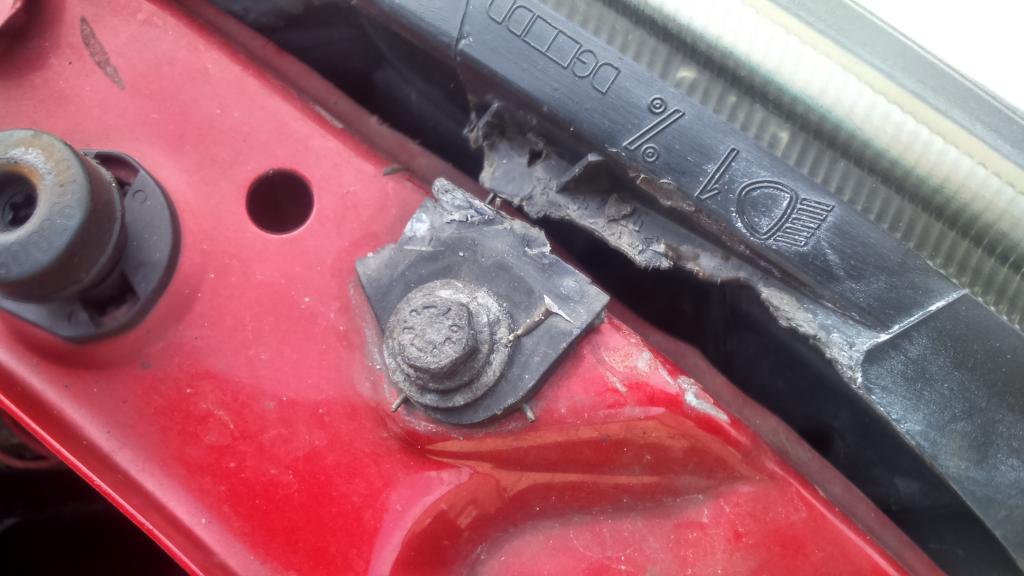

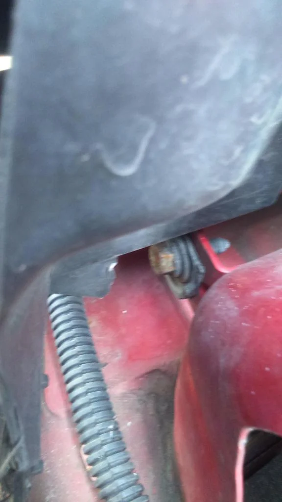

So the first task was to sort this mess:
No real interesting method used, I ended up cleaning up the surfaces of old silicone (why people try to use silicone is beyond me) and applying Gorilla epoxy to bond each clip back together. Extremely strong stuff so lets see hoe it stand up!

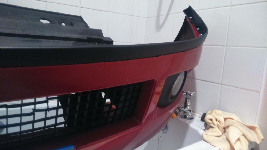

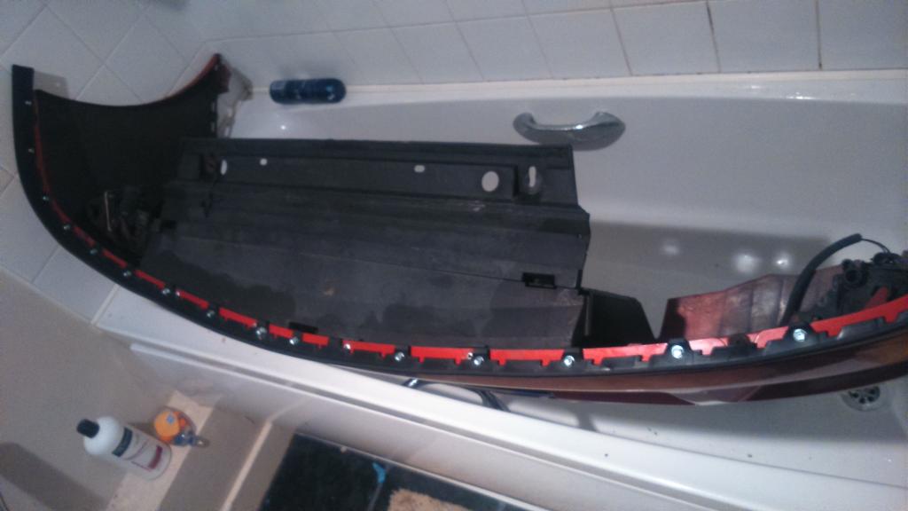

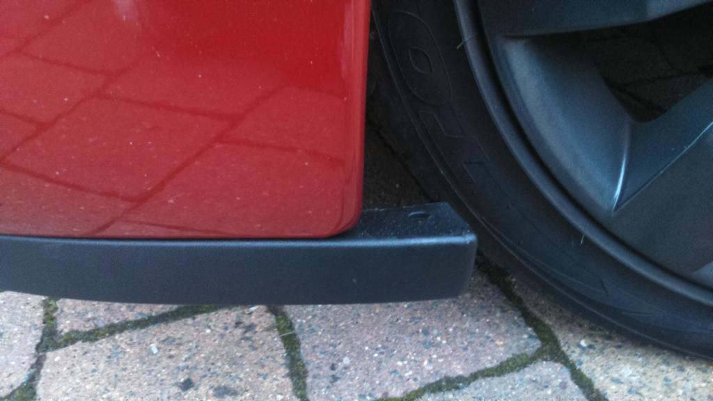

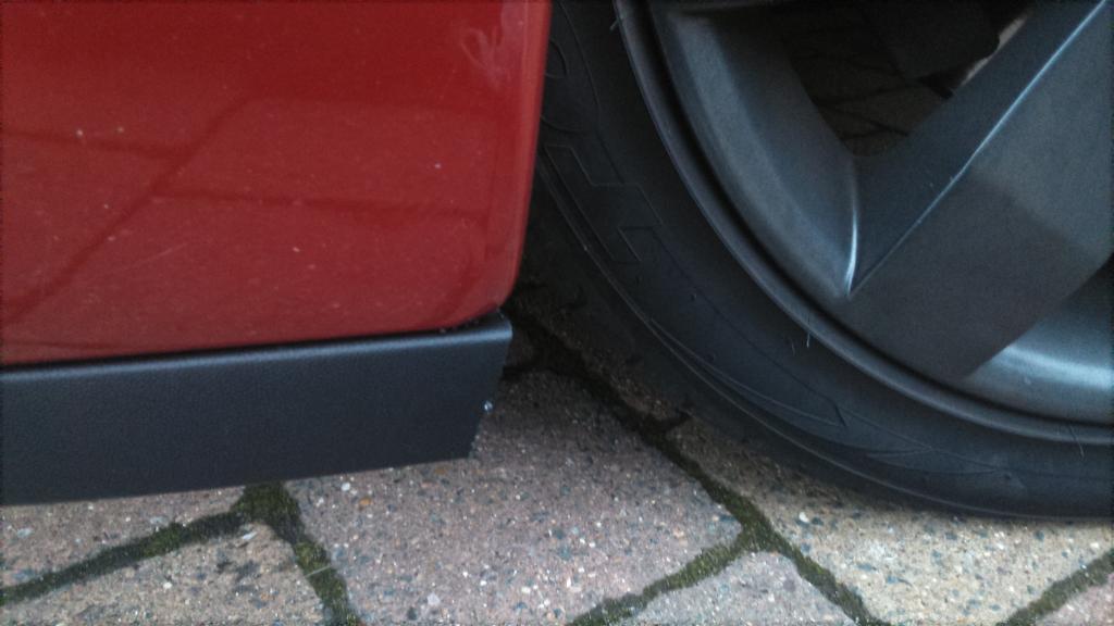

Next up was fitting the splitter. With my drill and self tappers I set to work:
I worked my way up one side, pulling the splitter into line and screwing on every tab to ensure no movement or bumps once fitted
Took me a while but got there in the end:
Managed to get it pretty neat!

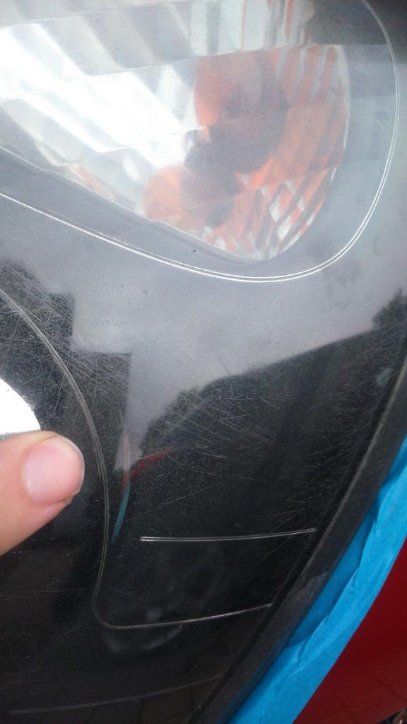

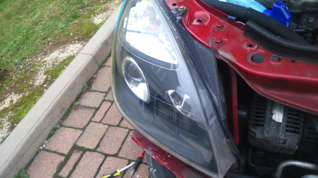

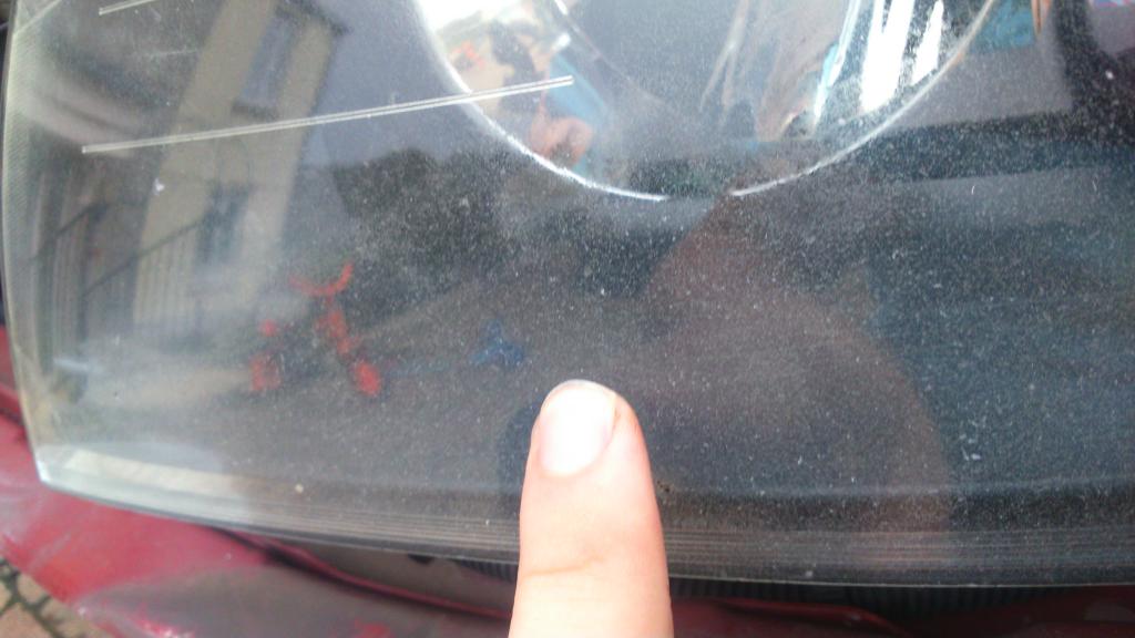

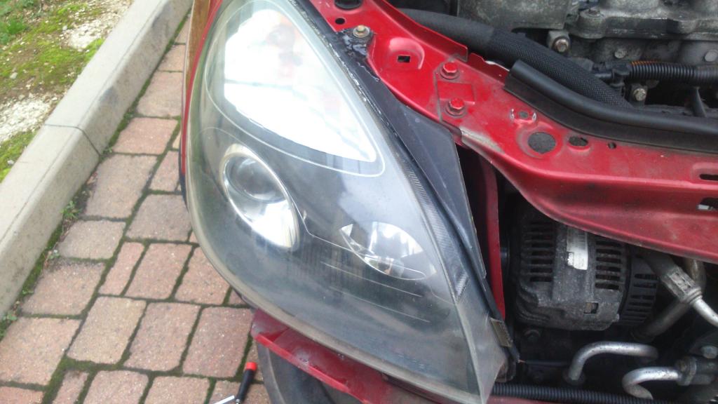

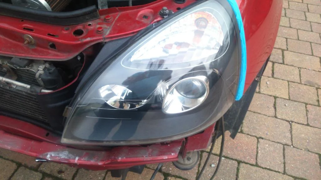

I then decided to tackle the headlights:

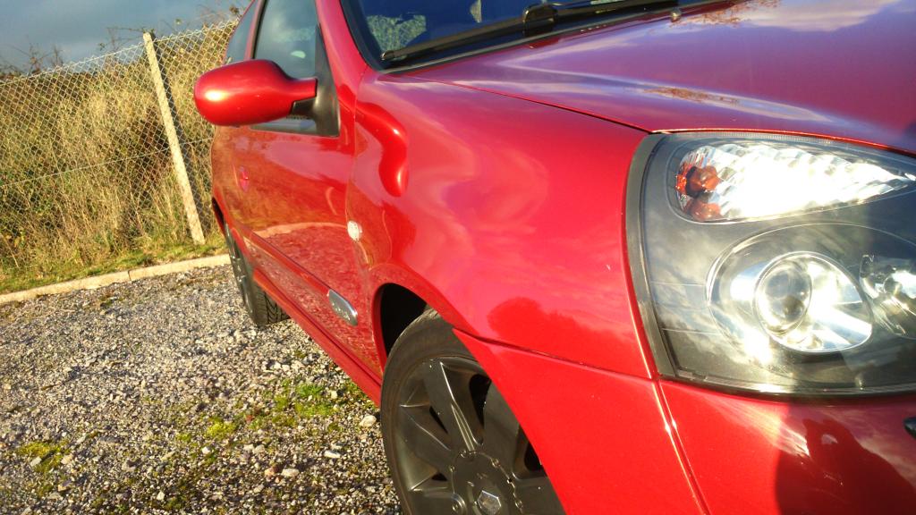

As you can see the factory coating was well and truly shot. I wet sanded with 2000grit followed by 2500grit and then used Meguiars D300 on a microfibre spot pad to remove the sanding marks to leave this:
Before:
After:

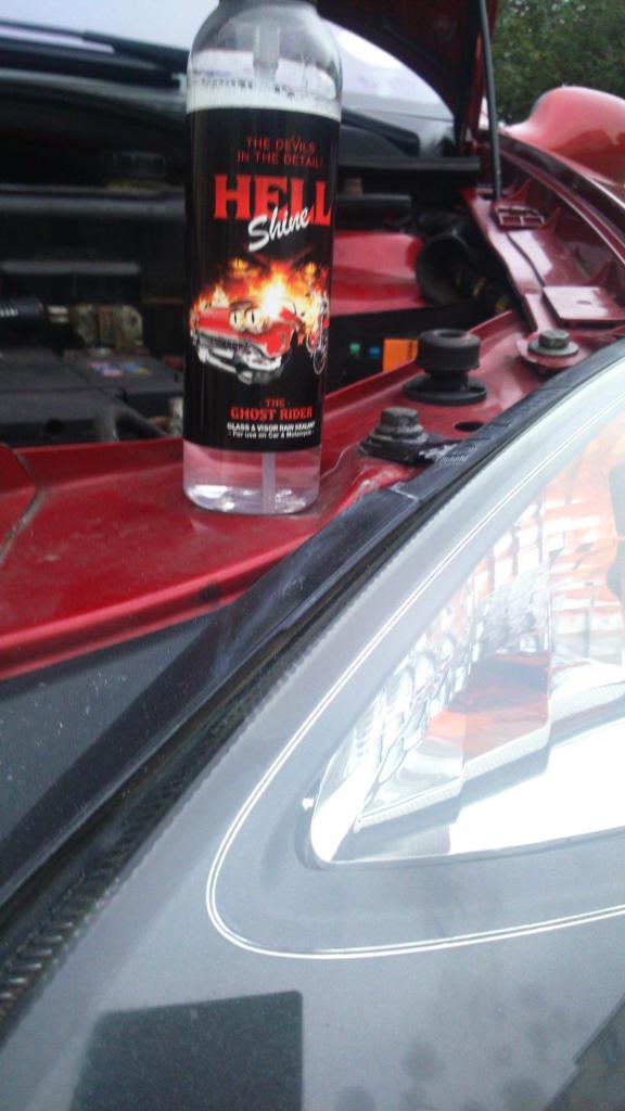

Not 100% but a marked improvement. Annoying as there's watermark type stains on the inside of the lenses. I then used Autobrite Ghost Rider to seal them up:
(I then whipped round the windows with the ghost rider too, sealed the windows ready for winter :) )

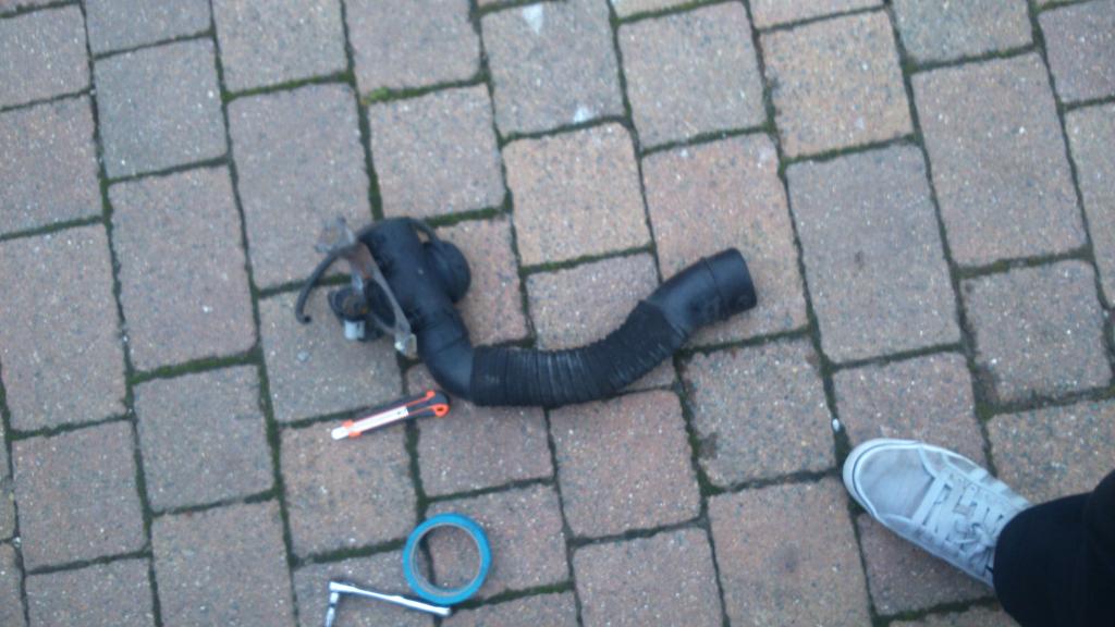

Whilst the bumper was off I opted to whip this little bugger out:
Blanked off the vacuum feed and taped up the plug and tucked them away out of sight. I also tucked away various other wires and the headlight washer hoses which had just been left hanging behind the bumper, I also blanked them off as there was a nice puddle of screenwash in the bumper too :mad:

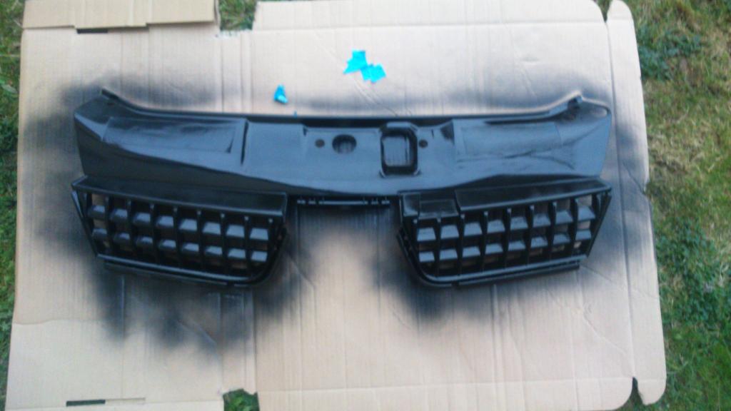

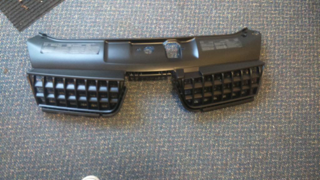

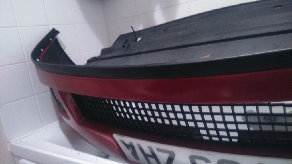

I then started on the grill. Prepped with Autofinesse citrus power and a good scrub, followed by an IPA wipedown. First coat of satin:

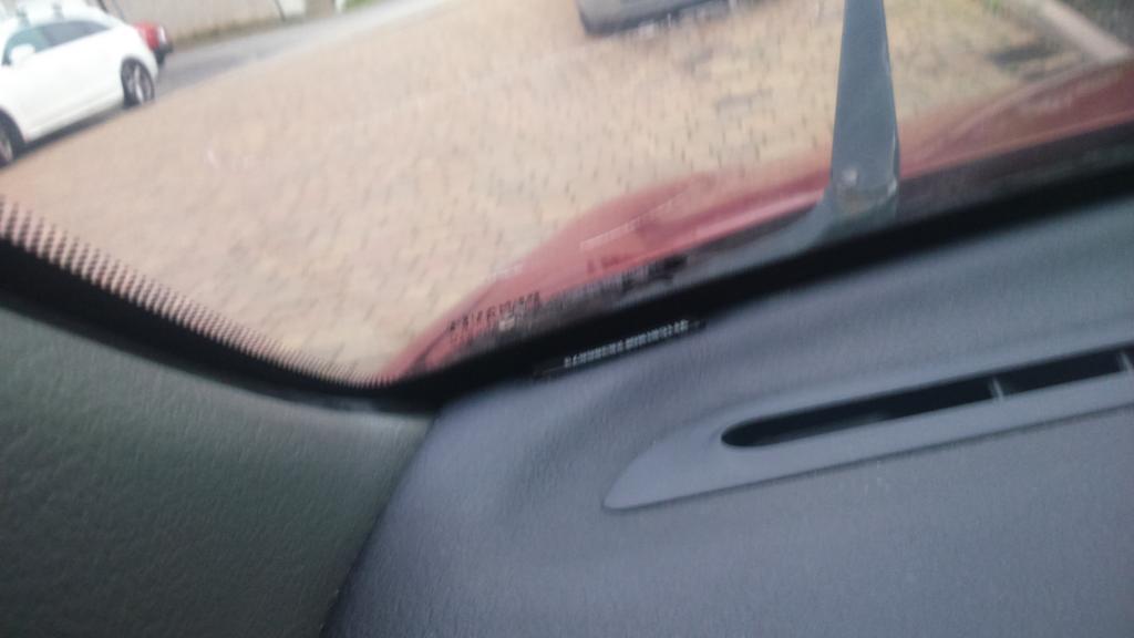

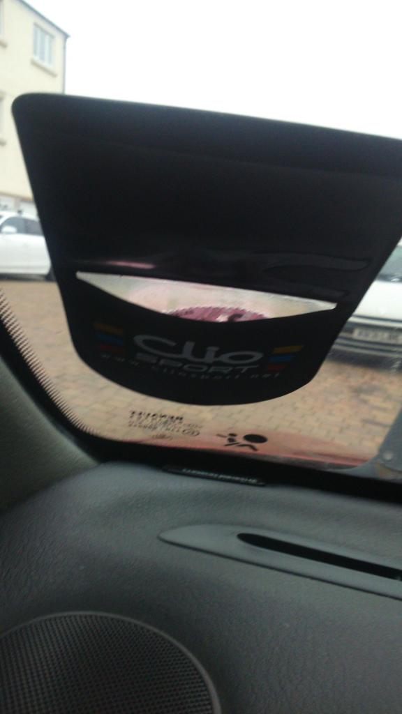

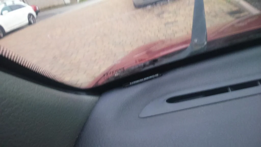

Whilst this was curing, I decided to remove the tax disc holder:
And polished the glue off and the rest of the windscreen with Autoglym Glass Polish

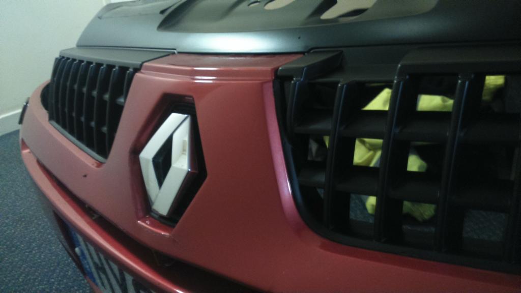

Next I finished off the grill:
And fitted back to the bumper being careful not to break and clips!
Once the bumper was back on I trimmed the splitter:

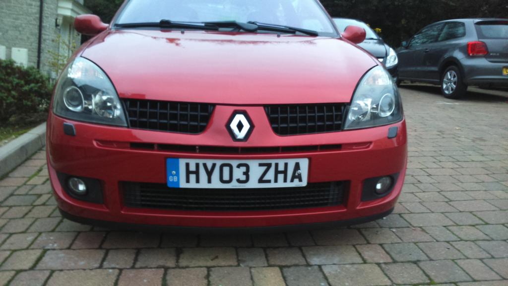

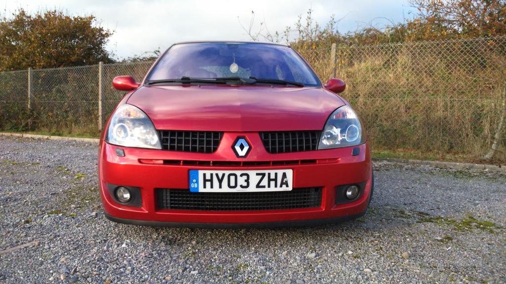

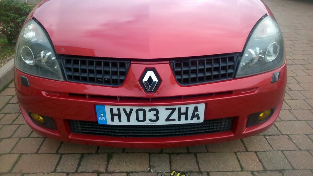

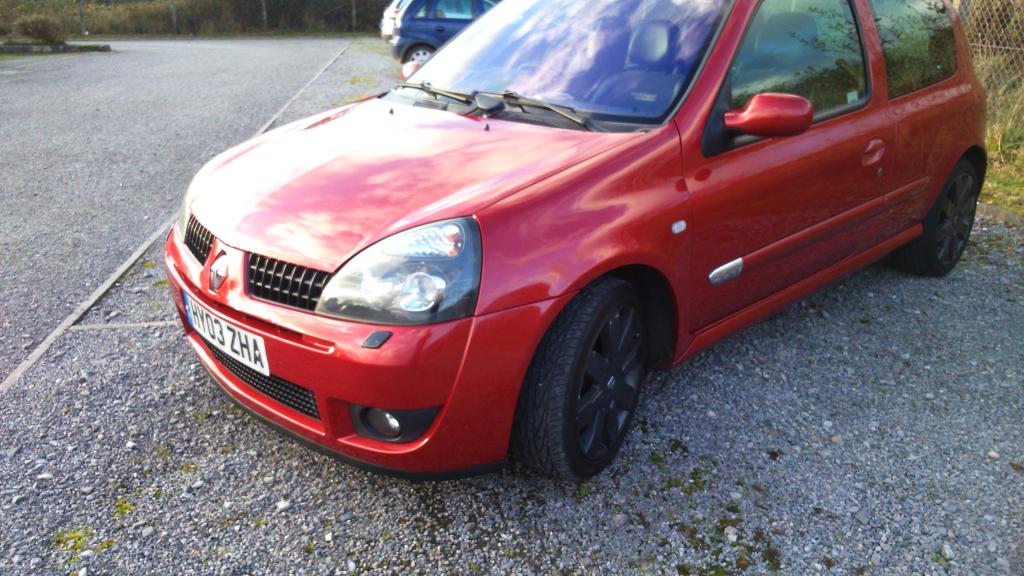

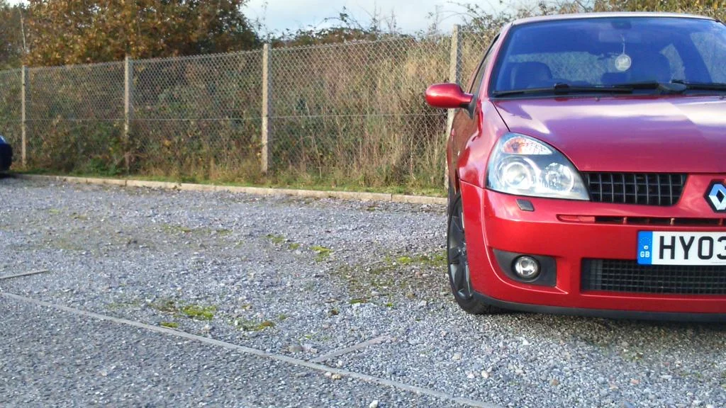

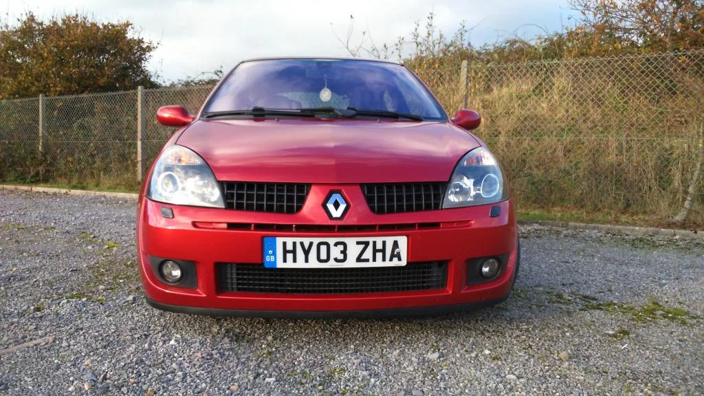

Here's how she looked before:
And how she stands now:
Much cleaner!

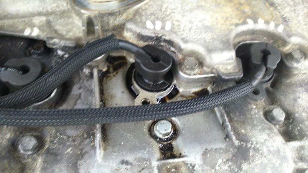

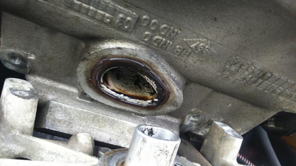

So the flamer started ticking a bit, odd as only recently it had oil, filter etc. Decided to check the plugs and saw this:
Should there be unburnt oil in the inlet manifold? Turned out a couple plugs were slightly loose so I nipped them up, what's the reason behind plugs going loose? Also, should I be looking at replacing the rocker gasket? It was only one plug covered in oil when I pulled it.
  Many.
Rocker cover doesn't have a gasket, and to reseal it you need to do the belts, so just get the specialist who does your belts to do it at the same time. Its pretty standard tbh. Pretty much every Clio I do the belts on I end up resealing the cam cover.
It'd be worth while doing the inlet O-ring too (pictured), and oil like that is normal.
Plugs probably weren't torqued correctly.

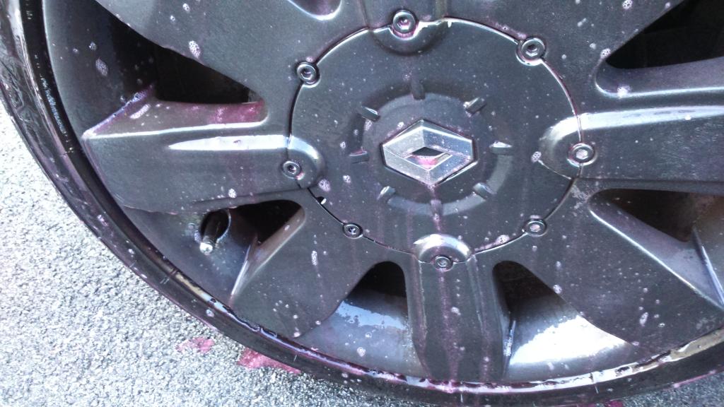

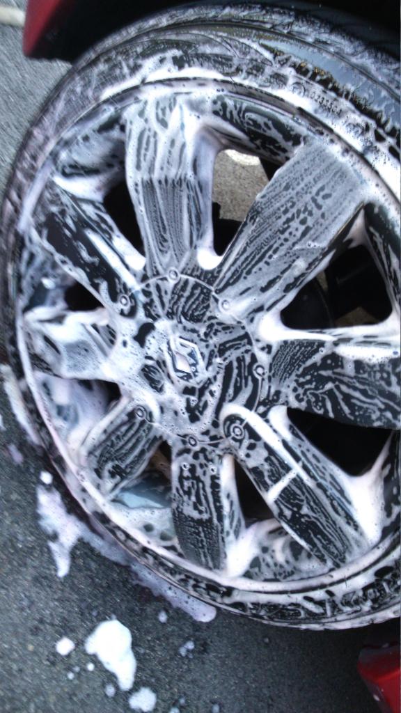

Diluted 3:1 going on the wheel, nice thick gel consistency, stuck to the wheel instead of running off all over the floor:
Foams up nicely with a AF boars hair brush and still clings on for dear life!
Completely forgot the after shots but I'd be tempted to say it's one of the best wheel cleaners I've used, I know 3:1 isn't the most economical of wheel cleaners and tbh, could have gone more diluted with it. I like that it clings to the wheel instead of just running off, I didn't feel like 80% of it was wasted into the tarmac. Also it foams up brilliantly, doesn't dry out in a rush and cleans really well. Big plus is it smells of tutti frutti gum :)

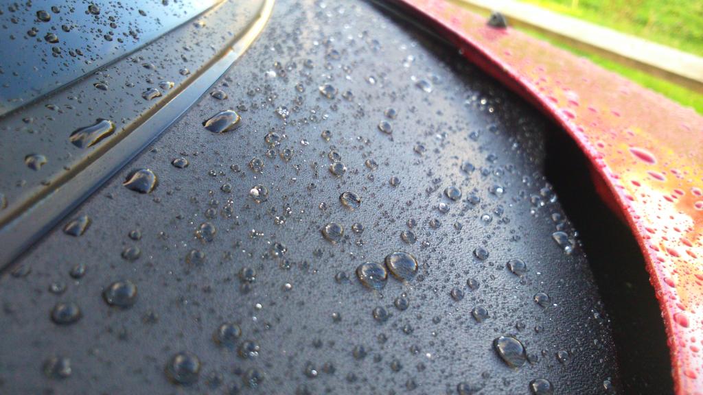

Also during the rinse noticed Auto Finesse Revive was holding up well, applied one coat 3 weeks ago:

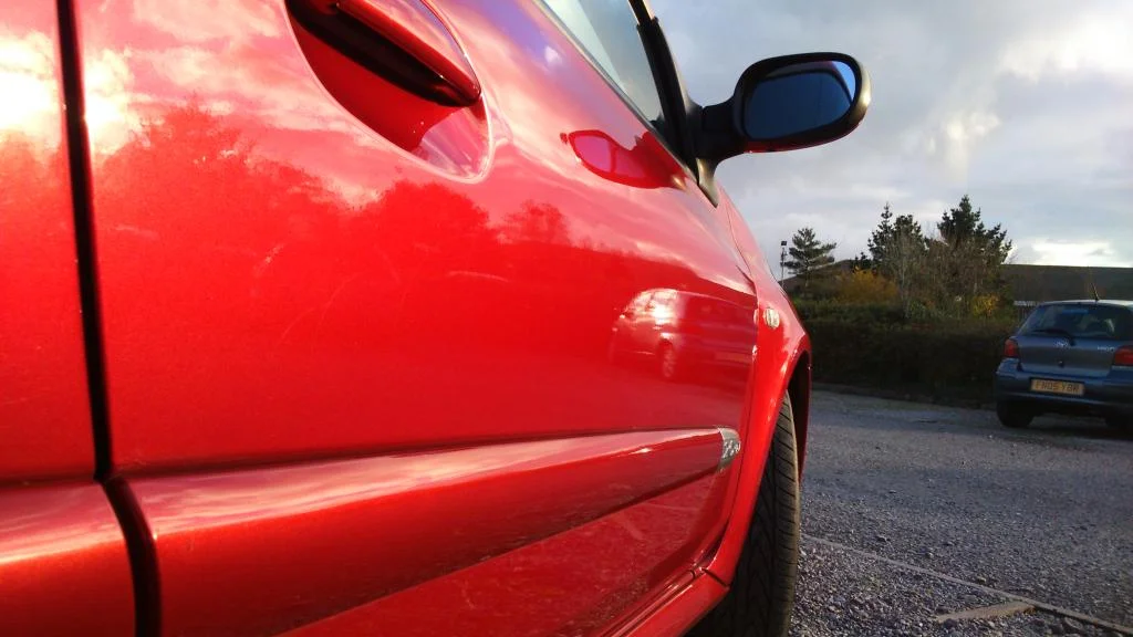

Sorry for the shots that follow, I got carried away. I LOVE flame red!
(excuse the tyre condition, they need a good scrub and some tyre gel)
