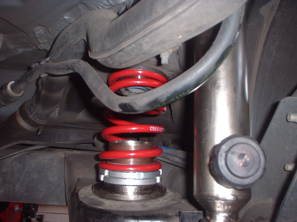

The coilovers are adjustable through 12 settings of damping by a small knob on the top of the front strut and a knurled wheel on the base of the rears (See photos below)

Is that a 5" 200lb spring you have in there? I take it you can specify the spring rates when ordering?
Do the rears use the original bushes?
Where is the front camber adjusted?
Few other things iv noticed ...
dirt covers?
does it need the helper springs?
I cant see it going low enough and having enough travel at the rear? looks like it will sit near to the bump stop all the time.

200lb springs on the rear sound very week my kit has got 350lb springs on the front and 700lb springs on the rear

i have just looked at the pic of the rear coilover and i could be wrong but i say's 0500 -200 -250 so :S come on fred what do you recon they are ?
nope the 0500 is the inch's so its a 5" spring
not sure what the middle 200 is maybe the width
the last number is the lb so 250lb
I think!!!

yoz has cup racer gear on board, spring rate? HARD
the kit you refer to i assume uses the same/similar rear setup as the old LEDA kit?
Looks good DanR maybe we can meet up some time and compare your set up and mine as My GDI kit should be with me Monday and then we can both see what's What
My Ledas are 225 front 300lb rear.
Due to where the supsension pivots a coilover arrangement would need a lower poundage then the standard setup on the rear.
