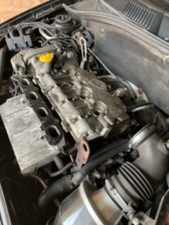

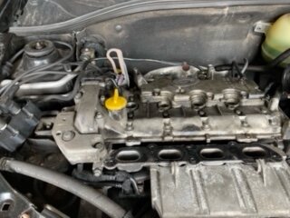

What state of disassembly is the engine currently in?

  Clio Sport -VR6golf
Pics - sad eh!
