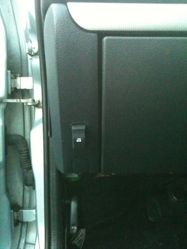

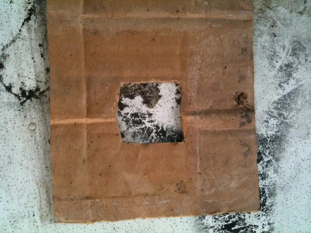

Decided to have a go at relocating my switches today, to get ready for my carbon door cards coming, wanted to keep the O.E switches so...

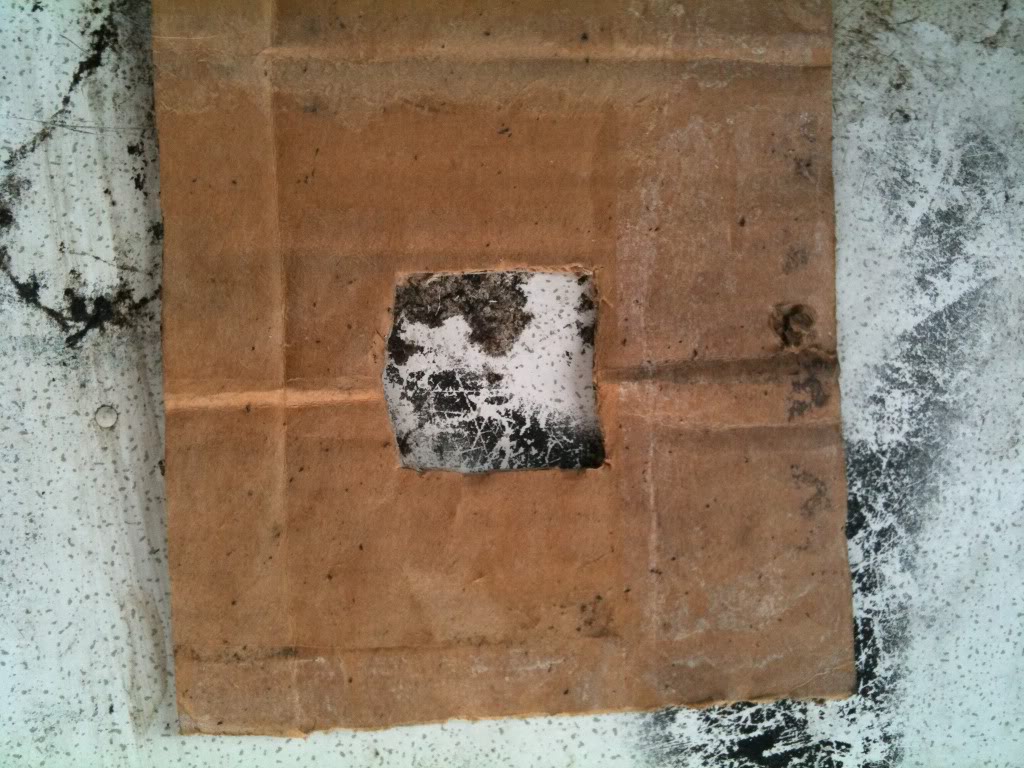

First i butchered the wiring, then made a template out of carboard for the switch.

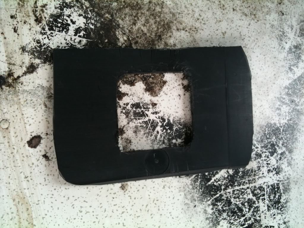

Then made a mock up out of some plastic to 100% make sure it would work.

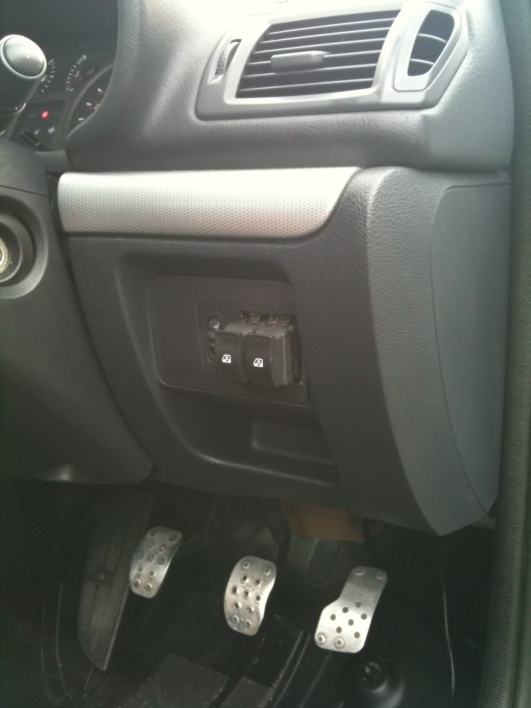

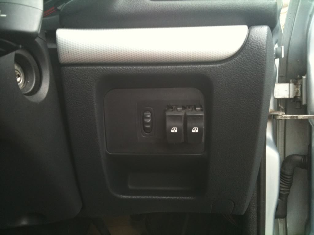

Then i set about carefully cutting the switch panel that also has the dimmer switch on, end result is -
Still works the same as normal, just in a much better place, and easily reachable :) Looks better in the flesh, but meh, function over good looks :)
  DCi 100
Would look miles better if you trimmed it abit more accurate lol. Get it all flocked and it'll be fine anyways.

Yeah, just hide all the wiring away then.
The good bit about my way of doing it is tha the passengers and driver can do their windows down :)

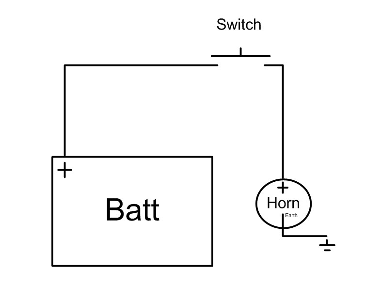

How did you wire in a new button mate? Any pics
Feed from the horn to one side of a switch (ran the horn feed through the grommet in the passenger footwell), other side of the switch goes to the battery. I've still got the standard horn, but I removed one of them. I made a bracket out of some 1mm aluminium to mount the new horn and used the earth from the old battery (I have a race one under my seat like you have). Works fine!

I've done a quick diagram for you for how to connect it up, you could stick a fuse in there if you wanted but I didn't bother:
