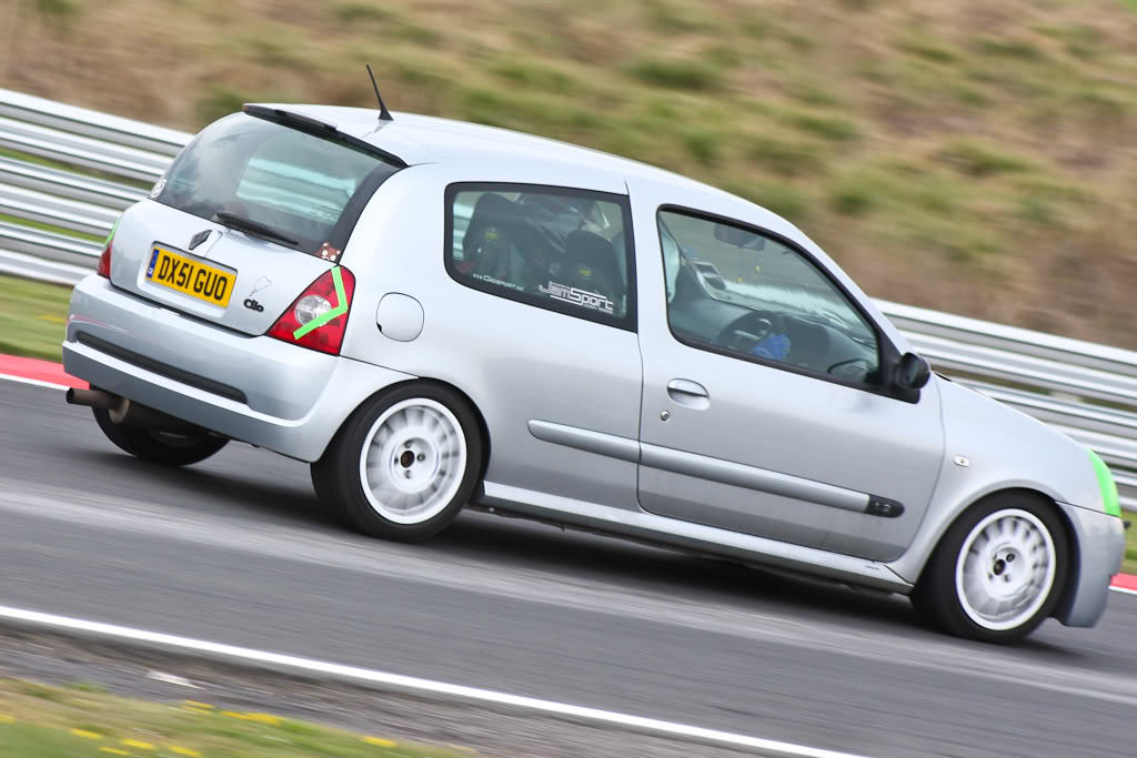

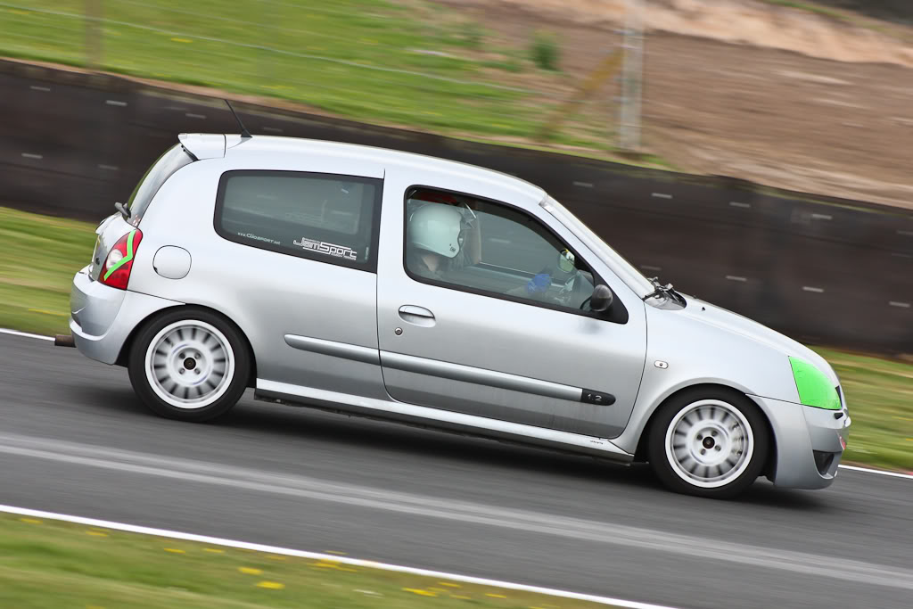

Oulton Park today.
Awesome, car performed really well. Have a gearbox oil leak, think it might be coming from the driveshaft seal??
Weighed it in at 943kg, so 219.80bhp per tonne :)
More weight removal next....
