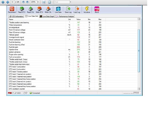

What things can you you read from the Clio?? In comparison to his screen shot??
This shows Water Temp, Air Etc etc
