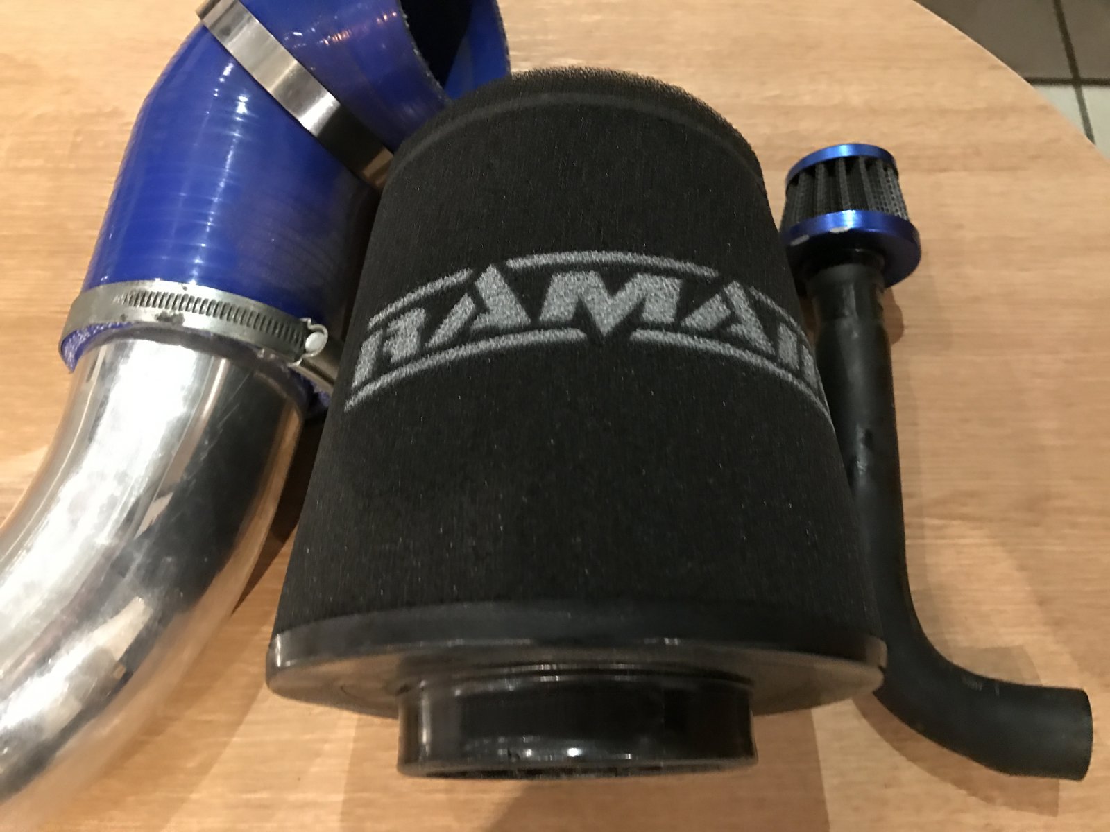

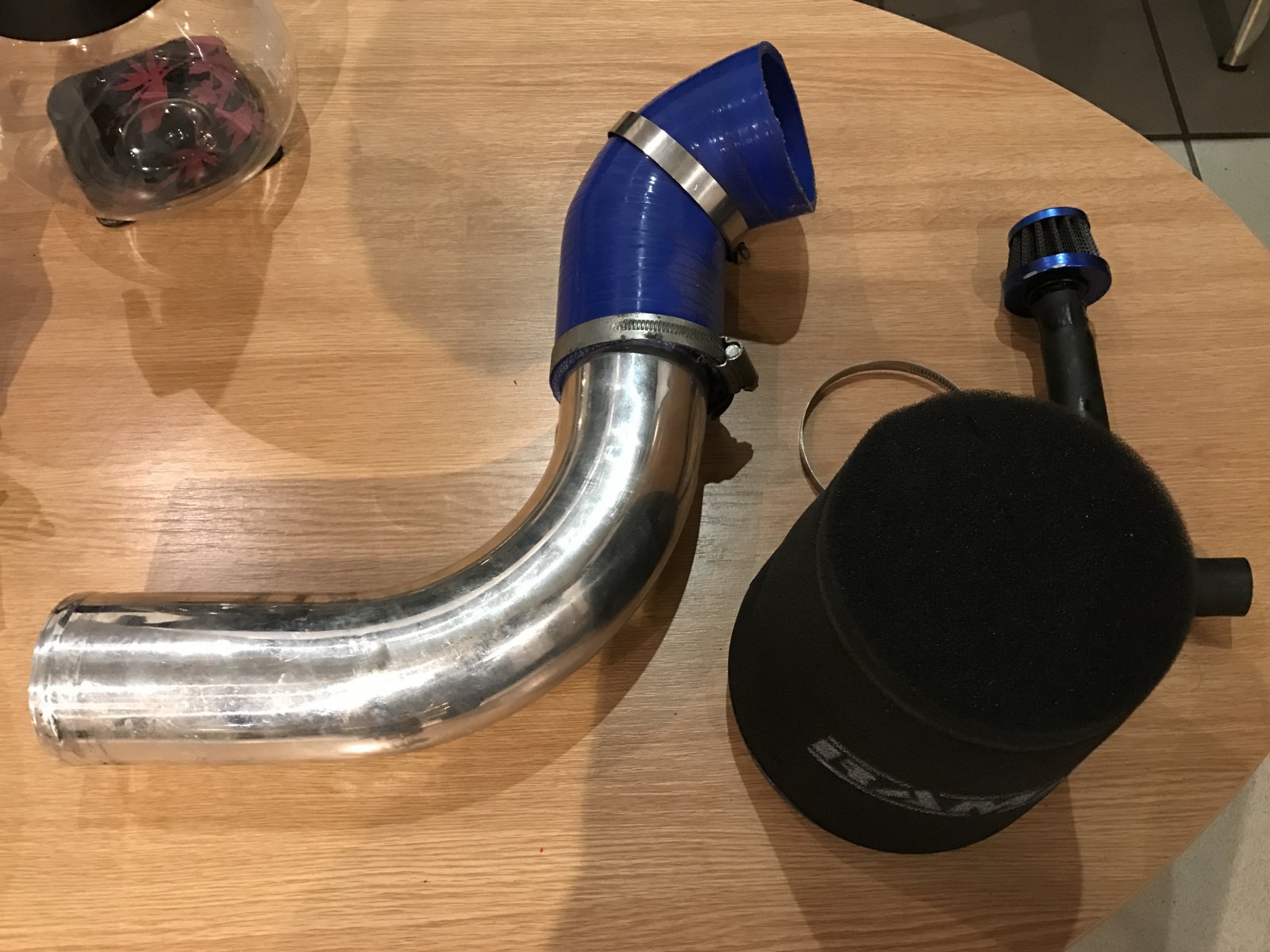

I'm confused. I've just ordered the ramair cone and a 90 degree ASH silicone elbow in red (obvs). Apart from jubilee clips, do I need anything else? I've seen others having to get joiner things?

No you dont. Only need joiners if the filter and hose won't match up, which yours will. Have you got the metal pipe going to the filter?

You'll need a joiner and extra jubilee clip for the silicon elbow to join to the inlet elbow. I'm not sure that the silicon elbow is as long as the alloy one though, that's why most swap the inlet elbow with another silicon one?

Oh yeah sorry misread you first post:
OE elbow-->OE clip-->70mm alloy joiner-->new Clip-->90degree silicone elbow--> new Clip-->70mm alloy joiner-->Ramair clip-->Ramair filter.
You need the joiners as you cant tighten a clip on to a soft silicone hose against a soft oe elbow and a soft ramair filter!
You chose the expensive way!

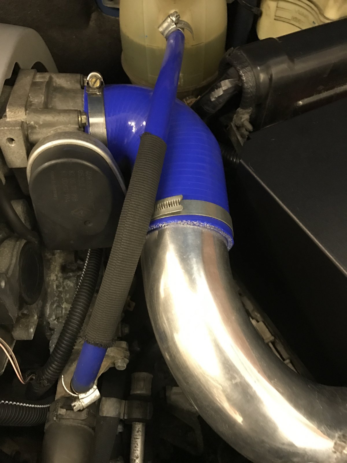

Does everyone remove the air feed from behind the front wheel arch when doing this? Feels a bit... tight
  monaco 172
Mine just pulled off the top of the acoustic valve. Needs a bit of muscle but it will come.
