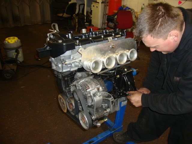

the boy from renault said you dont get a aux kit for mines, he said it looks like mines runs from the crankshaft, water pump, alternator, and the power steering pump? as there is no tensioner listed or rollers for it

The cup setup is different to the normal one we were all chatting about mate. The aux belt is tensioned totally differently :)
lol we all got mixed up then mate, so all a do need it the aux belt? along with the timing belt kit (cam seals) and dephaser pulley?.
Yep, as can be seen here:
