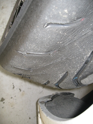

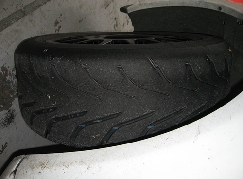

i did a recent track day at brands and forgot my pressure gauge, so had to use a halfords foot pump to check them. they ran over inflated and by early afternoon the fronts were dead.
and this was on a brand new tyre.....

PS - the ones in those pics have been left overinflated. Would guess you didn't let any pressure out once they had got up to temperature so you were running 45+ psi when hot.

Well spotted, i was releasing loads of pressure at donington.

yup, totally over inflated, hence why i mention my lack of pressure gauge, and only the use of a poor halfords one!

Brands can be a killer on tyres if the pressures are wrong as its nearly all right-handers, not surprised to see the graining. Do you scrub the 888's for a few laps first and let them cool before pushing them?

those in the pic i beleived where running 26psi, but i think in actual fact it was closer to 28psi.
and as said above, its all right handers, so that tyre got some serious abuse.
the tyres where scrubbed in, just on the road for about 300 miles. But as for scrubbing them, letting them cool, then pushing them... no cant say i did. will this improve the tyres life?

Generally running a heat cycle through them won't hurt, I can't say that it will stop graining etc as that depends on car setup and driving too, but as said above, it helps to 'cure' the rubber.

I would be very surprised if fmp's tyres were running at anything like 45psi.
If we assume he inflated them to 30psi when cold (lets say 20°C), then due to the fact that the air in the tyres is governed by the ideal gas law (it does not follow it completely, but is close enough for this illustration), technically he would have had to have had the air in his tyres up to 166°C to get 45psi. Due to the fact that temperature induced in the air inside the tyre lags behind tyre pressure changes (due to the thermal mass of the rim), it would be safer to assume that the temperature inside the tyres was something like 120°C. This is an extremely high temperature to be seeing inside the tyres.
That's interesting.
I've never had wear from wrong pressures like that.
Would be very surprised if being 28psi instead of 26psi was the sole cause of this problem. Did you start of with the FL lower in pressure than the FR, due to the fact Brands is predominantly right handers?
Having read you're taking part in Time Attack this year, have you invested in a pyrometer? It's a very useful bit of kit. It can be used for measuring the temperature at different points across the tyre, and if you have significantly different temperatures across the width of the tyre, this can trace this back to under/over inflated tyres, and incorrect camber settings.
