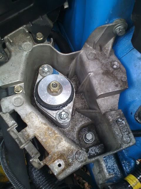

here is mine:
You might need too use a socket to knock the inner part of the bush further down the shaft, iirc my bolt is now flush with the top of the nut.
It should be as per the picture posted by pablo

looks like that - it tightened down onto it fine just seemed to turn the whole bush from there. so it is tight enough?
  330Ci Clubsport
Id say if all the threads on the nut are being used its fine.
