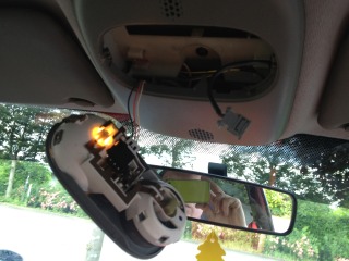

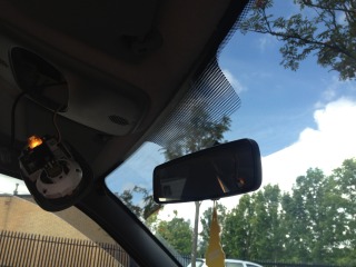

the one i just picked up is missing the sensor on the winscreen , and the windscreen dose not look like it has the gap or mounting clips for the sensor to fit on the screen , its a 04 plate

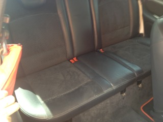

yer its got leather and suade seats , what other bits should i look for to see if a cup not a ff 182 its got cruise and speed limit , , the guy has put a stuipid sun strip on it , can the auoto modual be added to the windscreen ??

the sesnso on the windscerrn is mising , i tryed to activate with turning the light stalk on and off twich quickly that rigth is it not then i see the sensor was not there between the roof and the mirror

Is there a little wire with a connector on the end coming down from the roof lining above the rear view mirror?

possible then would the wire be in the roof still , i not looked yet for that , but that was my thought , get it a new sensor and replace the screen

Auto light sensor is circa £100 iirc brand new from Renault, casing around it is £20ish I believe.

yay the wire looks to be there a black nd purple , so jsut need new sensor but will i need a new wind screeen as well witht eh mount for it if you know what i mena and the space for it to go on

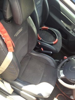

and looks like some one has messed about with seats drivers seat non of the wires are conected up , and the wieres to the belt ignights do not match up , now not happy , thing been done over now thigs did not thiokn to look for

ment to have aq black and grey plug , but this seat has a blakc and the a white and blue insted of the grey , can any one off any ideas

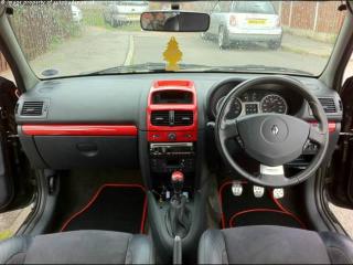

Have you done the check where you hold the button at the end of the stalk with ignition off and then switch the ignition on whilst still holding the button.
All the dash lights should come on. Look for the important ones to see if the airbag, esp, abs lights are there. Otherwise it means they have been covered up. Because it seems like that car has 'bodge' written all over it.

Its strange. The drivers set not plugged in at all. So should have dash lights should it not. But there are no lights up, dough what to look at next. Any idea people and looks like if the air bag unit has been set off I need to replace the ecu as they are a one time device
All so the garage has said its got some codes in it they can not remove wont let them clear it Dunno what to do now
