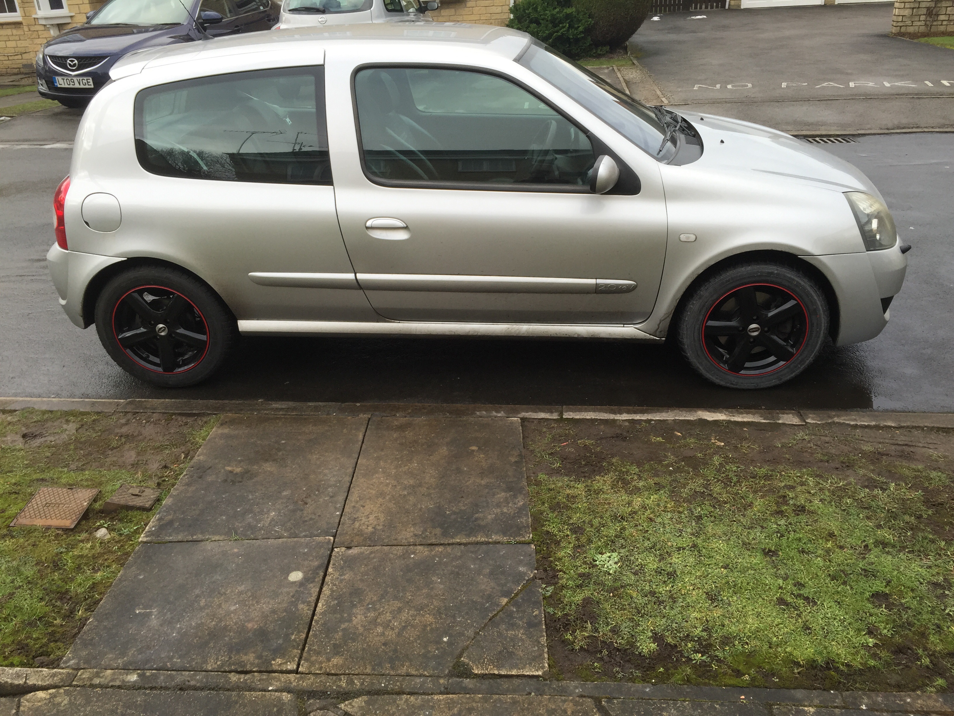

i have bought some 15's for my car. Put them on and started to take it for a general drive and as I was setting off there was a mocking sound coming from the front wheel.
I have looked through the forum and having realised that putting my original wheel nuts that I had on the car might be the problem that I am having.
The next question is the guy that I bought them off gave me the nuts for his car but they are for an Alfa 145 and have the following number on. a39 10.9 a.
I know what the 10.9 means but was wondering if these nuts will fit?
Any advice would be greatly appreciated. (I have bought the correct spigots today for the car) mike

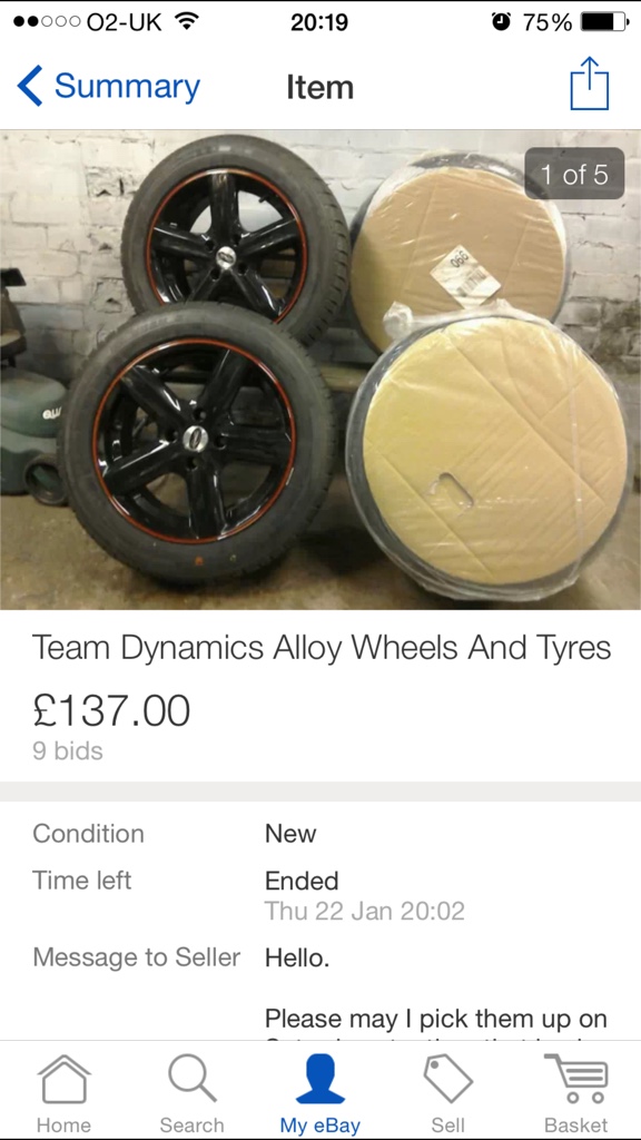

Yea buddy will do. If your interested these are the ones. Got an awesome deal off eBay
  182
Budget Nankang Snow Viva SV-2 winter tyres.
Going to keep them for the winter.
Decent deal tho- nearly had them for 100 quid but someone run me up!
