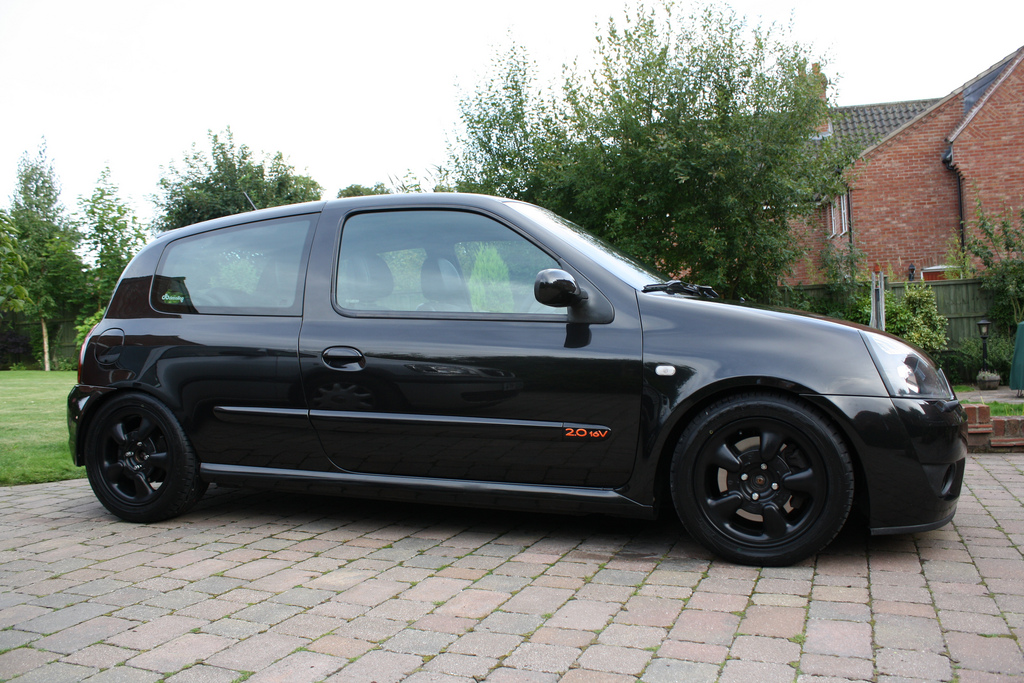

You can safely run 36 on a 172 i had williams speedlines on my cup they were ET36 no problems..
  Focus ST170
Cheers fella thats about the only decent pic of mine, was taken by Fletcher IIRC..
Atouba - mine was dropped -50mm all round

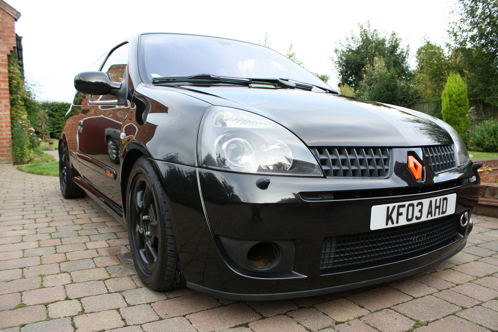

I've found a couple more pictures to try and show you what height mine was and the offset.
I didn't have any bracket rubbing issues but did have a bit of arch liner scrubbing
Hope that helps Tim!
