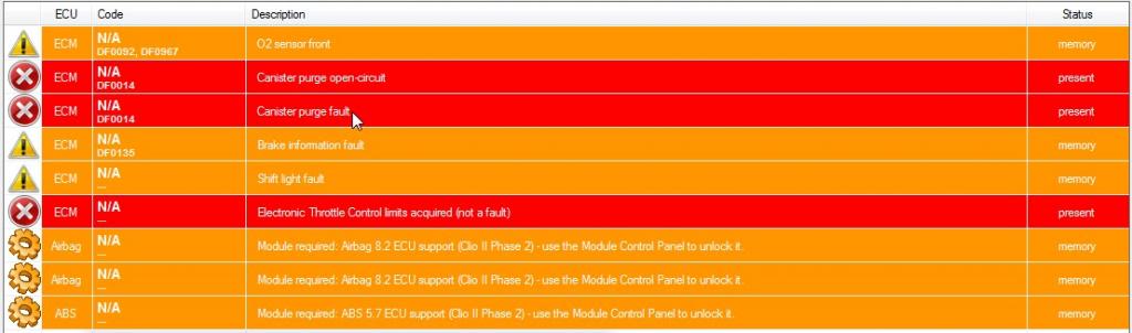

See Screen shot of RS Tuner log:
strange thing is I cant seem to find any actual physical faults, cruise control very rarely works but I figured that was down to the after market rear brake globes as posted many times on here.
ABS light came on once during last track day, turned car off and on and all has been fine for couple of thousand Kms. (code was cleared but has came back on) light never re appeared
Starter motor today was the 1st time car ever failed to start, push started ok and has been fine all day since.
Oh also have the door open dash light on most of the time lately.
Any ideas would be great,
looking at what you have got there as a screen shot i would guess
front lambda sensor
starter motor
brake switch
check the carbon canister solenoid/piping
check your door switches as door light warning on
and go from there does it run all ok ?
