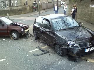

I fitted the 1.2 subframe no problems after drilling the missing holes, then this happened a few days later...
The subframe wasn't to blame though, the Escort was lol
