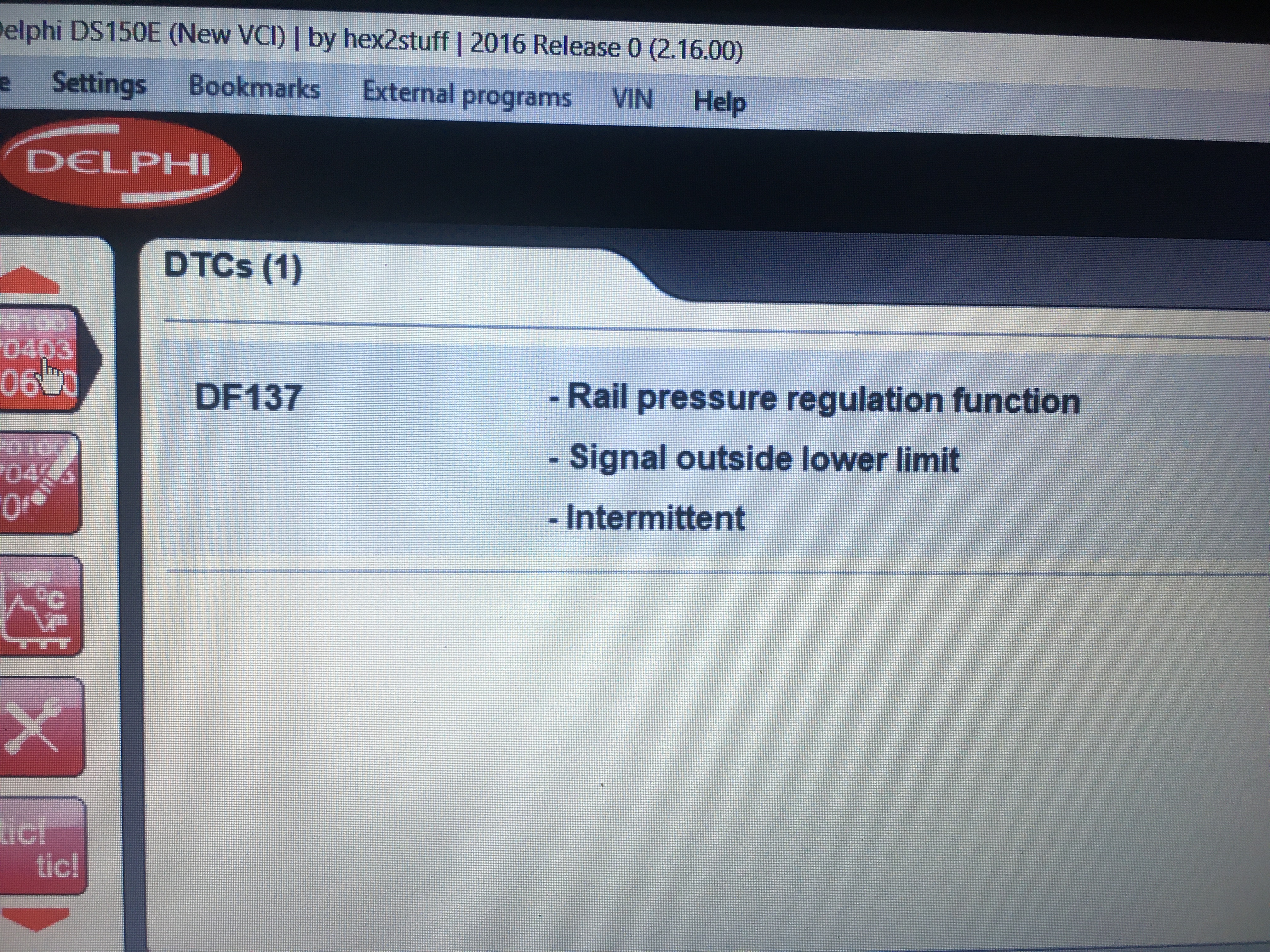

Hi Guys i am new here i have a 1.5dci k9k engine that would not start and gives DF137 fault code can someone please guide me in the right direction

Need more details on the DF137, Whats the state of the error code, minimum or maximum? More to it than just the code. It will be leak off test time

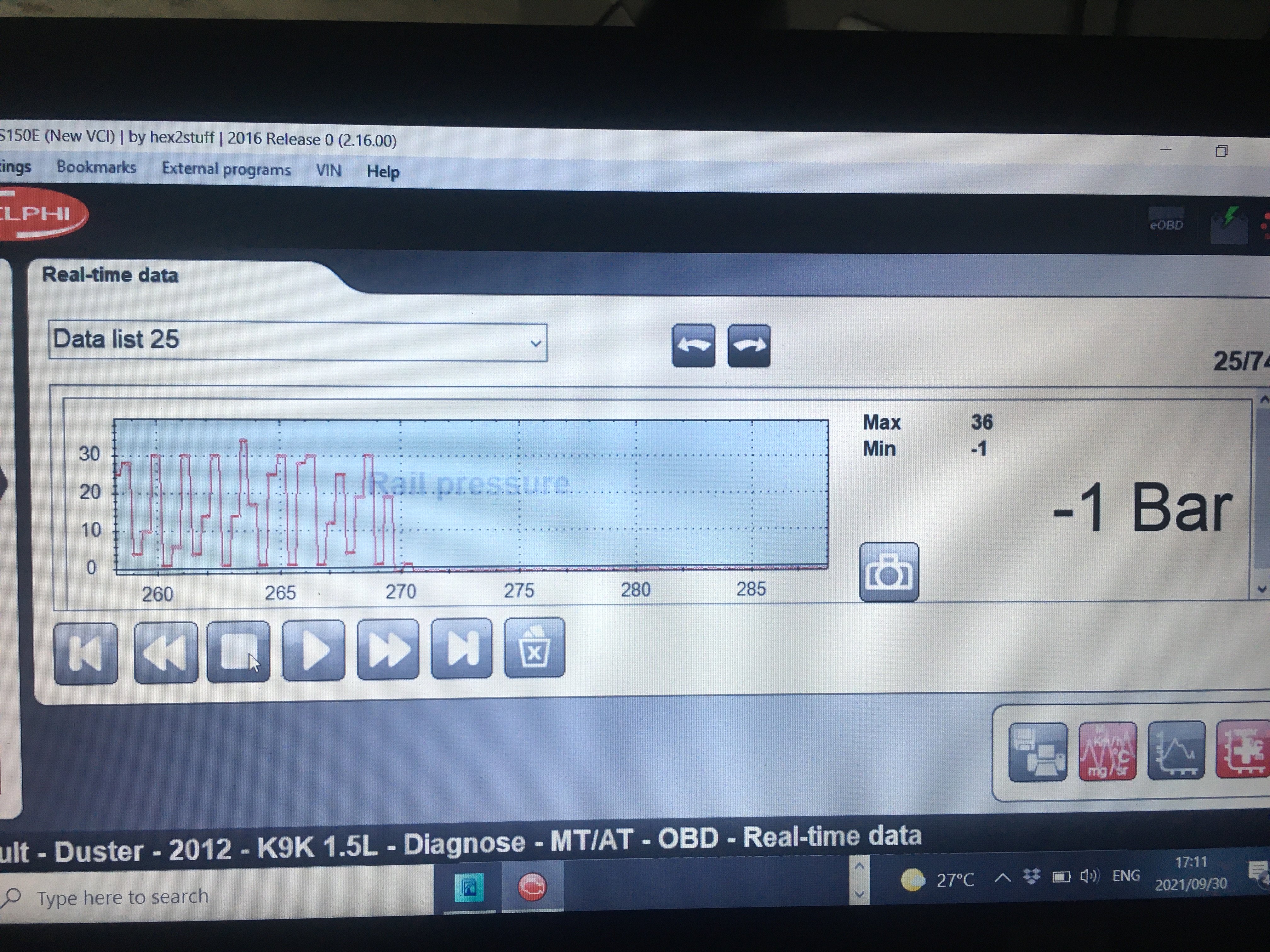

Hi Brigsy thanks for the reply, so here is some background on what happened and what i have done so far, i was driving on a straight level road and suddenly the car was speeding up by it self even after i left the accelerator this lasted about 3sec and then it died , ever since I couldn’t get it to start, when I put my scanner on i got the DF137 signal outside lower limit so i then check the fuel pressure regulator for operation and for brass from pressure pump all was well, next I did the leak test on the injectors all is good, i then monitor the fuel pressure on the scanner while attempting to start and found it fluctuates between -3 to 19 bar from what i have read this is way to low. It did spike at one stage to just above 100 and almost started but after that the highest it would go was 19 bar, i then suspected the regulator I have replaced it today but still the same

Need to do the dead head pump test with the correct Delphi kit to see if it can produce the correct amount of bar.

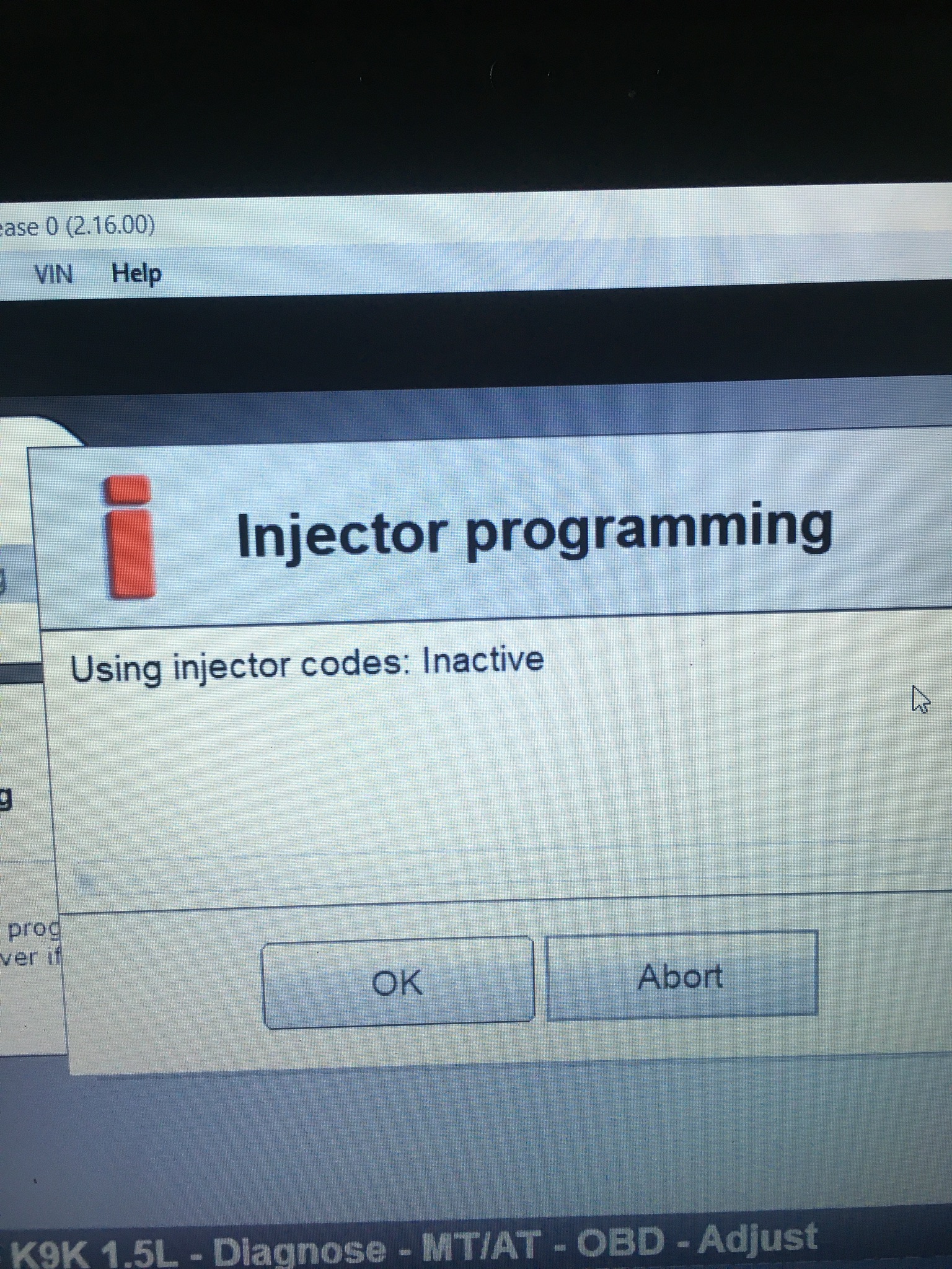

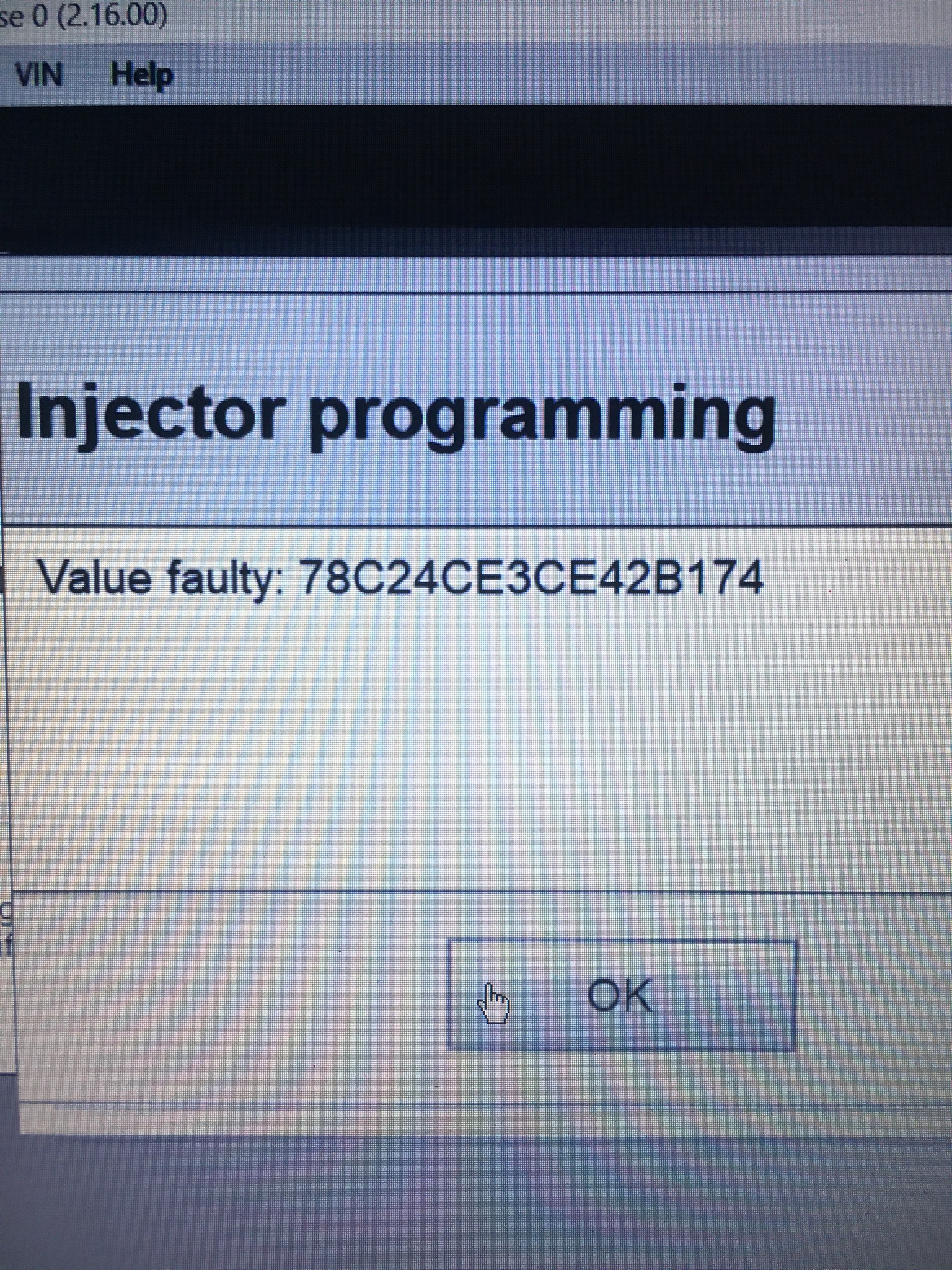

Hi Dr HMS thanks for the help, so i went back and found the following 1 I checked the injector coding and found all injectors in the wrong cylinders so i removed them all and fitted them in the correct place as per the ECU all but number 4 the number of one injector did not match any of the numbers on the ECU the cylinders 1,2 and 3 i cold match injectors, so currently injector number 4 does not match the ECU number, I tried the Delphi DS150 to change the coding but no luck it constantly says value fault and when entering to the function in the beginning it says inactive, now some of the mechanics here in South Africa tels me that the coding doesn’t matter is this true?

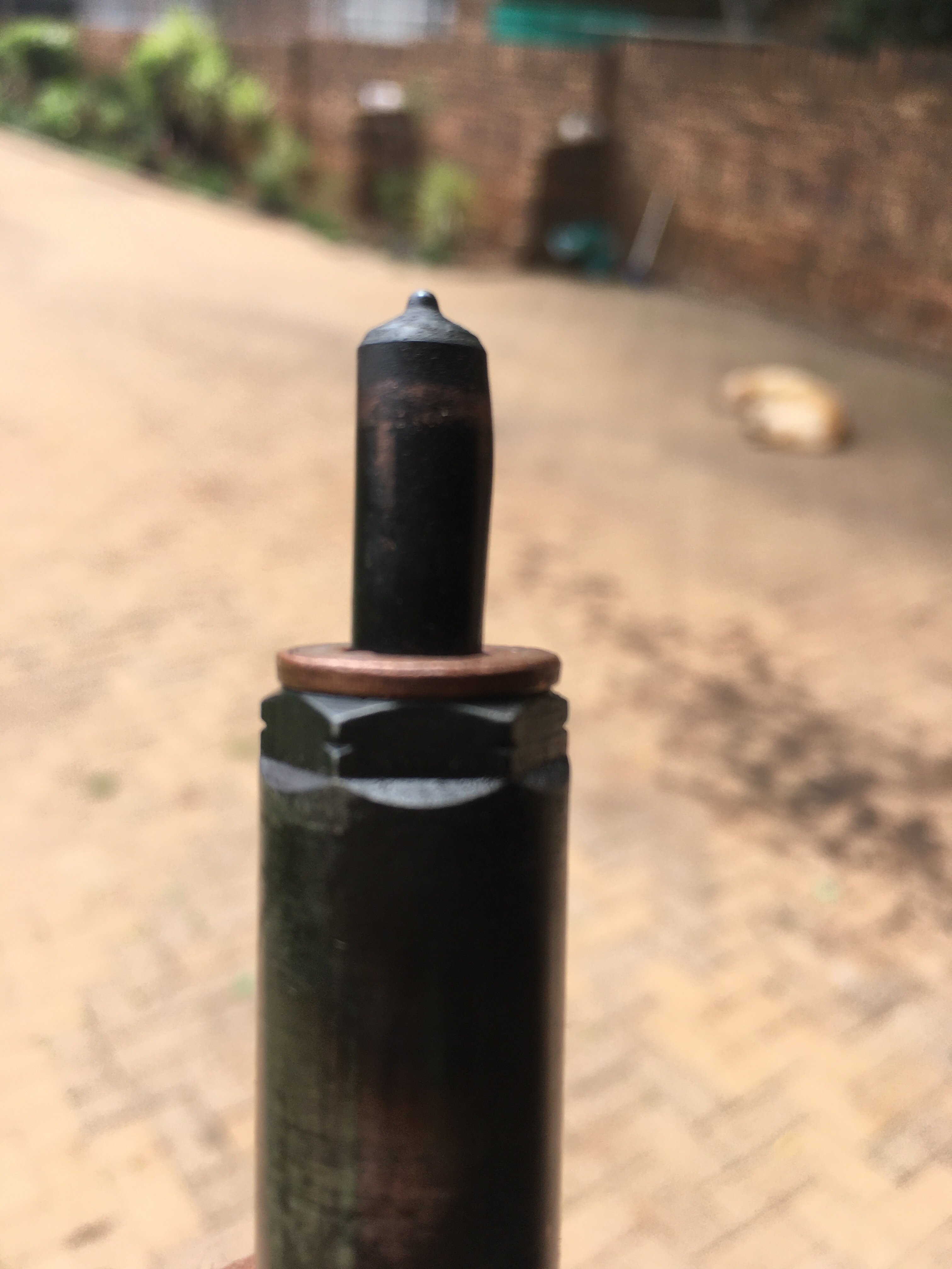

2 While switching the injectors I found number 1 injector tip was blown up on the side see attached picture what could cause this?

To answer your question about coding, i doubt it would make a huge difference really. The codes are mainly used to tell the ECU data about the injectors calibration in order to operate as efficiently as possible. So the engine should still run fine, just not at its best

That nozzle has blown down to some sort of wear or extreme heat expansion , common enough on diesels, can sometimes cause hard starts or rough running due to the injection needle not Seating fully in the nozzle, and the nozzle holes not spraying the correct pattern.
yes the injectors can be fitted without coding , it’s a C2i code for fine running counters , just tells the ecu the calibration statistics, ran plenty of 1.5s without coding and they run fine.
