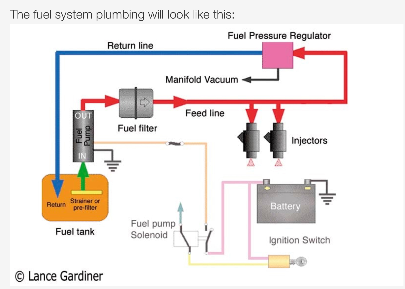

I believe the attached diagram is correct for a 2001 Clio, but I have no idea where to find the various components
Please suggest what I need to check to eliminate some issues and find the problem. If possible link to photos or a video so I know where to find the items to check.
