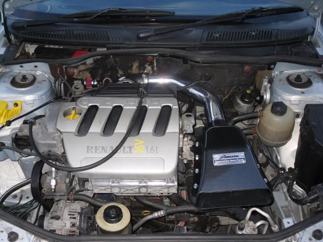

I have a long life catback system with mid note on it and a panel k nad n filter, zaust sounds very good cant quite hear the induction tho from the filter , I was thinkinh of getting a K&N 57i kit and making the piping off the(Silicone) throttle body for it then placing the cone by the light further down with enclosed case around it e.g simorta style and inserting cold air feeds ,, now has anyone here done anything similar to this if so any difference in driving e.g smoother and better noise any help would be great and pics also what is the diammeter on the throttle body to fit the piping or hosing too

the pic off piston heads looks a bit riggy but potentionally a good set up, in my experience k and n arent what there made out to be, and if your using an air box i would go for a sponge filter, you would proberbly be better off with a better airbox ( 172 maybe ? ) and a good cold air feed, also as said above dont forget about the breather lol, hope this helps

If you want noise just buy a cone filter and place it where its designed to be. Itl be loud. Messing about with all he piping is a waste of time, your not going to gain any performance either way.

standard airboxes are designed the optimal size and shape for your engine, obviously noise levels and space available has a say on them too but generally they are pretty good, personally id be removing the resonator and making a new air feed from the front of the car to the airbox, and id be changing the throttle body for a F4R non RS one, there is one that fits the engine thats slightly larger, there is info on it on here. and using a panel filter
