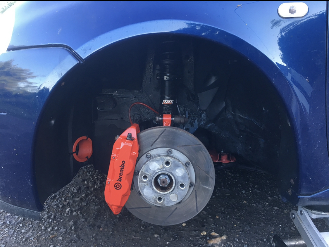

  Hi comp phase 1
I’ve got the 197 brembo conversion on my ph 1 with et38 ultraleggera’s and 280mm discs. I’ve had to run a 15mm spacer as the wheel is conical and narrows by the spokes. Admittedly the brembo calipers are bigger than the wilwood ones
  Clio 172 + Clio200T

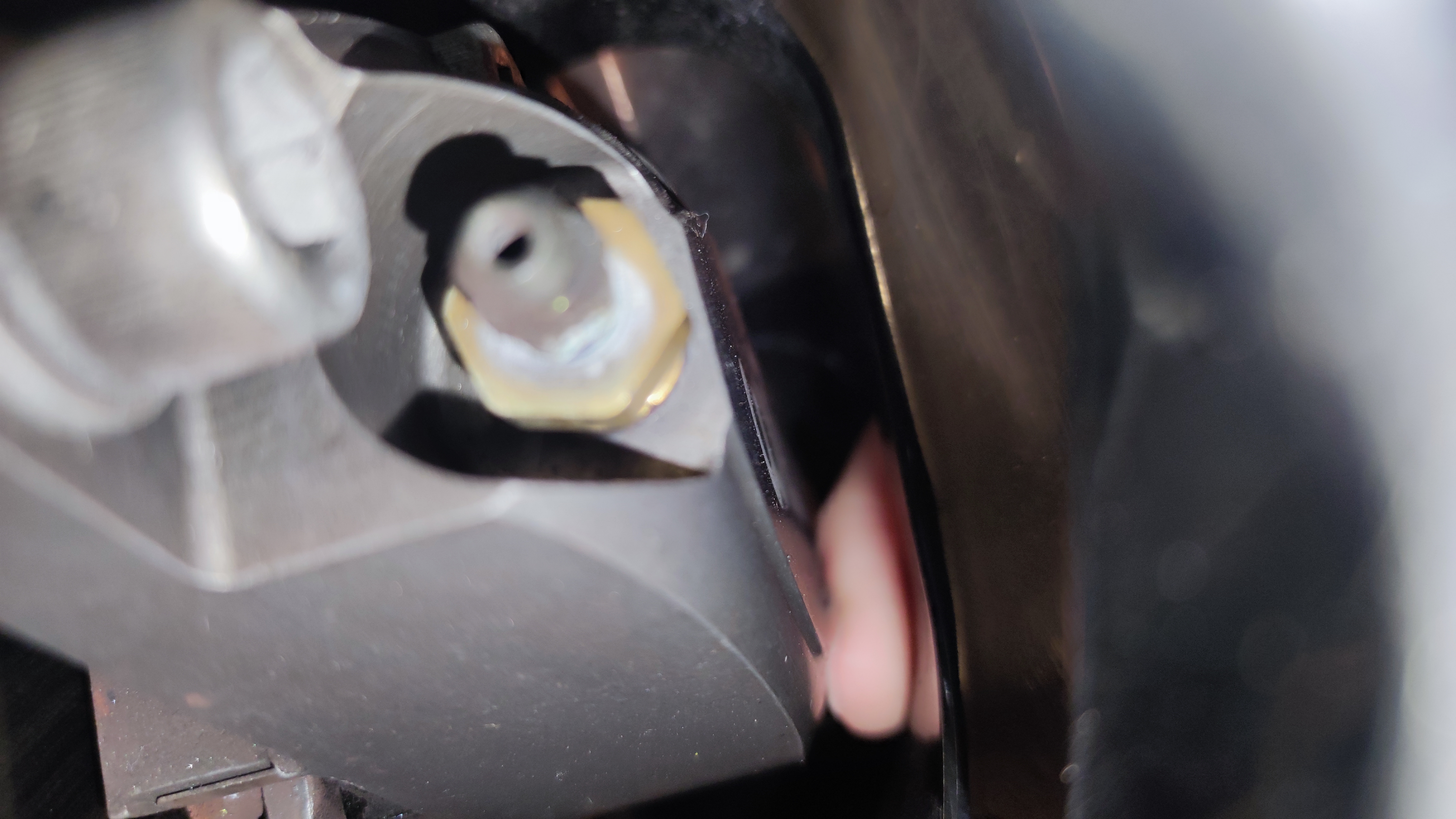

Yesterday I had my mom's twingo here so I took one of her wheels to have a check.
They are 15" x 6j (so.. being narrower the spokes are more near to the caliper than a 7j would) and same ert (et38).
They bolt fine and have a pretty clearance.
May I assume that with a 7j ultraleggera clearance would be way more? Caliper is pretty far from hub so the spoke inner radius should not be a problem (lile I had with 406 brembos and superturismo).

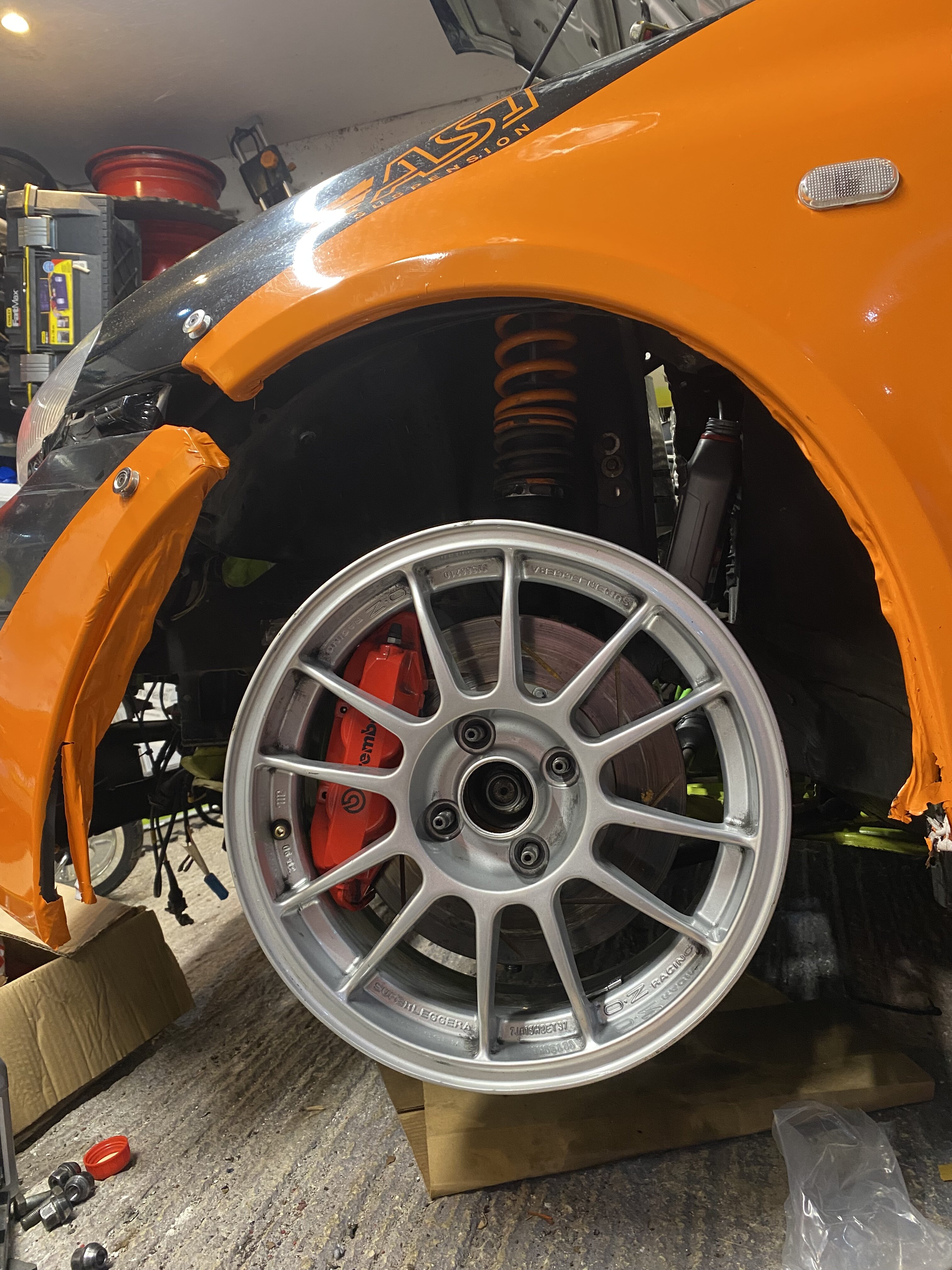

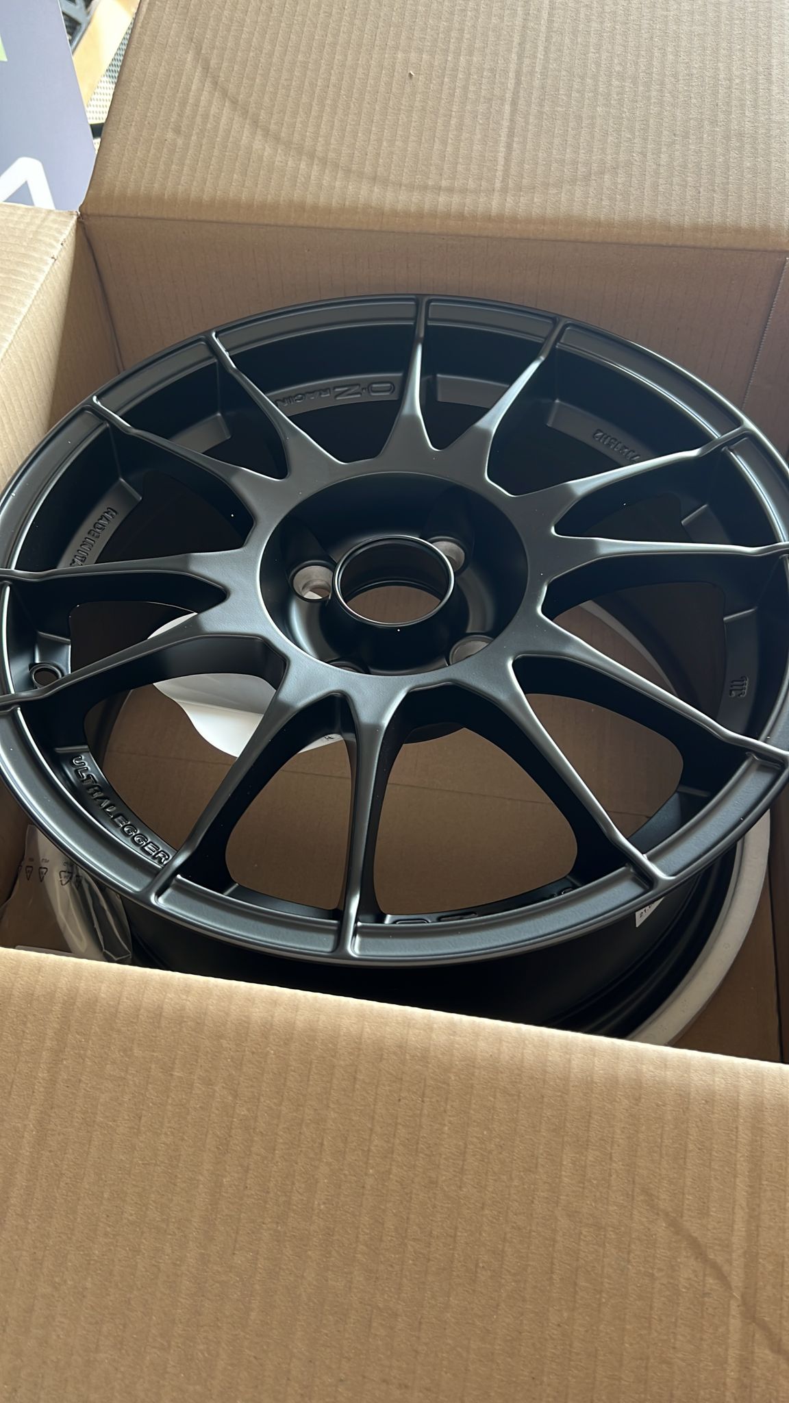

Ok guys.. after researches, chats and tests.. I finally decided to go and buy them.
I just received a nice message from my dealer that they are there.
I am planning to get them next week (since he is not so near where I live and I am super busy theese days).
As soon as I will fit on the clio I'll update this thread so that it may be helpful for others.
I'll have them with some nice fresh AR1 tires.. can't wait!!
  Clio 172 + Clio200T

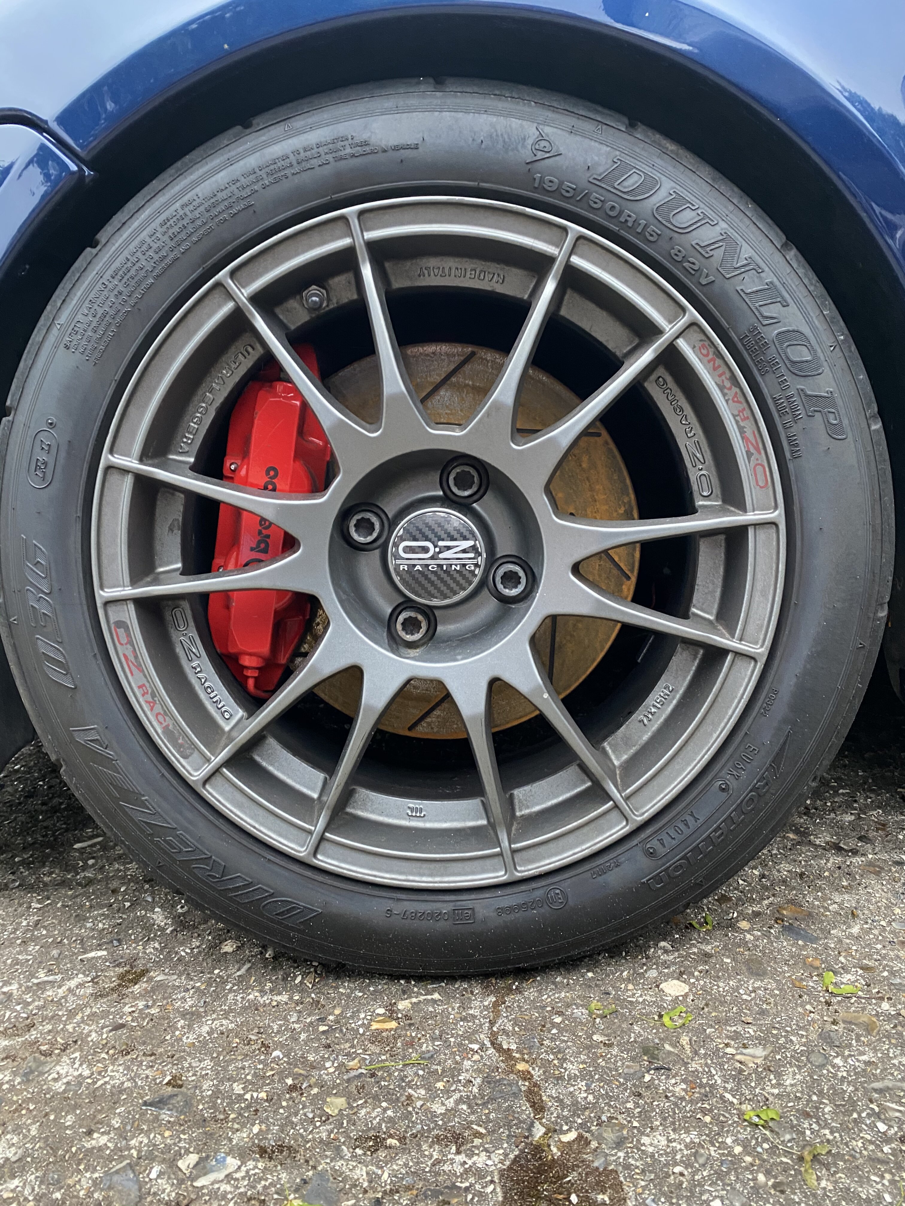

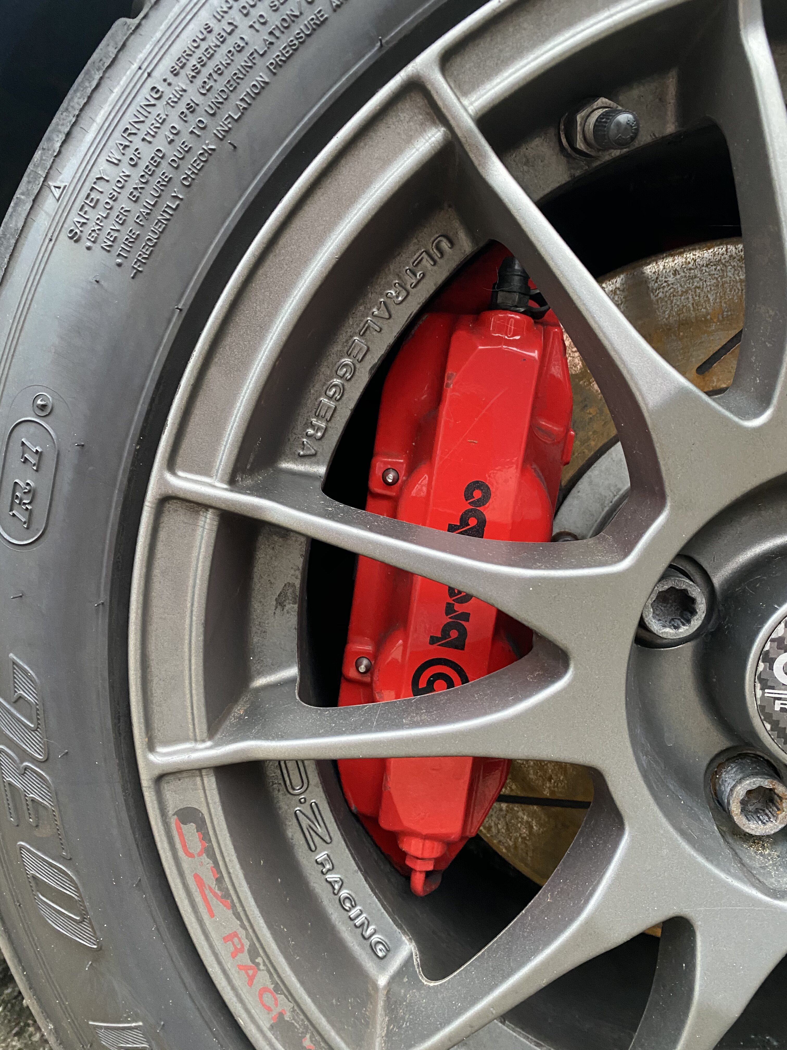

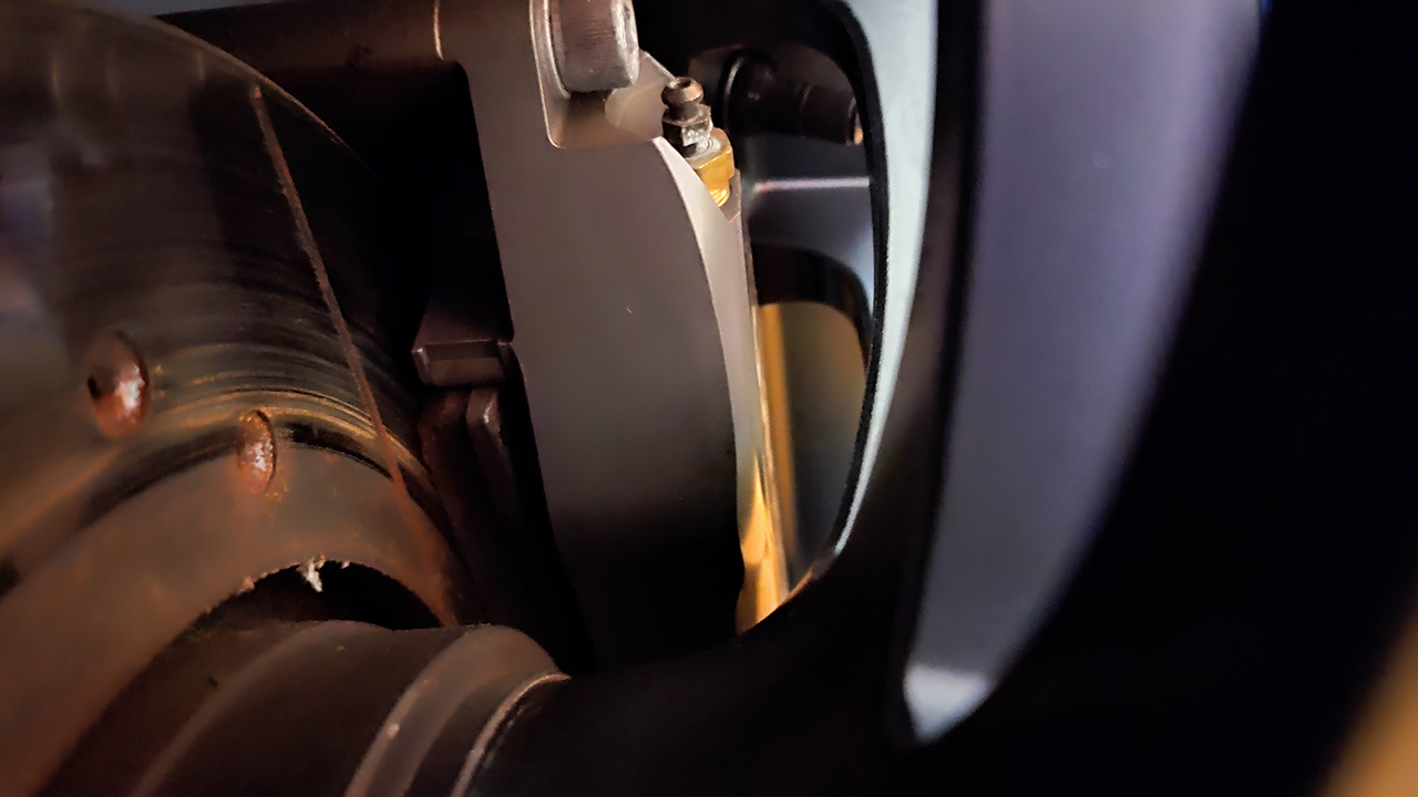

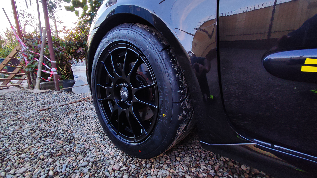

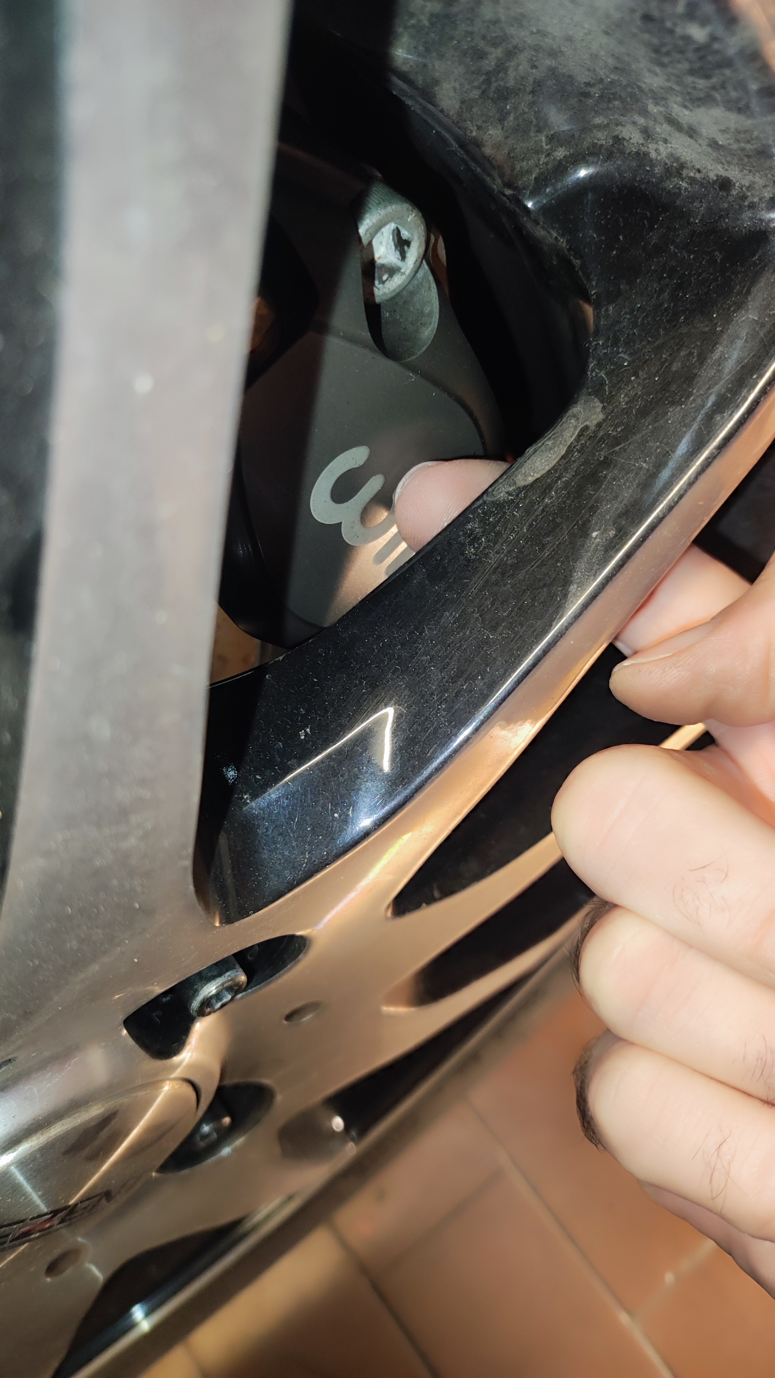

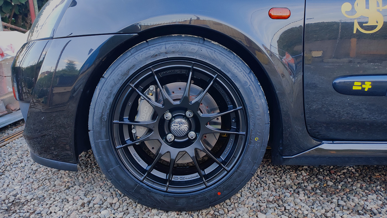

Hello guys.. as promised I am back with the results! It took me a while because super busy with work, and also been a bit ill.. anyway here we are.
Today I've picked up the wheels and fitted my new AR-1 tires... fitted on the clio as soon as I come home obviously!
I can definitely say that Caliper clearance is not an issue They really have lots of space around the caliper and also between caliper body and spokes.
I was talking with my friend of the garage and when those rotors will be over... we'll check if we can stuck a bigger rotor (will be something more "pro" with brembo or AP bands with custom ergal bell).
So.. pictures time!
p.s. Last pic is a bonus because I love how fat those wheels look with AR-1!

MLB
That looks great👍
Exactly the same wheel/tyre combo I'd like to get at some point.
Do you know how much smaller the Wilwood calipers are than brembos? Do you think 197 brembos and 280mm discs would fit under these as well?
  Clio 172 + Clio200T

Thank you!
Good Choice! it will look great!
Thats a good question.. I never had some 197 brembos on mine (even tho I dreamed of them for a while) So I cannot give you a certain answer. I can say Wilwoods are very very compact calipers especially width wise. Being brembos a "longer" calipers.. they would surely be very near the inner surface of wheel.. But they may fit. Whats doubts me more... is the width. I'll attach a picture took on the inside of spokes. Here can be clearly seen the clearance (I only have a small 5mm spacer) with my calipers. Clearance near pistons axis center is good, so they may fit, but if you lookat lower caliper edge.. shape of spoke comes very very near.. thats where it could hit the brembo. Best would be to have some measurements...
Unfortunately my friend's garage is not near me so I only go there once in a while.. because he has a racing clio with brembos. a fit test could have been made!!
I'll try to keep in mind, if some day I go to his garage I'll try to bring one clio wheel to have a check.
Look great (y)
Thank you mate!
MLB
Thanks for taking the picture, that does already look tight, might work with bigger spacers but was hoping to get away with 5mm max myself.

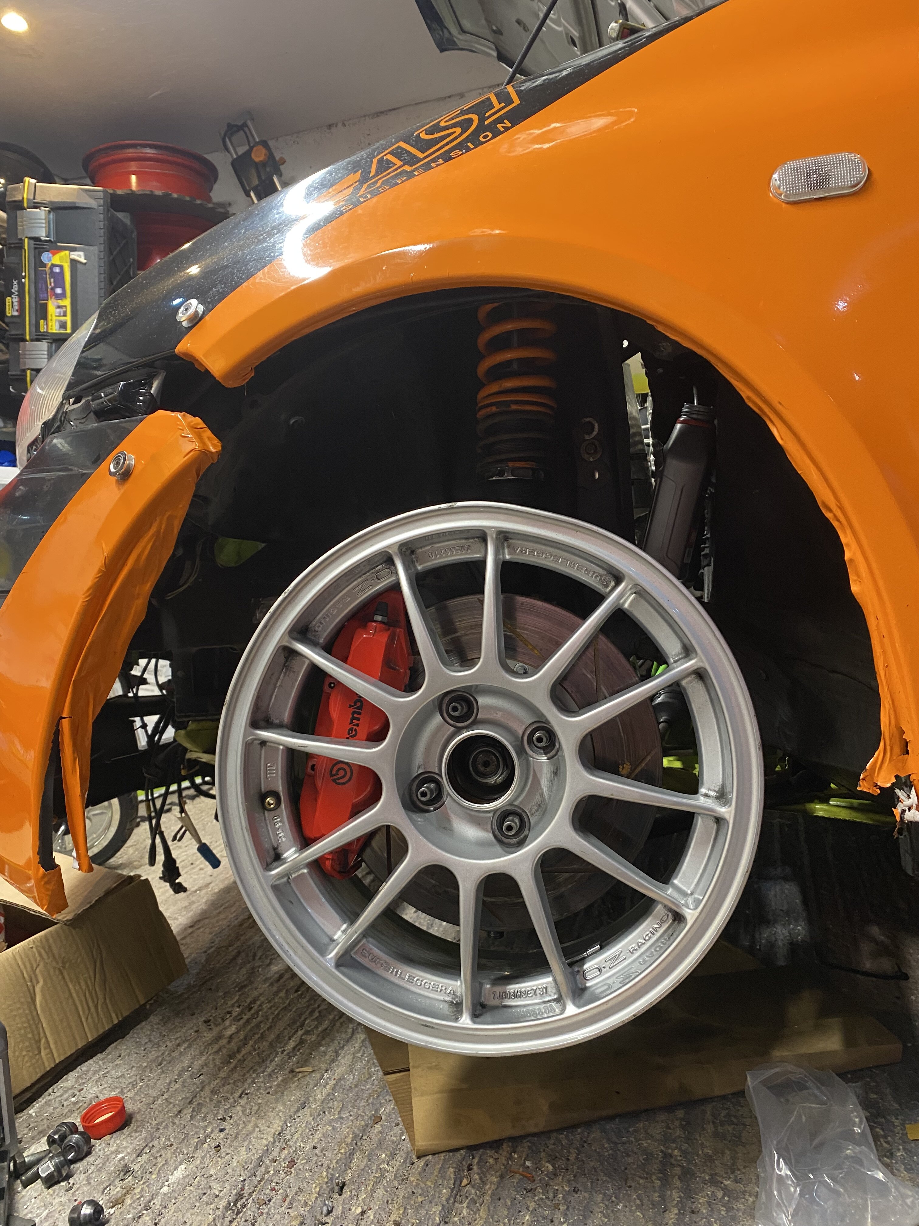

Good work, been running same setup for years on my 15" superleggeras. The original Speedline Maracanas also fit over them so loads of clearance with the Wilwoods
MLB
That does look close to the barrel though! No issues with cooling?
Do wheel weights fit?
Jamie86
  RS175,595,205gti,172
Can get a steel rule between the barrel and caliper. Did a couple of races on them no problem. But did have to mount the weights on inside of the wheel.

  Clio 172 + Clio200T
No its not so tight as it looks! If you need.. I can take more pictures with a ruler to give you better idea! Difficult to say.. on mine I have 5mm spacers and I got that clearance.
Your experience is what made me decide to jump the leap! As you pointed out in our chat.. ultra and super are tight Brothers so.. they have also kinda same fitment!
They do fit over Brembos but need a spacer. I used 10mm probably get away with a little bit smaller though.
Hey! This is not a good news.. hahaha now the brembo thing would start to dig into my mind!! Hahaha

green
  Hi comp phase 1
I use a 15mm spacers on my ultraleggera’s so they fit. I’ve also had 5mm taken off the caliper and using 285mm discs. Normally do 3 or 4 trackdays and road blasts a year and never had a problem even though they look pretty tight to the wheel

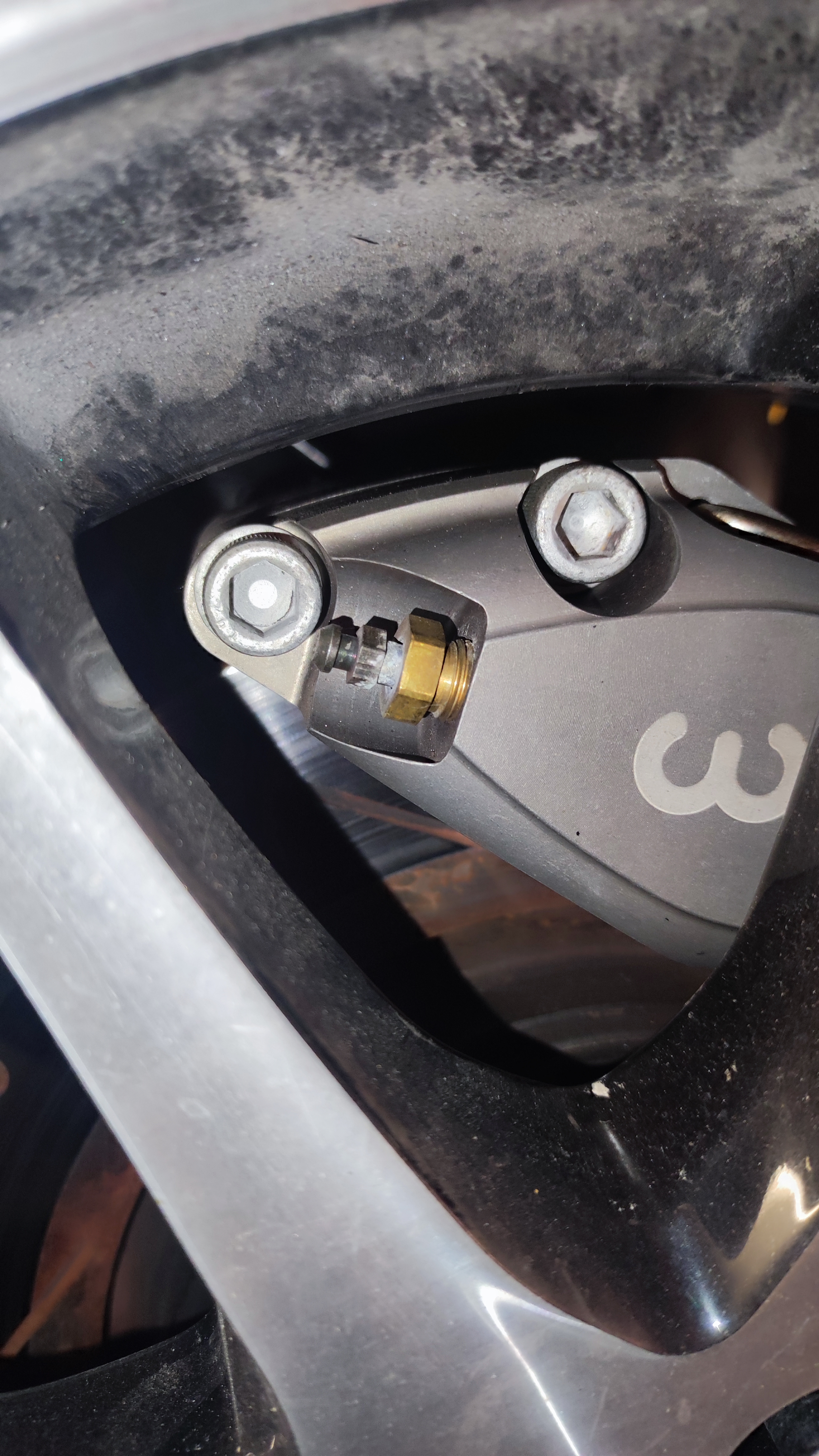

MLB
Brilliant, is that the PMS 285mm two piece disc?
Do you know what the space is between the caliper bolts and the wheel barrel? I'd like to fit BYC cooling plates so they'd push out the bolts 2 or 3mm.
green
  Hi comp phase 1
@MLB there not the Puremotorsport version. I got the bells off eBay a few years ago and had Hi spec make the rotors to suit the bells. If I was doing it again I’d definitely go for puremotorsport version.
There’s definitely enough bolt length to fit those BYC plates as I was going to get them but I found that ducting air into the wheel well cooled everything enough on track that I can do 20 minutes and over with 0 brake fade. Only thing stopping me now is the tyres going off! :rolleyes:
