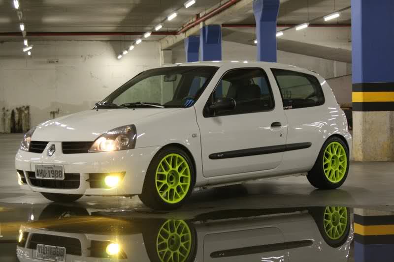

That's what I thought when I did the shop. Something different to 2118 or Turini.

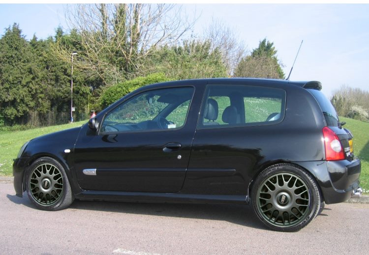

Pretty sure there was a chap on here that had those wheels on he's BG and they looked too skinny in the flesh. I just didn't look right. I'll see if I can find some pics of the car. The wheels was gold iirc. I was parked in front of him at CSS 14 and was speaking to him about it.
  '03 MCS, MKV Ed30

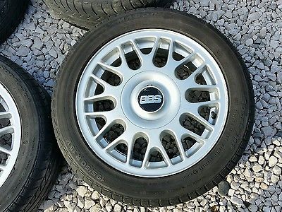

Those look similar. The one in the boot photo is right but the ones on the car look different.
Jekyll
Ah OK mate. Have look on page 2 as I'm sure he said they was 6J when I was speaking to him and you can see on the pics that they are too skinny. IMO of course.
