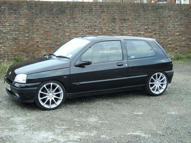

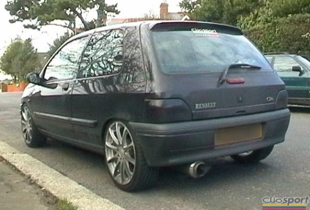

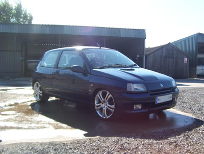

anyone got any pics of 17" alloys on a mk1, and did you have to have any work on the arches or just 10mm spacers?

Think depends is urs a 16v with the wider arches, with these 17s should fit easily!is it lowered?1.2. and 1.4s are gonna rub a little mate but take arche liners out and 'maybe' ok little arch mods neeeded tho, Ryan

Personally i think that 16s are the max on a non-valver.
You can't run them scrub free without some arch work whatever offset or tyre profile you run.
Lowered 55mm on 17s (205/40) tyres, ET 40 offset no mudguards. It rubbed on the outside of both rear tyres and on the front left inner arch.
  182 and 5 GTT
I would strongly advise against it aswell. Mine scrubbed all the time!Every roundabout, speed hump etc! 16" is biggest i would go on a non valver. My old clio on 17s lowered 35mm at front and as low as was sensible at the back! I had no rear seats in, and only my subs and tool box in the back and i still did my head in!
  EP3 Civic Type R
I'd strongly advise against it.
Looks pretty good, but the drive you get and the handling etc is as poor as can be. Mine had 17's on when I bought it, got it lowered and it scrubbed constantly on lock at the front, sold them and got some 15's and had it lowered more and couldn't be happier with it now
