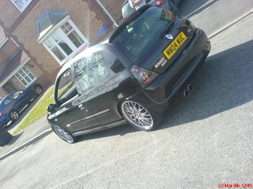

The right offset of wheel and I doubt you would get any rubbing.
Mines lowered 60mm and have had 5 people in the car - no rubbing.
17" in the correct offset and a 60mm drop will be fine. Might catch the liners at the front at full lock but thats it.
  E60 diesel powah
17s on coilovers
