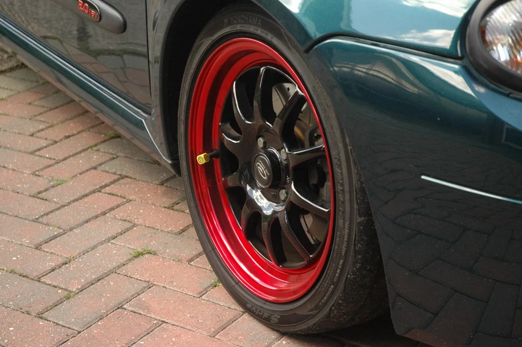

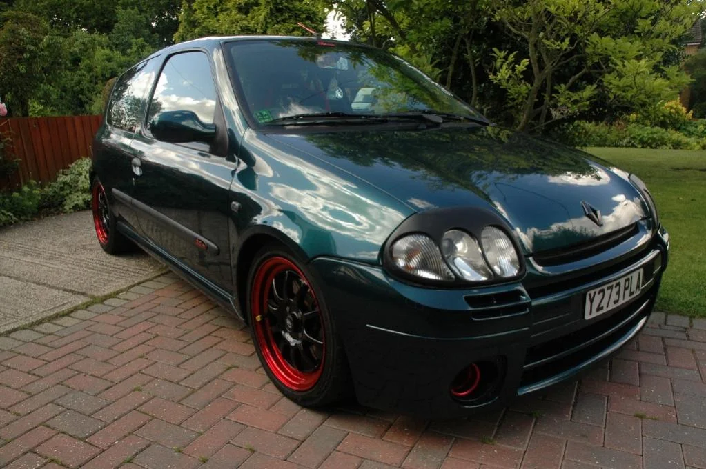

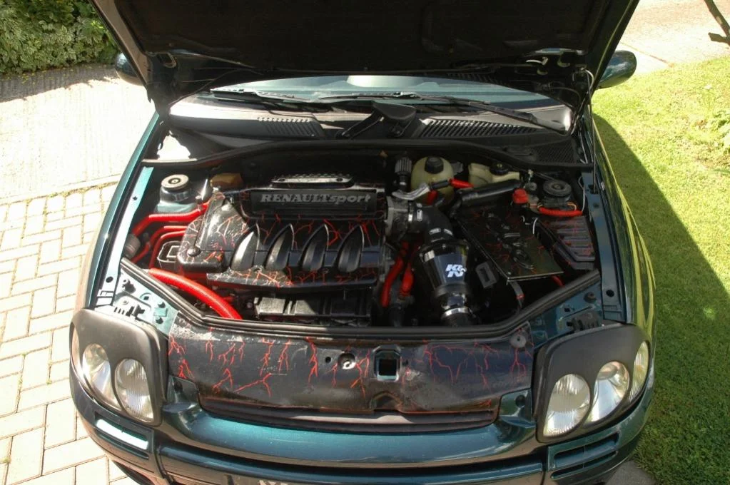

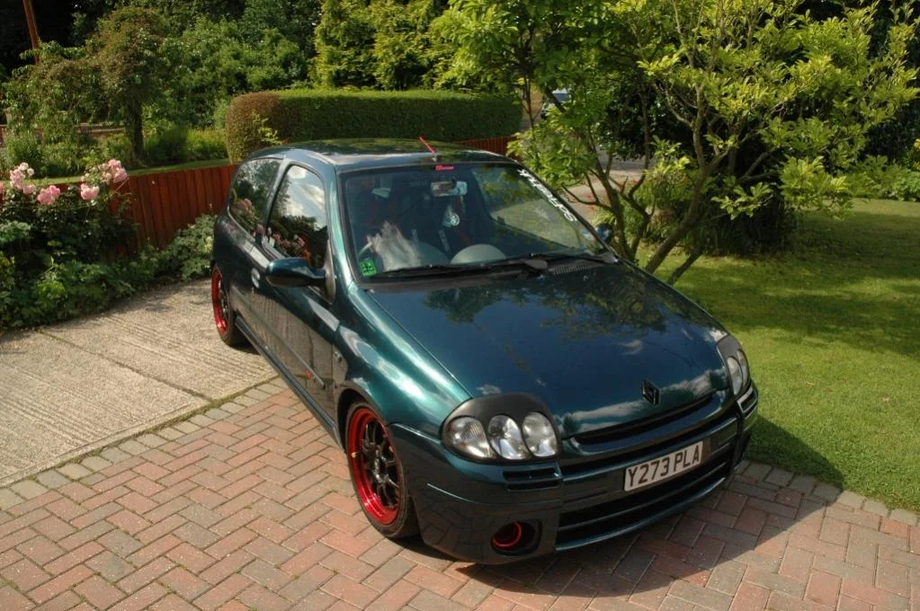

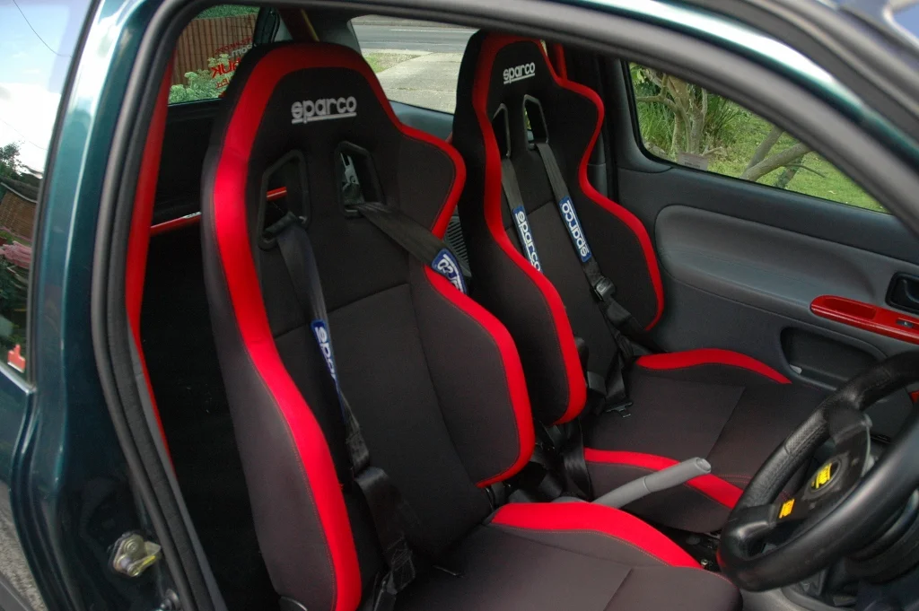

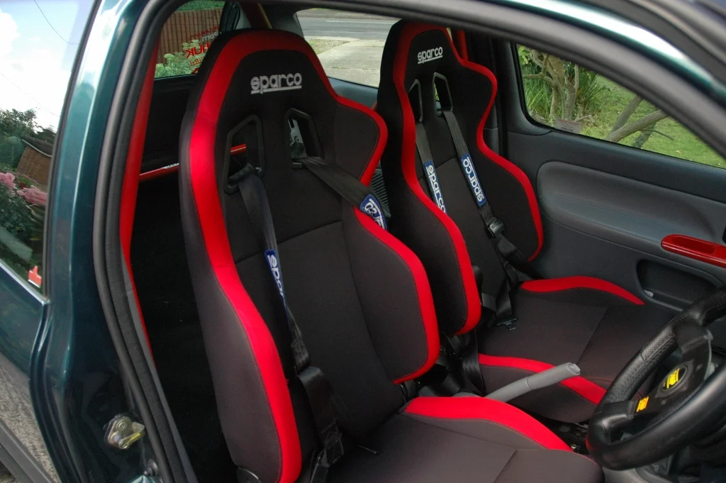

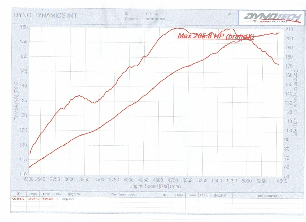

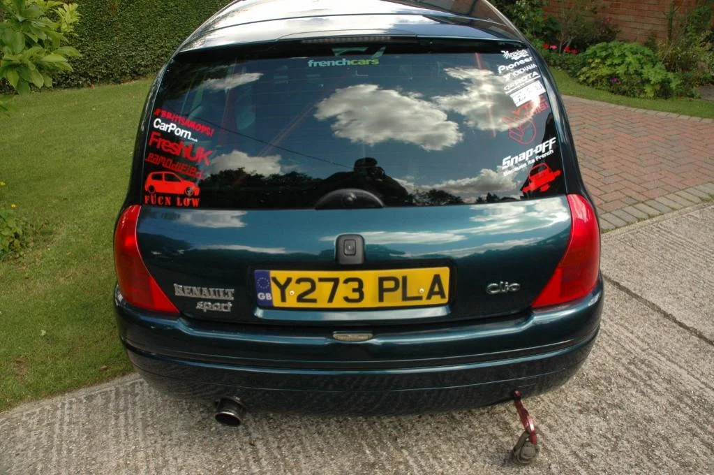

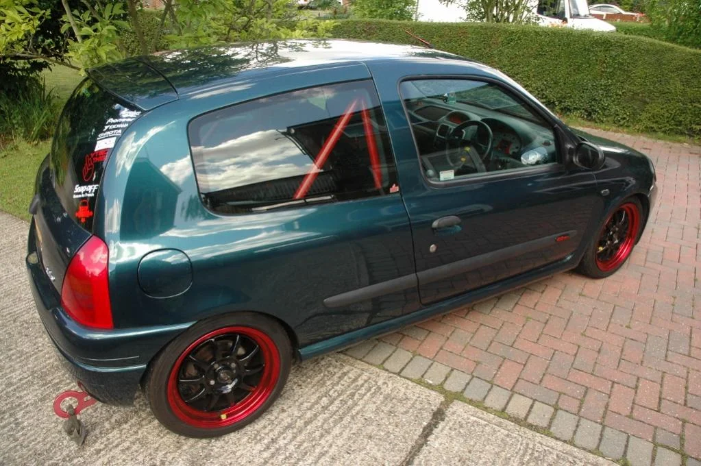

Hi new to cliosport just wondering what people thought of my 172 exclusive currently running 205.8 bhp

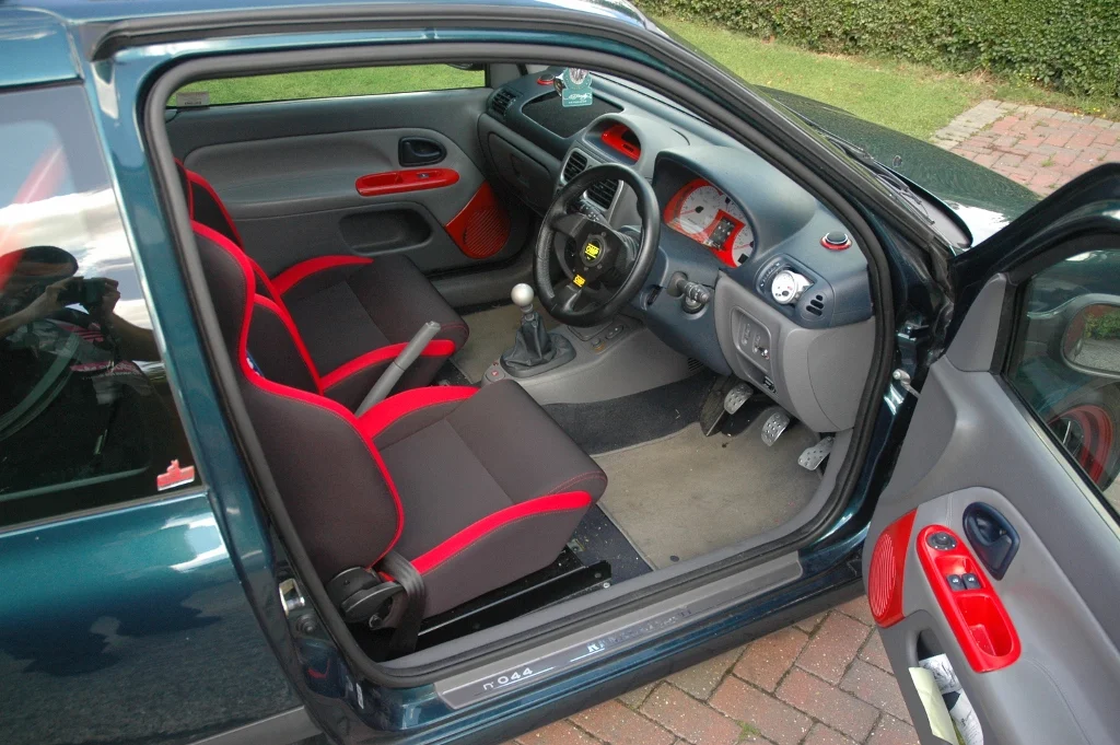

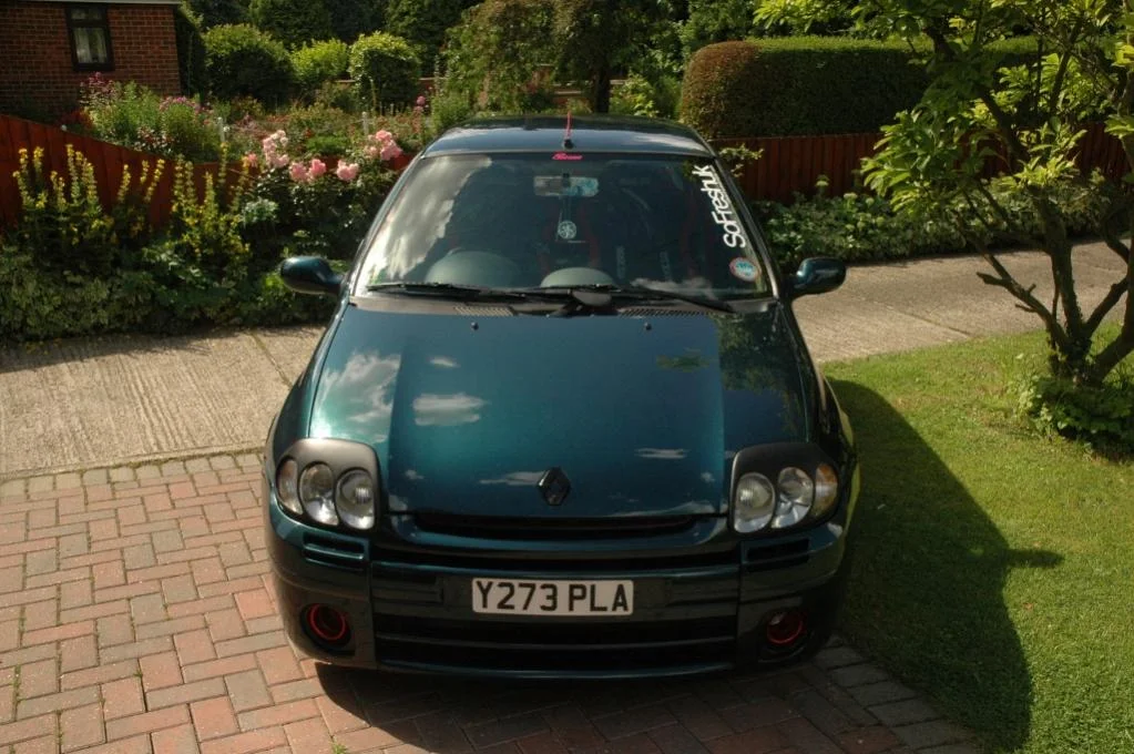

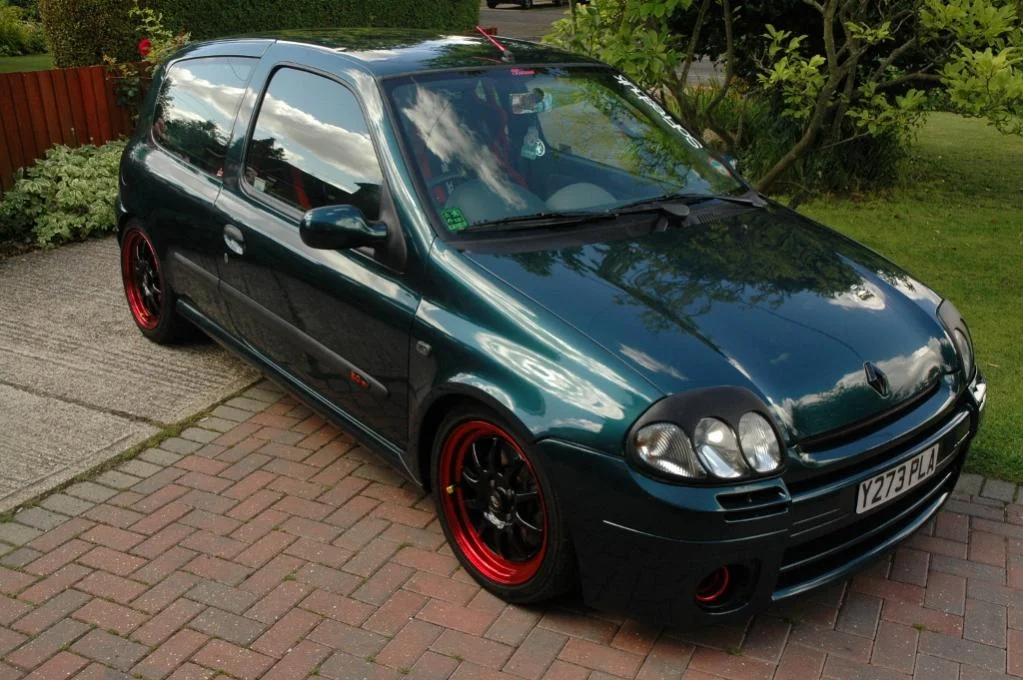

Hi and welcome from one Exclusive owner to another :)

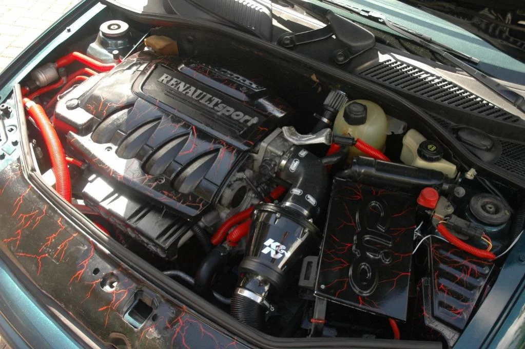

Wow thats impressive power on a standard inlet! What cams are you running? Im guessing headwork has been done too?
I personally do not like the headlights, stickers and all the red inside but the rest of the car looks great :)
Welcome to CS!
What mods do you have to get the power up and what suspension setup are you using?
Styling Isn't to my taste, a bit lairy for me with the red details on the alloys and interior.
Is it a daily driver or mostly for track?
Sure this was in French cars mag couple of editions ago...
Its been in Fast Car too.
The headlight cover thingies need losing and think the wheels need losing the red. Maybe do them the same colour as the car.
Red and green should never be seen!
Yea its been in both mags. Iv got a ktec decat and cat back system, k and n apollo filter and a custom map from Engine dynamics. Nothing else engine wise yet.
Ah.
Unfortunately matey that won't be that high power output.
Unfortunately most rolling roads over read, as there is no possible way you could have gained near 40bhp from a filter, exhaust and a map - most cars with throttle bodies only touch circa 200 bhp.
I would imagine yours will be circa 180bhp if it's a good one, to break over 190 bhp you require cams, or a better induction route, ie throttle bodies or RS2.
They also tend to be around 165-168 bhp as standard, as the 172 is PS rather than bhp.
So take the results with a pinch of salt, as long as you're happy thats all that matters :)
