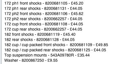

hello, i know this has been posted several times but i just want to be assure that i dont waste my money.
i have got a 172 ff non cup. im living in the netherlands where there is no 172 cup only 182 cup.
so i have got 3 questions.
are the cup shocks a good upgrade of my car instead of the original non cup shocks? do i feel the difference in cornering ? i tested my shocks once and they where 70-80% by my know. and are the frontshocks really 15% stiffer then non cups? and the rears are the same right? so to be short will it work on my my car and will it make the handling better? second question is: what kind of springs should i use? someone said to me to only change the shocks and hold the origanl springs. but i was thinking of eibach pro kit springs. are these a good match with the shocks? or are there 2 original renault cup springs?(there are right saw them?) maybe you have a suggestion for me ? and 3 qeustion is what are the partnumbers of the shocks(cause here in the netherlands we dont have 172 cups so no shocks to order to via my chassisnumber) i have got this link i dont know if its right? maybe you have got 2 other suggestions in handling wise the are all welkom. ans one last question are the 172 cup only different on a 172 ff by just springs and shocks? or have they to got different arb? or wishbones? hopefully someone finally helps me after posting this 4 times ! down this is my car mods: bbs RX214 16" (with renault caps) , renault splitter (dont know what model) , megane 3 aerial, and not in pic silvervisions. i just start this thread to get an answer and cause i dont really have a project i delete after it (i think) i just want an answer (so help?!)

I think everything for a cup will fit on a non cup its all the same car at end of the day although the washer u want for the top strut mounts is cheap on ebay from a company called mad they sell both for £6

Marco I had a standard 172 a few years ago on 54k. I replaced the shocks for new cup shocks, top mounts & cooksport springs and it did help improve the handling, Cooksports sits lower than the eibach pro springs tho so I suppose it depends on what you want from the car.

thanks for the reply's finally. are the partnumbers the right one that i got ? ans what is all different 172 vs 172 cup (shocks springs further? ) i see strut mounts ? dont what that is <(topmount?) wishbones ? arb? further i saw some prices of the cup shocks in your country (UK). they where cheap as s**t if i want to order cup or original i n holland(where i live) i need to pay much more. (but thats something else of course...)

but i want to nkow whats differents between a 172 and a 172 cup supspension wise. i think its shocks and springs. but have they 2 got different wishbones or top mounts? further is it a good upgrade from a 172(normal supspension ) to 172 cup dampers ? not that it makes it worse.. hopefully you gonna help me couse nobody helps me..

and some people say that the rear dampers of a cup ar 2 different but most people say they are the same....
