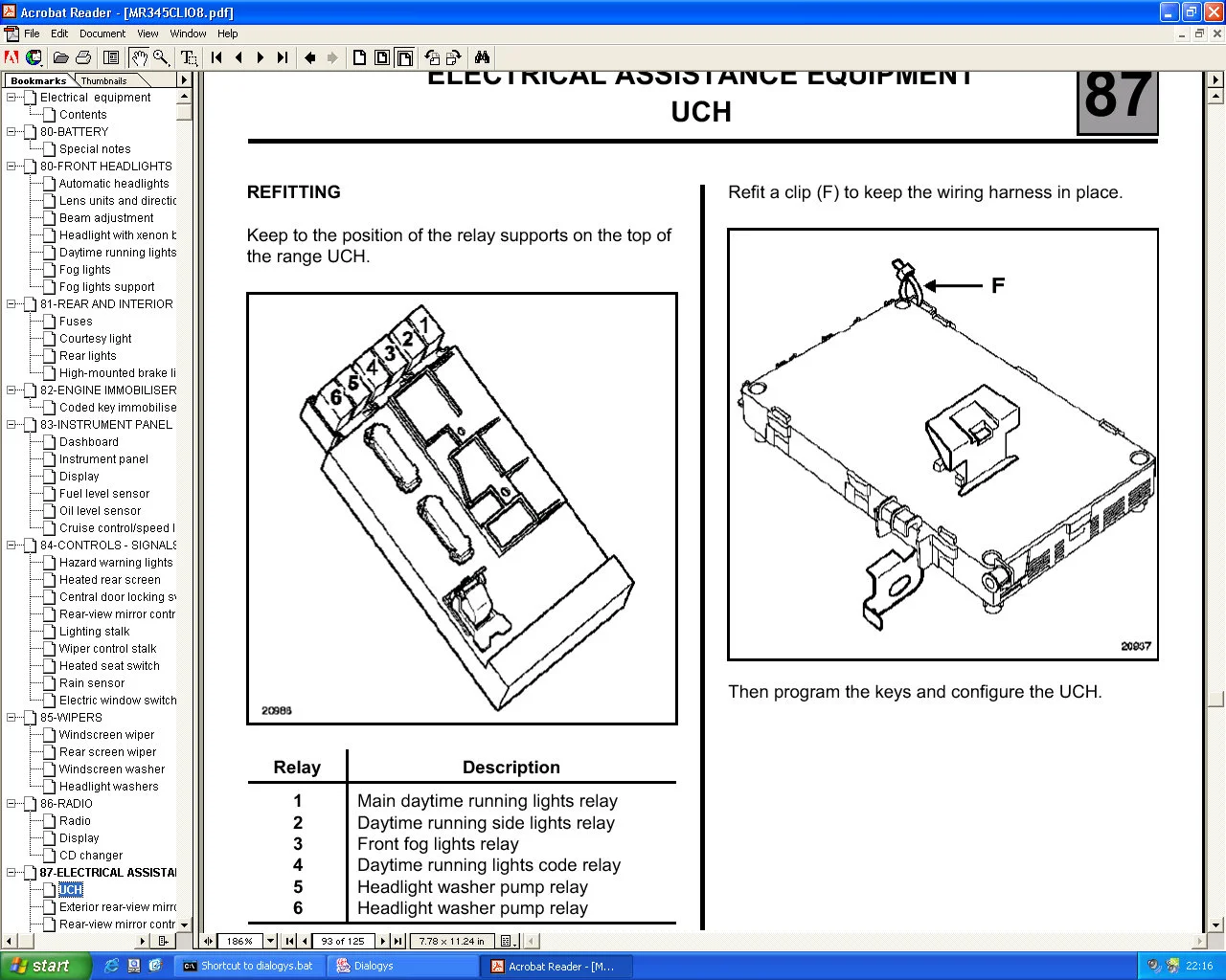

Easiest way is to swap the two foglight relays and see if the problem swaps too. If you get in the passenger footwell and look up you'll see them.

Still if you've got them you'd want them working. Would wind me up big style, give me a minute to install dialogys and i'll see if I can find which one is the fog light one.
There you go, just swap it with another light relay.
