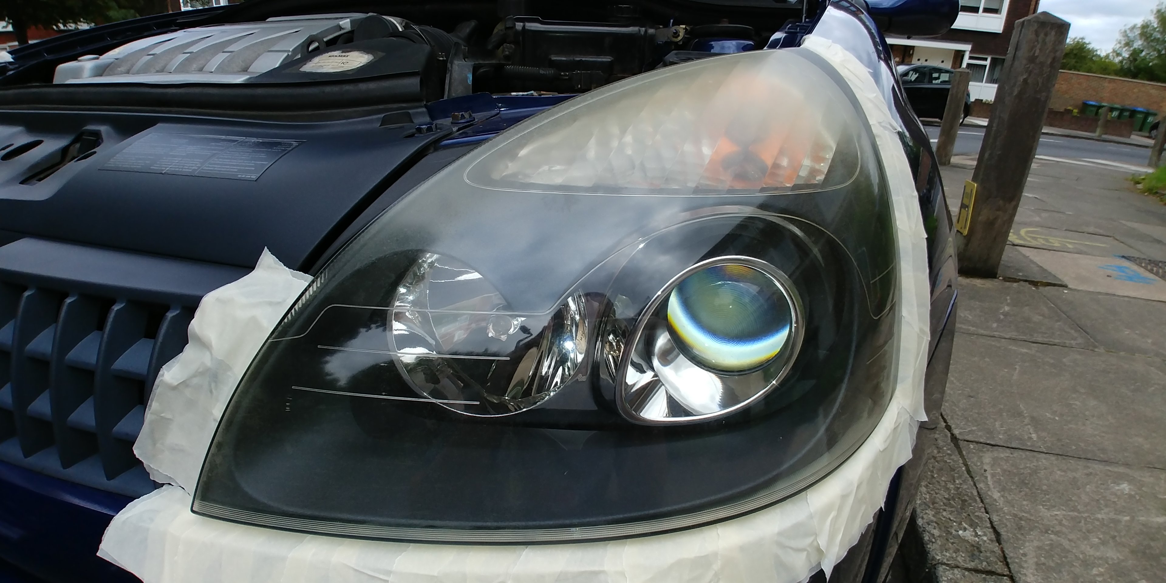

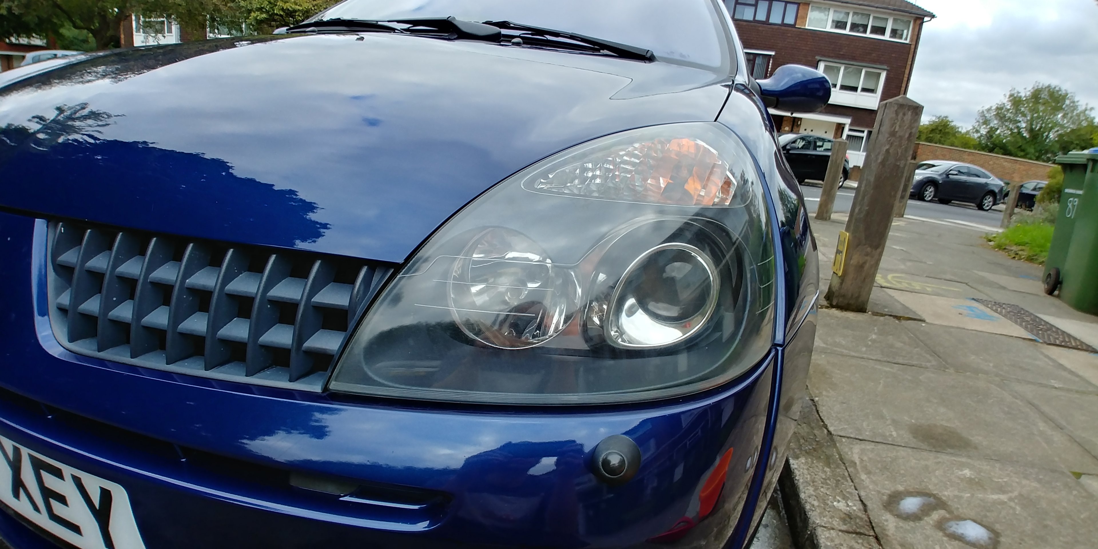

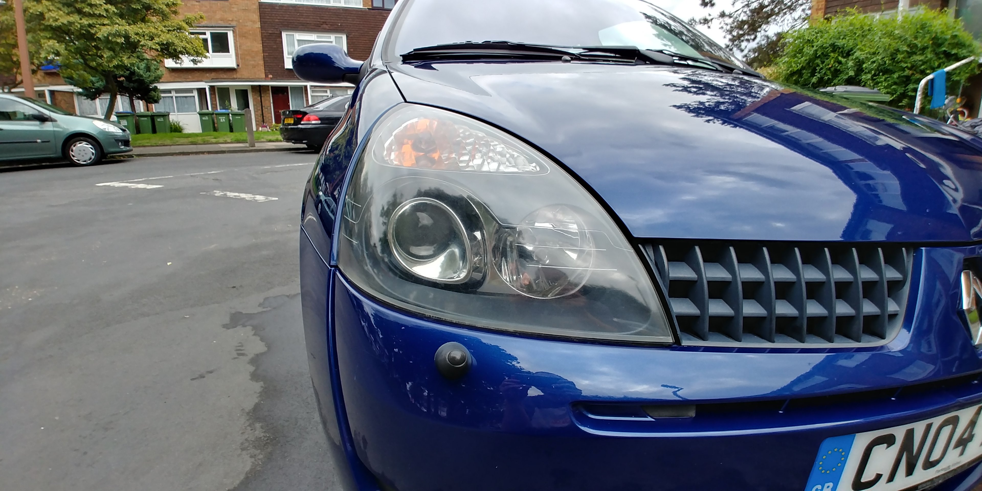

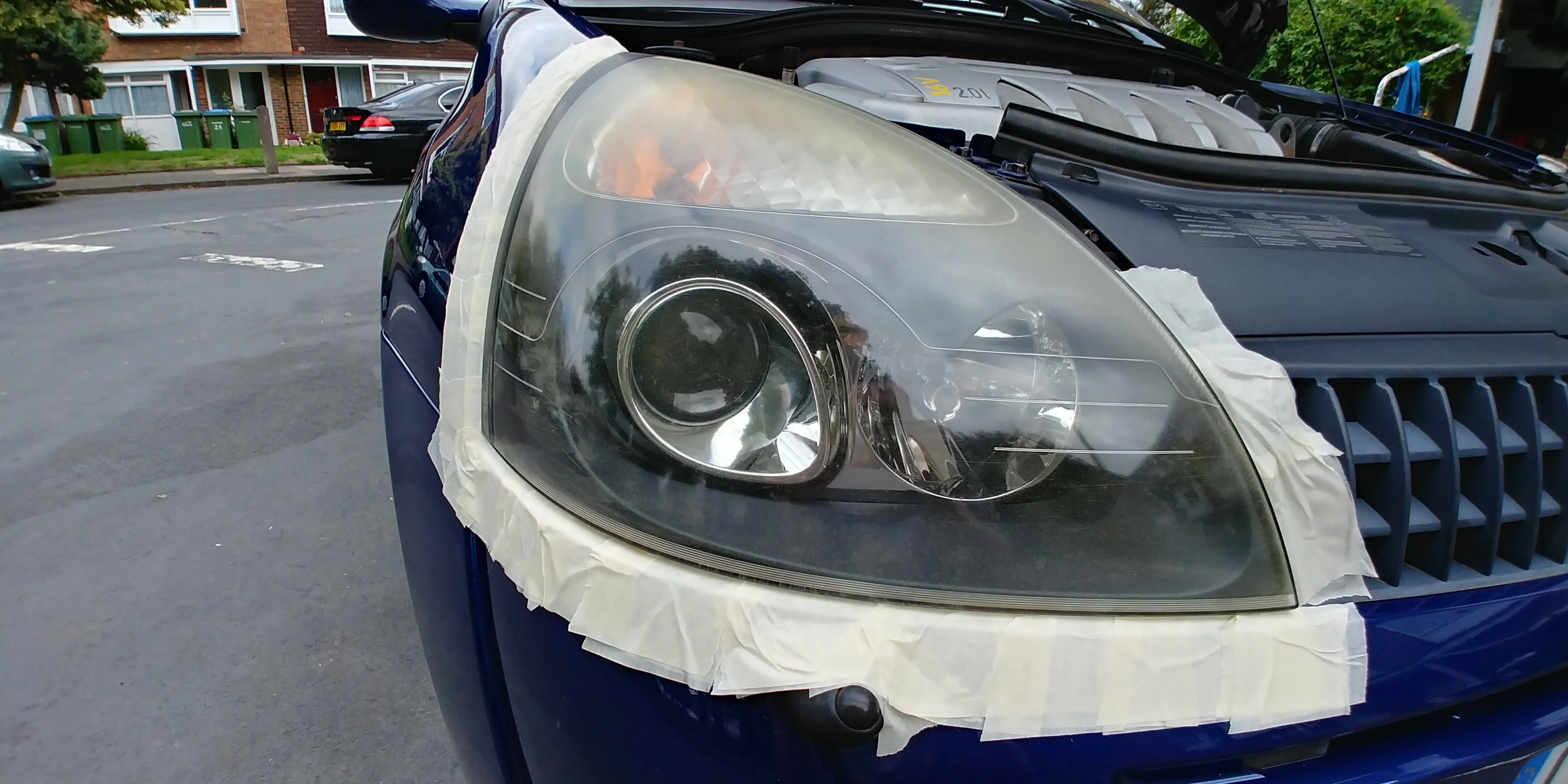

As you all probably know, the headlight units on the 1*2's don't take kindly to UV light. So whilst I was in the mood after giving the car a service, I thought I would have a crack at sorting out my headlight units. Mine had gone really yellow at the top to the point the indicator lamp could hardly been seen when it was flashing. I went and got the Automglym kit from Halfords (with the trusty trade card too!) and got on with it.
I think the kit is dead easy to use, you just need to have a bit of patience.
Here are a few pictures (before and after of each side, although the before pics don't make it look as bad as they actually were). Anyone thinking of using the kit or not feeling too confident about taking sand paper to bits of their car, I would give this the thumbs up. Definitely worth a go!

Headlights look spot on now!

Good results. I used meguiars kit and doesn't come up as well as that, nice one
I looked at that one as well, but I thought sanding would give a better cut/finish. Not gonna lie though, I was bricking it having to sand the units down though!
