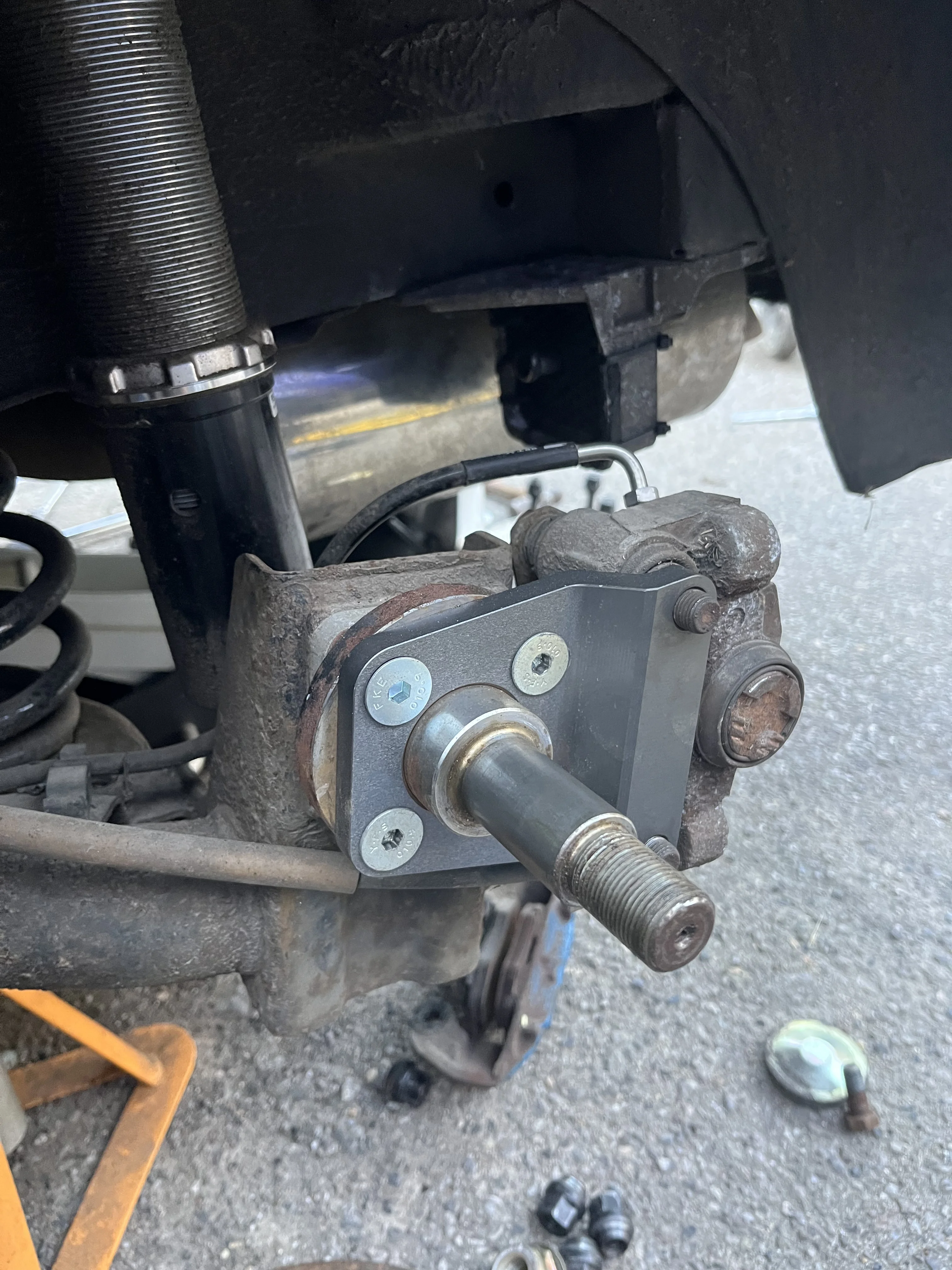

Now to the current bits. This weekend I fitted some hub spaces on the rear with camber shims to fill the arches a little better got given these so seemed rude not to. Have also just sent my Quaife up to mark to get put into a gearbox. All being well, that will be fitted in the next week weeks along with a ttv flywheel and a new clutch. Need to order some 10mm spacers for the front along with studs and wheel nuts are pi**ing me off. I’ve bought a new set of 2118’s which will become my main wheels and the superleggeras will become track wheels. Should picking those up within the couple of weeks. I’m also waiting on my mate to get some bits done to his car so I can pinch his front hubs. Will get these sent up to Bridgecraft engineering to get the machining work done then get the roll centre kit fitted and get the alignment done again. I think that’s me up to date at the moment. Once these bits are on I’ll book another track day hopefully not to far away. Have got a baby due this week so that might slow progress a little.

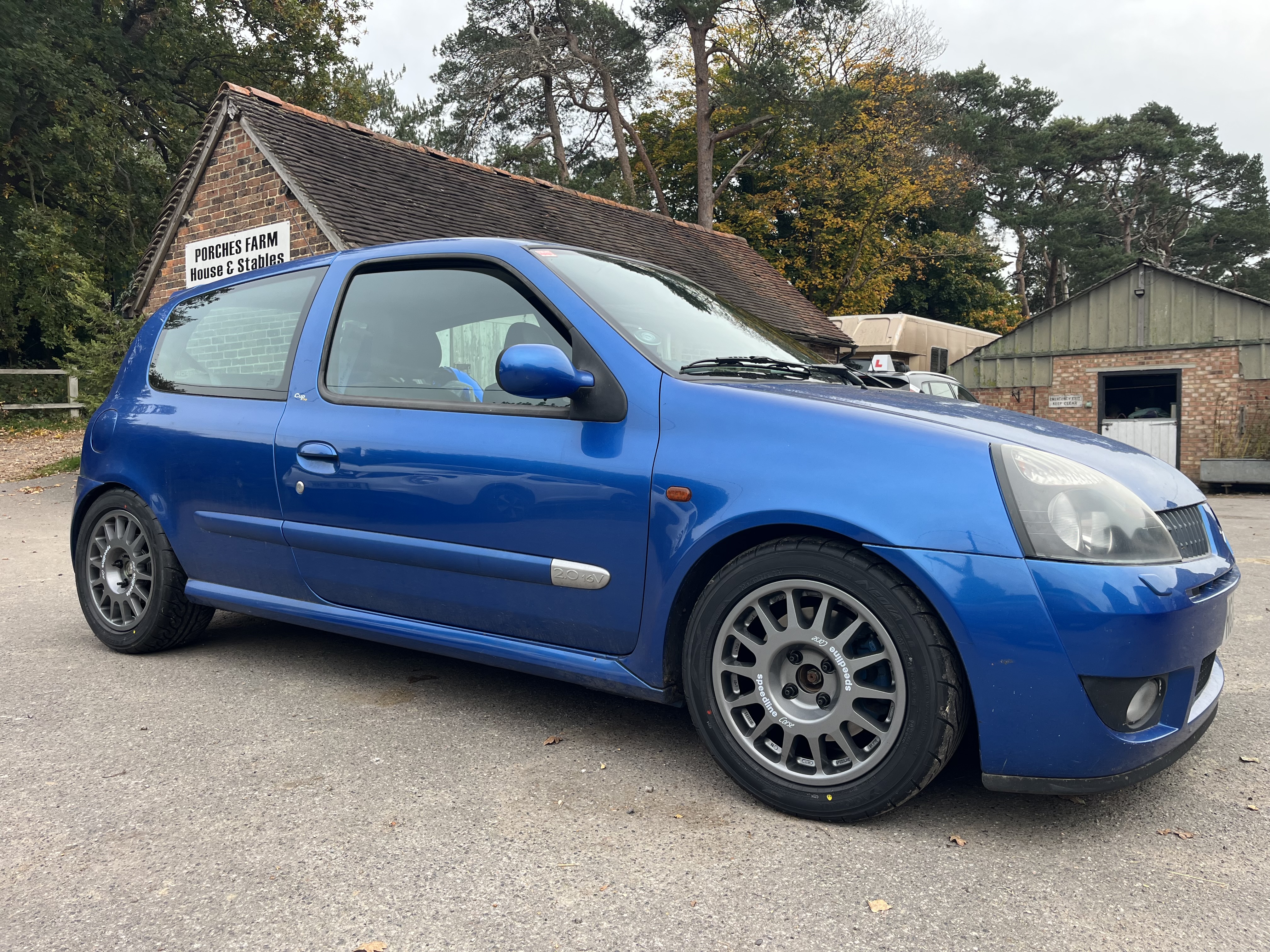

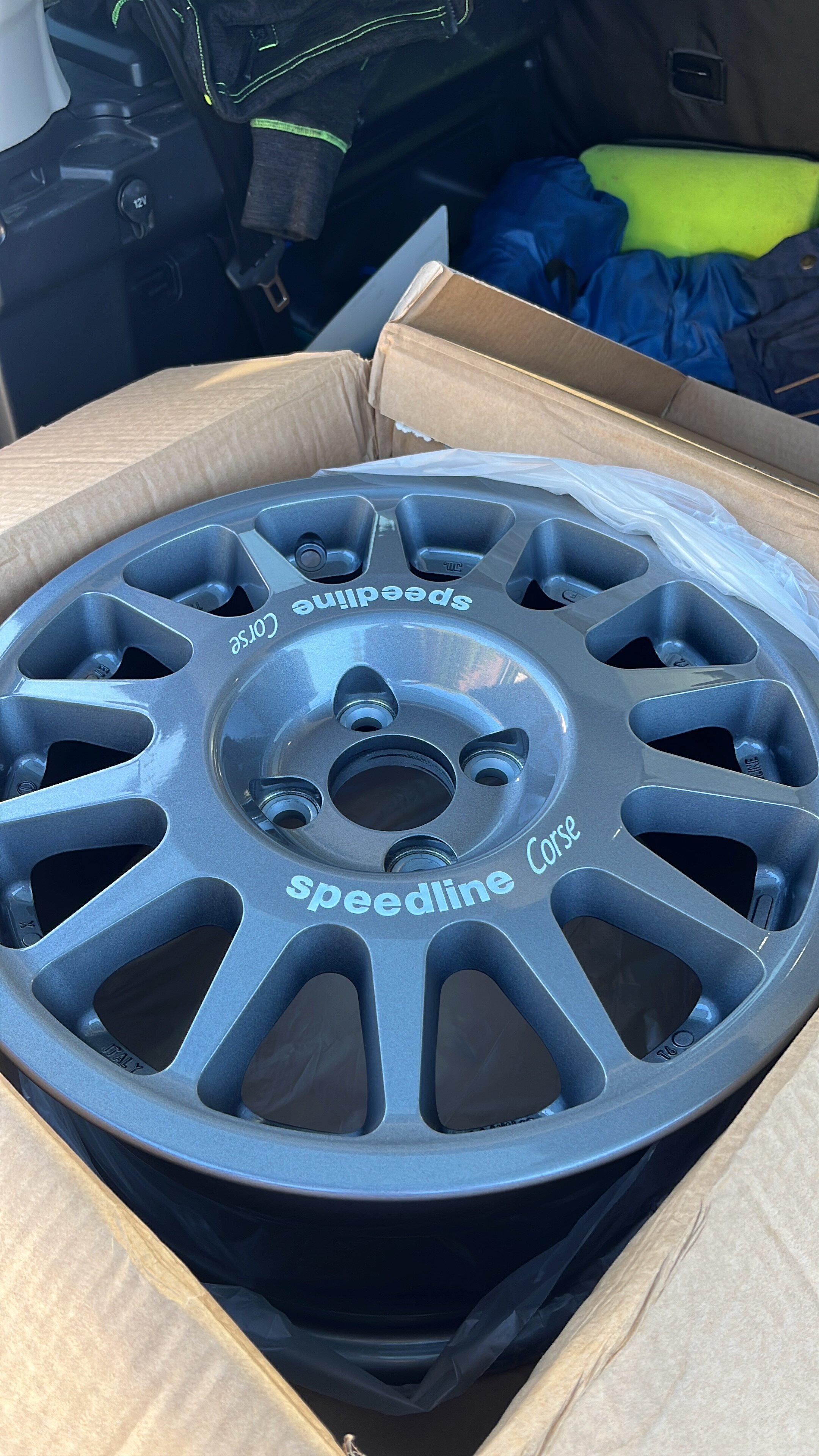

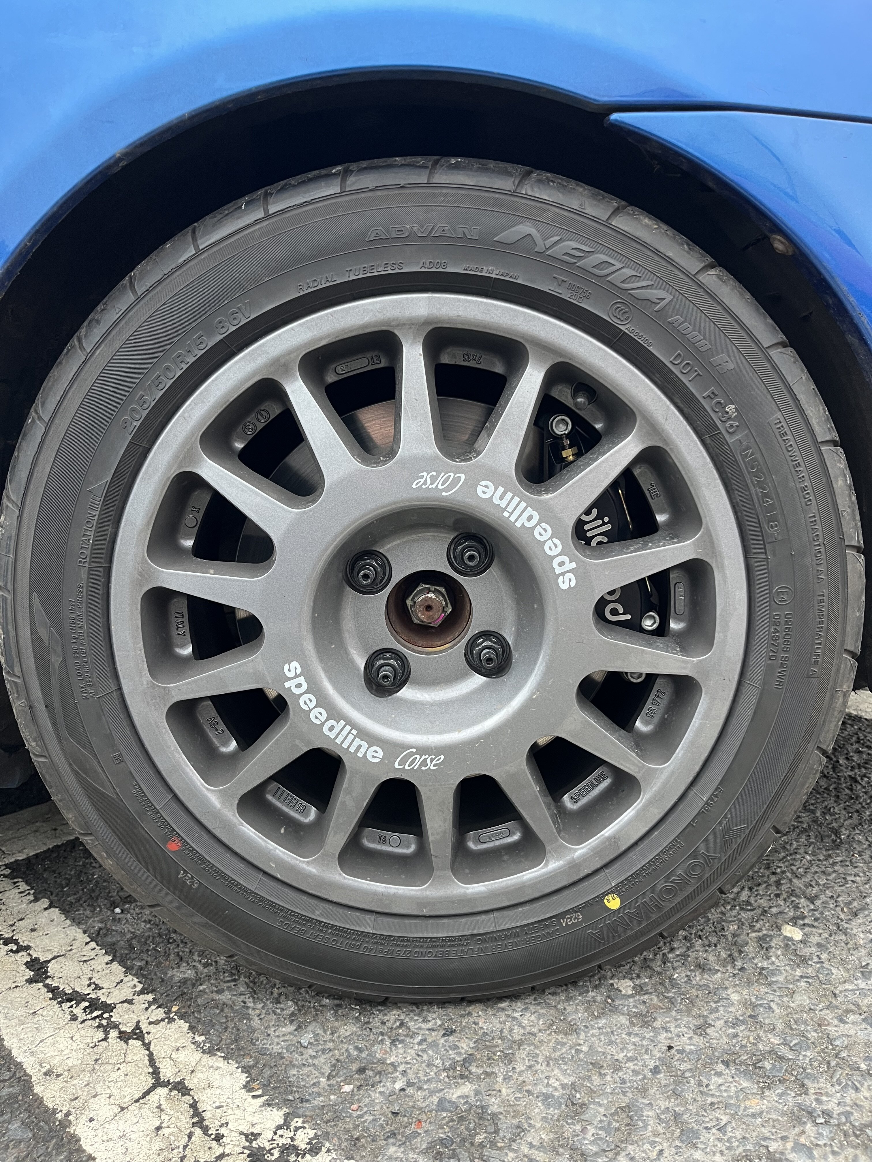

Wheels are et43 with 205 tyres and will have 10mm spacers. Does anyone know of any rubbing issues with that size? Will probably look to get a set of AR1’s for the superleggeras and these will become my track day wheels. Also picked up a PMS shifter from the same member. Hopefully fitting that this weekend and then begins complaining about the rattling.
I run those wheels on 195's but without spacers, you shouldn't have any problems with rubbing.

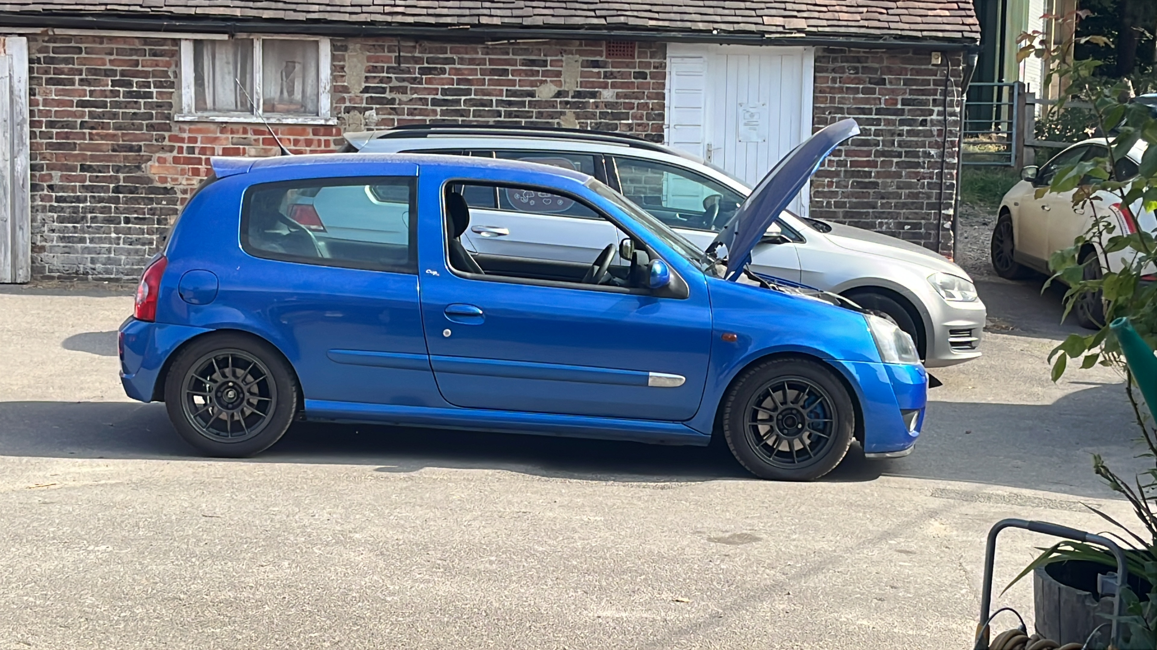

First thing for this morning was fitting a turbo blanket, not sure if it’s the right thing to do but trying to manage heat as best I can. There is little to no room to get the turbo blanket in place then the much harder job of getting the springs in place to hold it on. After about an hour of swearing, crushing fingers, and cutting my hands to pieces it was fitted. Yet to drive it to see if it actually makes any difference. Next on the list was sorting the leak on the Advocult power steering line. After trying to squash my arm through what left of my arch liner I decided removing the front bumper would be the easier option. With the bumper removed access to the high pressure line was better but still not perfect. I removed the line from the pump and replaced the copper washers on the banjo bolt with dowty washers. These seemed to be enough to stop the weep from the banjo bolt so a success. I was getting ready to rip the PAS out of the car all together. Final thing for the day was starting to strip the rear seats out ready for when I can find a cage to fit. All the bolt are out now, just need to removed the seatbelts tomorrow, then free up some money for a cage at some point. Im still on the look out for an MSV /caged laser bolt in cage, ideally not for the £1000 they want for a new one. With a good couple of bits off my list today I’ve only really got to get the car cleaned and I’m good to go. Has to go back to my mate to get the subframe notched as the knocking is driving me mad. He’s also going to fit the Wilwoods for me while he’s got it. I’m perfectly capable of doing it at home it’s just a lot easier for me if he does it. Lazy I know, but the two small children make every job two or three times longer than it should be.
Little update from me. Car went back to my mate today for a quick nut and bolt check and to notch the subframe before spa. Ever since the turbo kit was fitted the exhaust has rattled on the subframe and drove me mad. Thankfully he worked his magic and the rattle is gone, just get the vibrations from everything else now with the solid mounts. Also got him to fit the Jamsport Wilwood kit that I got from another member. Yes I could do it at home but I’m being lazy and got him to do it while it was on a ramp. The brakes are probably massive over kill but was amazed how much speed you can scrub very very quickly now. Also removed the rear seat if I haven’t mentioned that already for when I eventually get a cage.

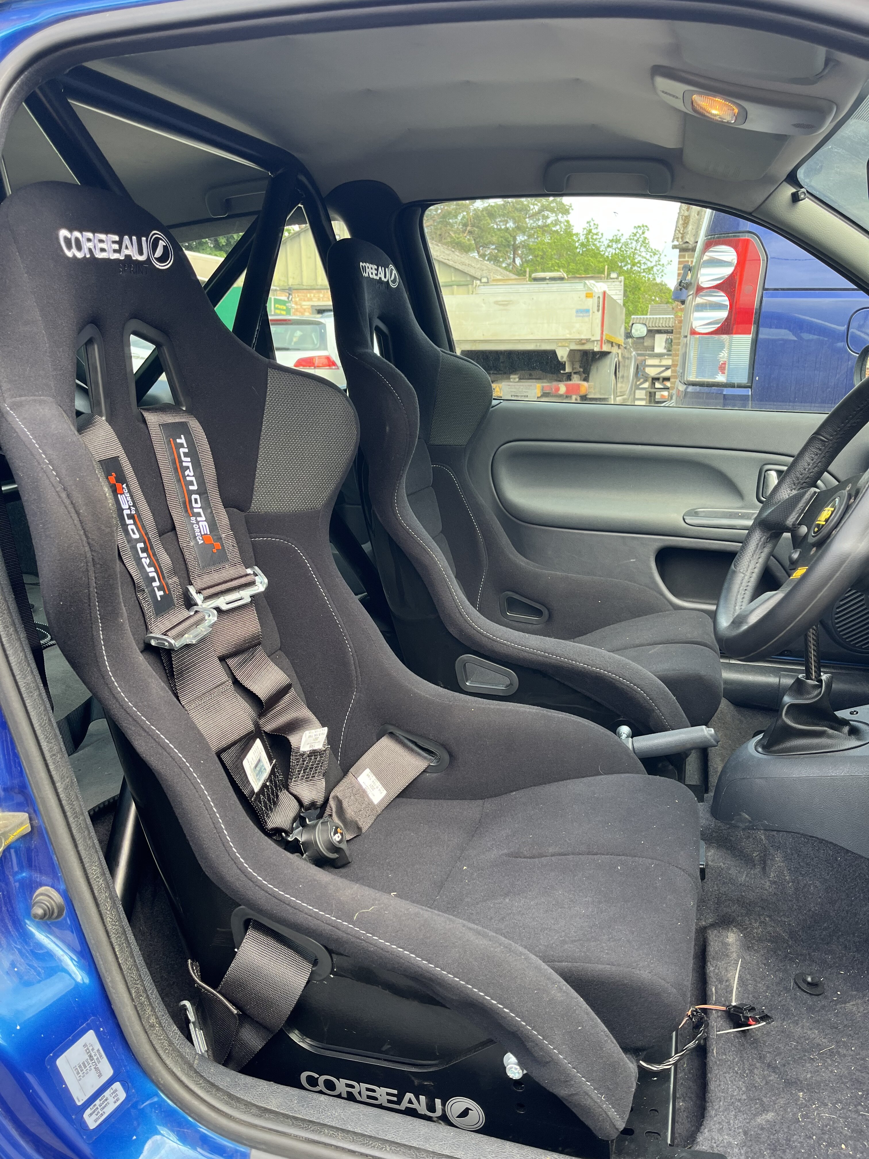

I’ve also been in a mad rush to try and find a buckets seat. What I’ve discovered is the being 6’ 4”, 88kg and 40cm wide hips I’m not the same shape as whoever they make buckets seats for. Tried to get some Corbeau pro sports but they’re 1-2 week wait and we go next Saturday. Have decided just to leave the cup seat in for the minute and will carry on my search when I get home. If anyone has any suggestions of a seat with a 40cm wide base please feel free to drop them below.
I had a bimarco futura in my MR2 years ago, was a pretty roomy seat, ideal for bigger guys. I think the cobra 3 is the current version

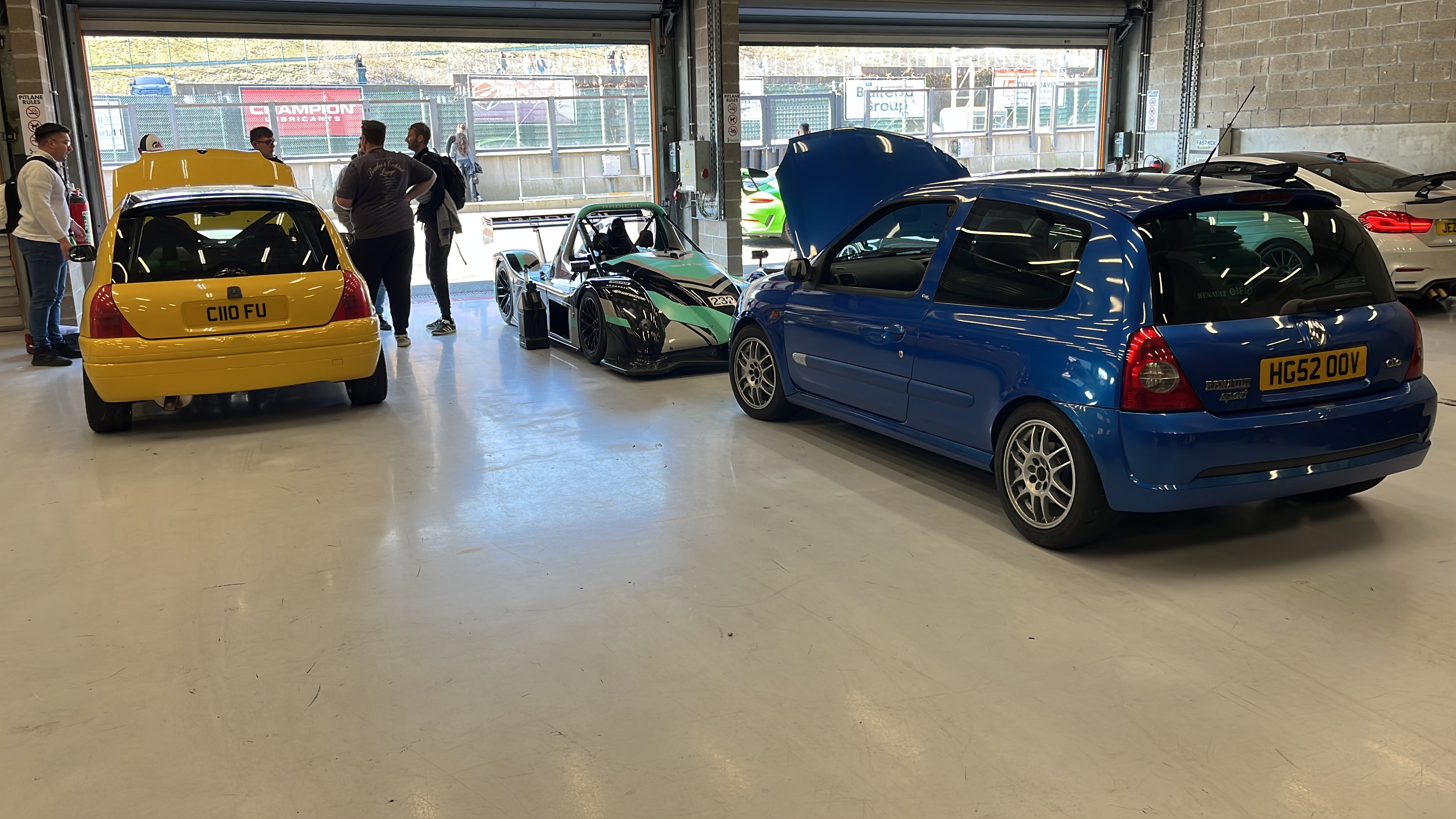

The yellow clio and radical were booked for both days. I stupidly had only booked for one. Having a garage made a big difference, driving straight onto the pit lane saved a lot of time over the day. Heard from some other people that the Sunday had been over sold by quite a lot. Meant the circuit was always very busy and there was quite a lot of queueing to get onto track. Even with all the queues I was still managing a 15-20 minute every hour then leaving it to cool for at least 20 minutes. Even on hot laps engine coolant never got much above half way on the gauge so very happy with that. Was a big concern that it was going to spend most of its time over heating. Next on the list of bits to get done is for an oil temp & pressure gauge so I can keep an eye on what that’s doing.

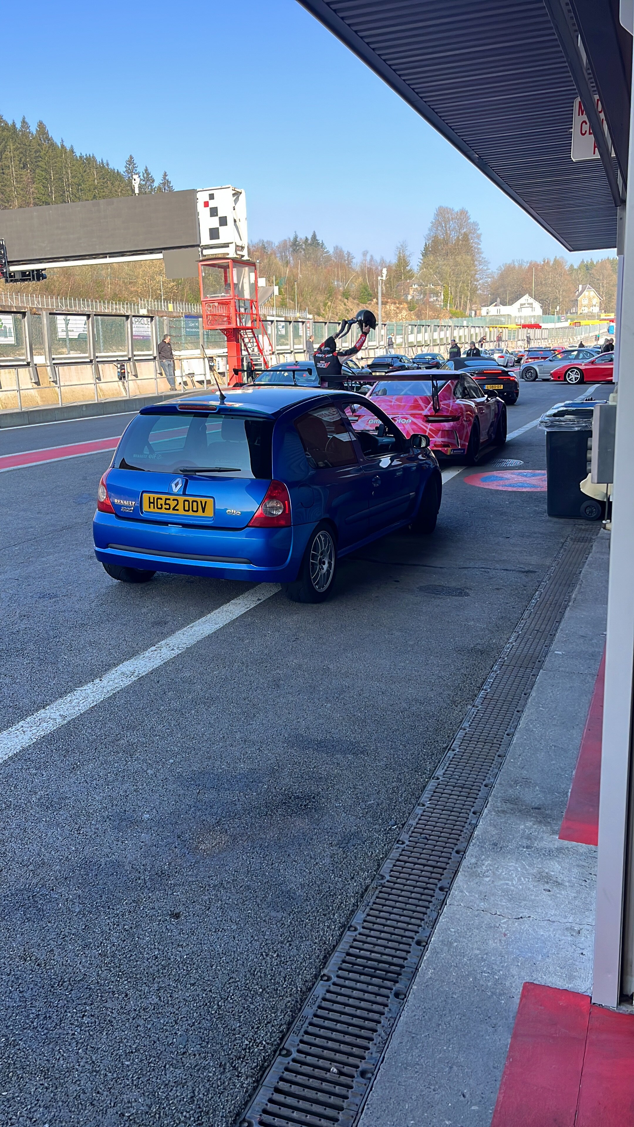

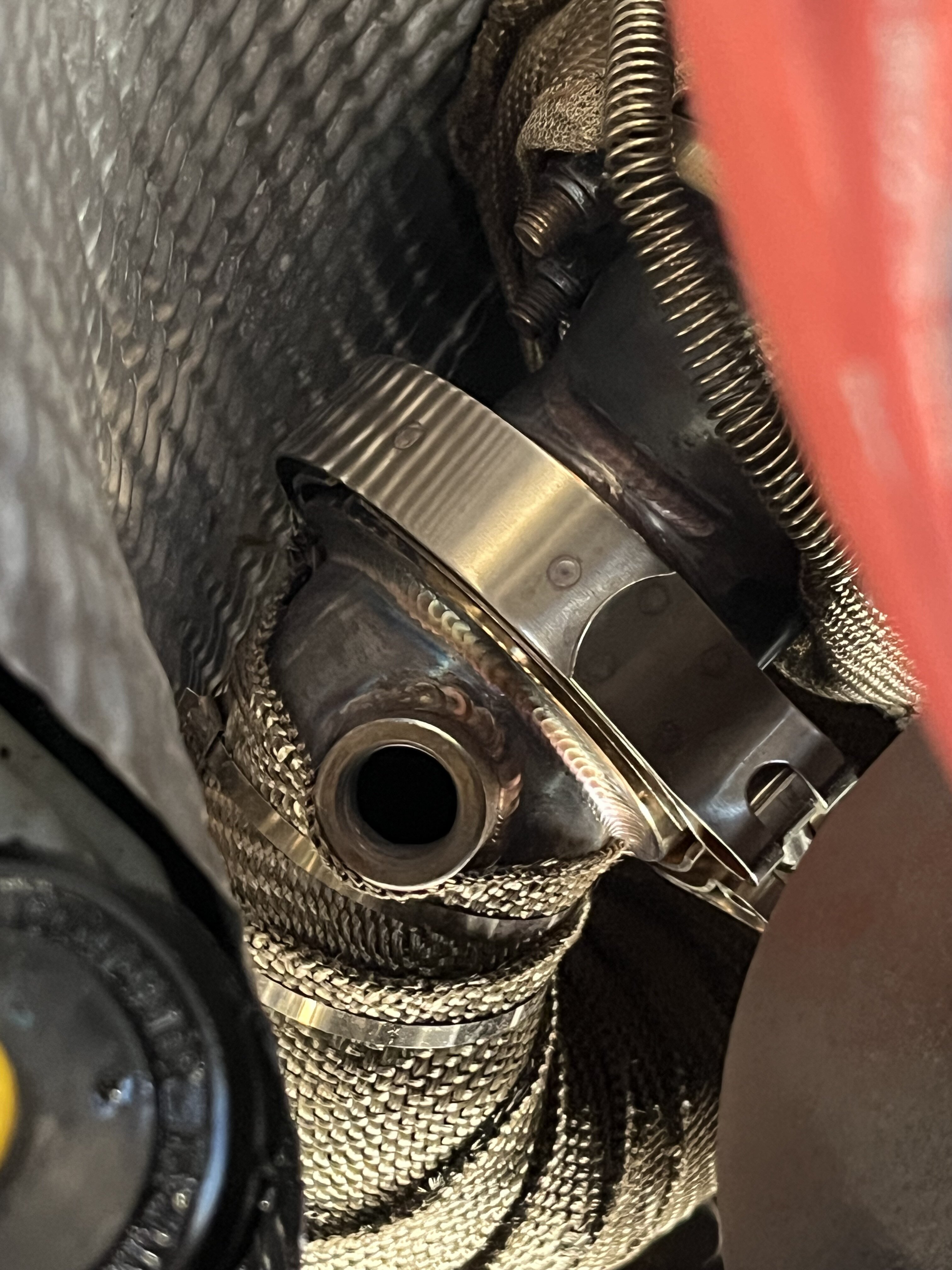

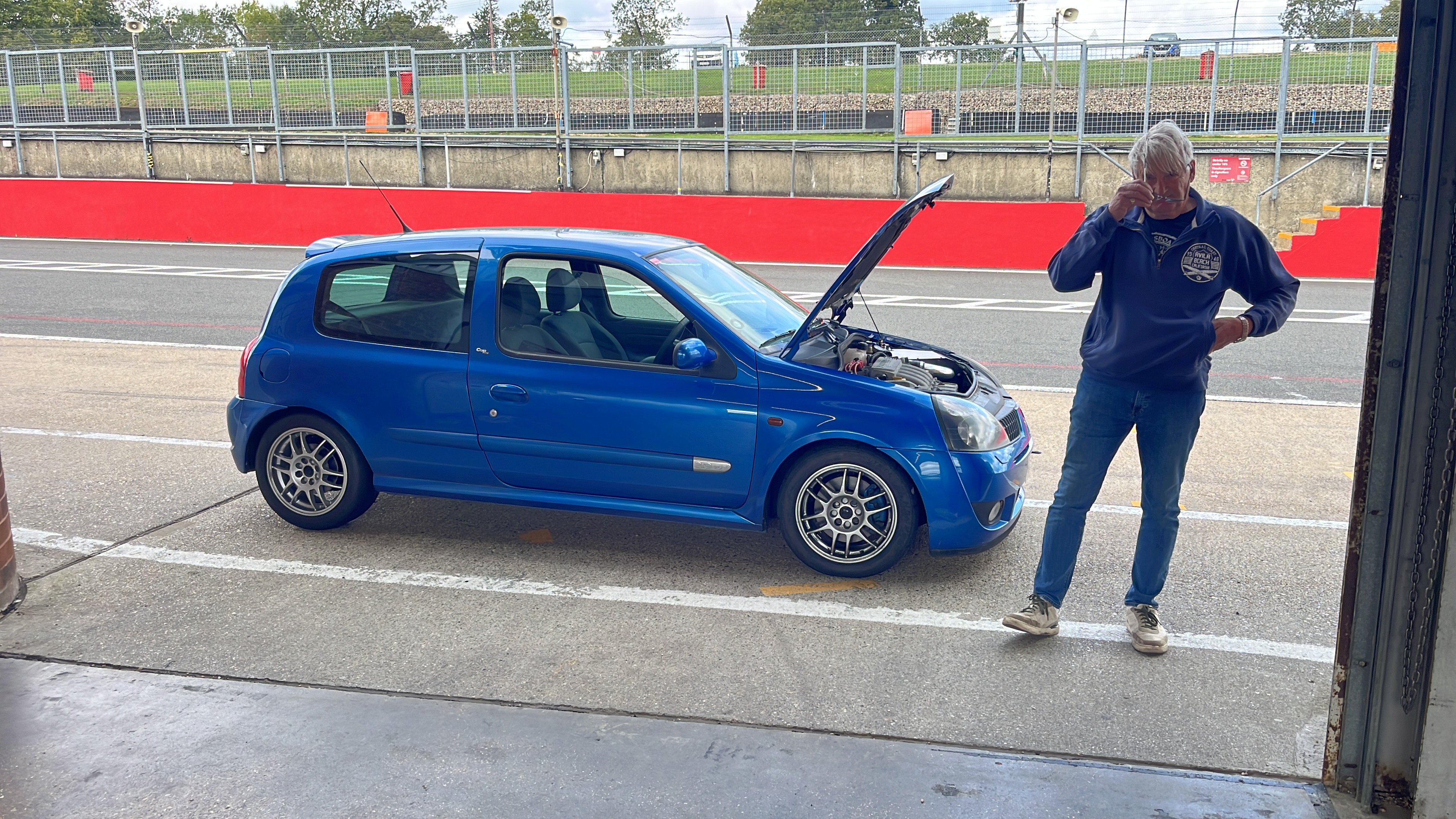

Only had one minor issue all day. Half way through the afternoon session one of the exhaust bungs came loose and now lives somewhere at spa circuit.
No real issues caused. Caught it early enough so nothing had a chance to melt. Fortunately after asking everyone I could find to ask there was a very helpful Dutch team with a bmw support lorry. Turns out a bmw diff drain is very similar to an exhaust bung so with that wound in we could carry on for the rest of the day.
With the first day going so well I was itching to try and get a drive on the second day. After asking around in the pits seemed a lot of people had the same idea so nothing worked out. In the end the yellow Clio kept loosing its exhaust studs so my friend gave me his number to drive the afternoon session. The track was much quieter today so that lent itself to a lot more track time for me and the can again ran perfectly for the rest of the day. Only thing that did become apparent by the end of the day was the 6 year old multiple day ar1’s were very much on their last legs. As the day went on they seemed to loose their grip much earlier into each session I did.
Packed up around 5, calling it quits early. Had a good day and didn’t want to push my luck. Had two trailers to get loaded plus all the other bits we had brought down. The bonus to having a garage is you can leave it all there so you’re ready to go on the second day.
Early dinner then bed. Had the train booked for 10.40 am. With both my friends towing they wanted to leave at 5am to allow the extra time to get back to Calais. I also left at 5 but managed to get to the tunnel by 8.45 and with luck on my side got the 9.15 train and back home by 10.30. All in a very fun trip and can’t wait to do it again next year.

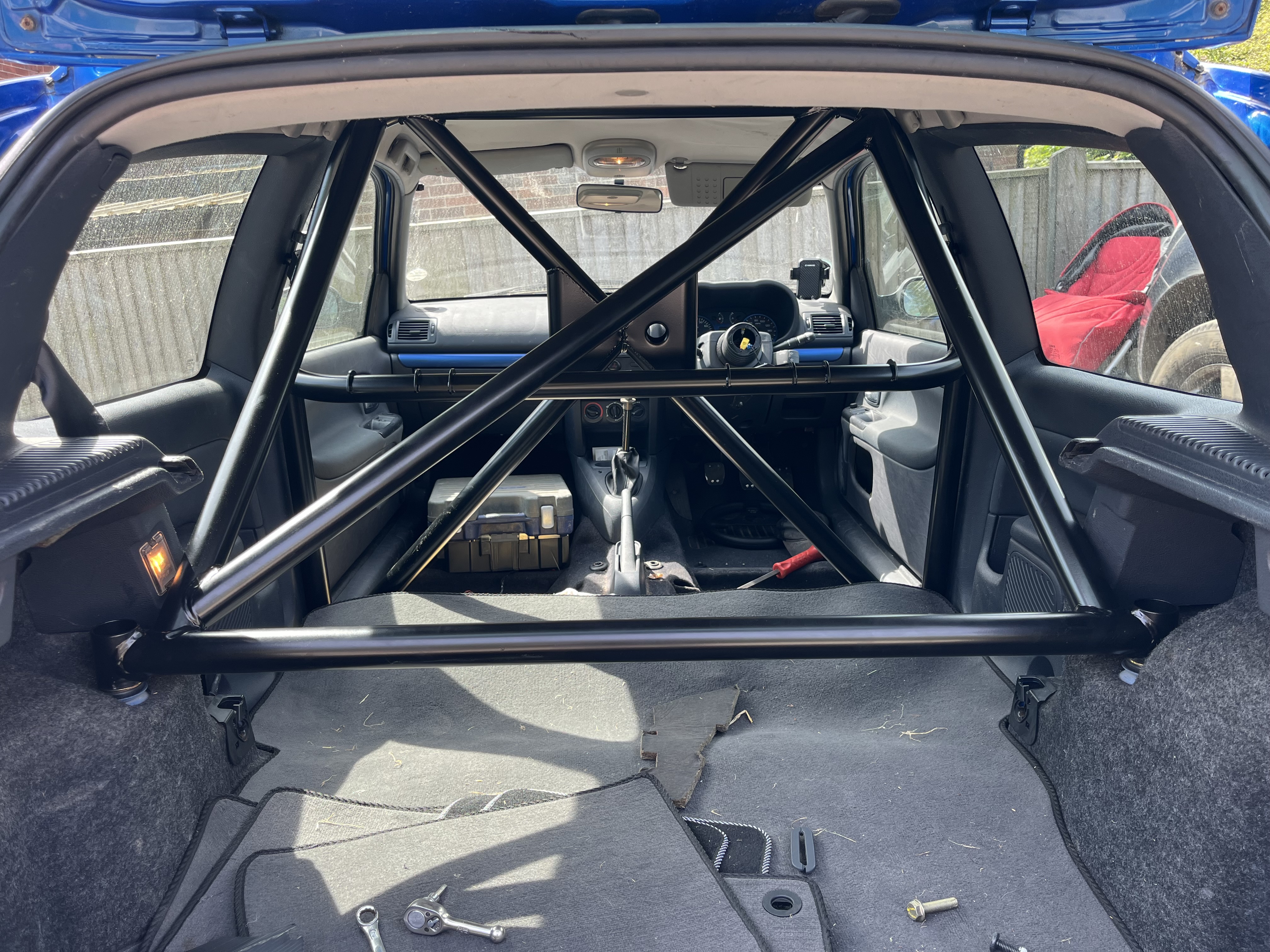

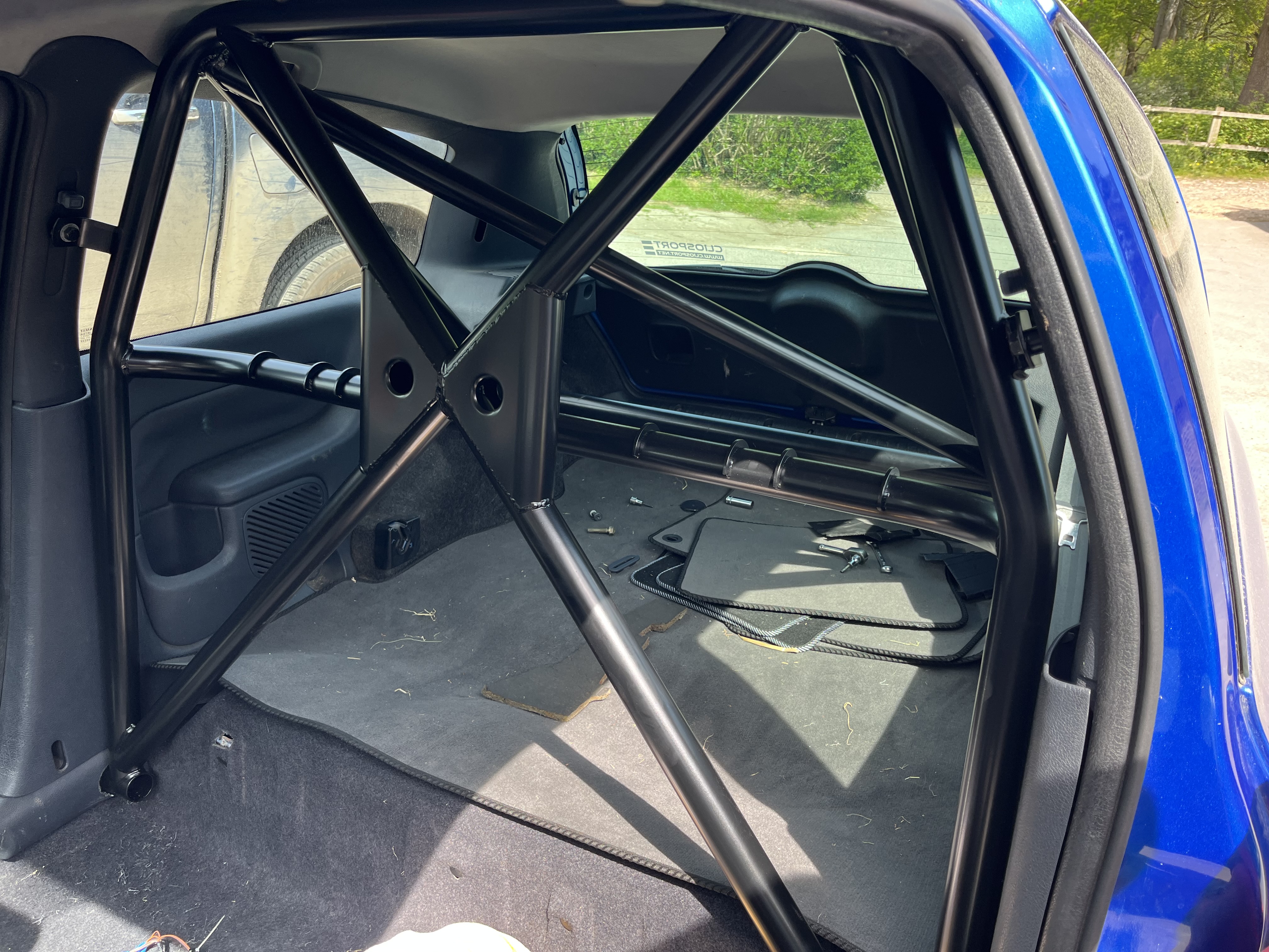

Little update. Friday after work I manage to get the drivers seat and passenger seats stripped out of the car. I wasn’t the first person to be under there as something terrible has happened to the wiring. Ends had badly crimped and as I rocked the seat back everything pulled out of the connectors so need to figure out what to do there. May need to find someone local with a clip tool to get them turned off permanently. If you do have a clip tool near Sussex can you shoot me a PM. Bought a cage from Rob Cheesborough, I know a few people have got cages from him. I wanted one that was 100% bolt in so when I find out the cars a rot box or I smash it up I can unbolt everything and swap it with little fuss. The cage I bought was a cancelled order. Only problem was it was yellow. Had hoped I could live with it being yellow but when it turned up it then went straight to the powder coaters to be redone satin black. Picked the cage back up this week so called a mate this morning to give me a hand lifting it in. With it having the x in the main hoop and a harness bar it adds quite a bit of weight. Going in with blind confidence that others have fitted these single handedly I thought we’ll breeze this. How wrong I was. Even having looked at all the pictures of then being fitted and asking Rob the techniques still got it wrong. Was a lot of trial and error getting it in until we realised we were being stupid and after that it was very straight forward. Next it’s the two bits over the rear struts we set to mounting the other four points. Was a bit of a fight to get one bolt in but all went well.
After this I got the caged snugged up was onto the Jon foz frames. These all bolted in with very little fuss. Just waiting on the seats to be delivered now.
I've seen a couple of those cages now and they absolutely terrify me.. main hoop mounted with a single bolt each side in single shear, and the rear diagonal bars mounted to the rear shocks .
If you're happy that it's just a 'faux cage' than that's cool, but I wouldn't be expecting it to save my life in a roll over
Bucket seat fitting this weekend. A couple of weeks ago it was a hot afternoon so decided to leave work early and drive to the Corbeau factory. Wanted to place an order on some pro sports but thought I should probably sit in them first before buying. Just as well I did, didn’t like the fit of the seat at all, and ended up buying a sprint x. Fit me better and just felt a lot nicer to sit in. Got the Jon fox frames fitting first which was a piece of cake, really easy and very straight forward. Problems started with the seats and me thinking everything would simply just bolt in. To get the seats and back to where I found comfortable meant I had to drill four new holes, none of that was very hard just quite time consuming to mark, measure, check, drill test fit and so on. With my kids helping this took a lot longer than planned but they were in. Then my planes for mounting the harnesses quickly failed. The seat was mounted back too far to use the original seat belt mount and the brackets I bought to bolt into place didn’t work as there wasn’t the room for them. Fortunately a mate had some of the spreader plates and after a bit more drilling and checking I wasn’t going through the fuel lines or brake lines the eyes were in and the harnesses fitted. Not the quick job I had planned but all worked out in the end.

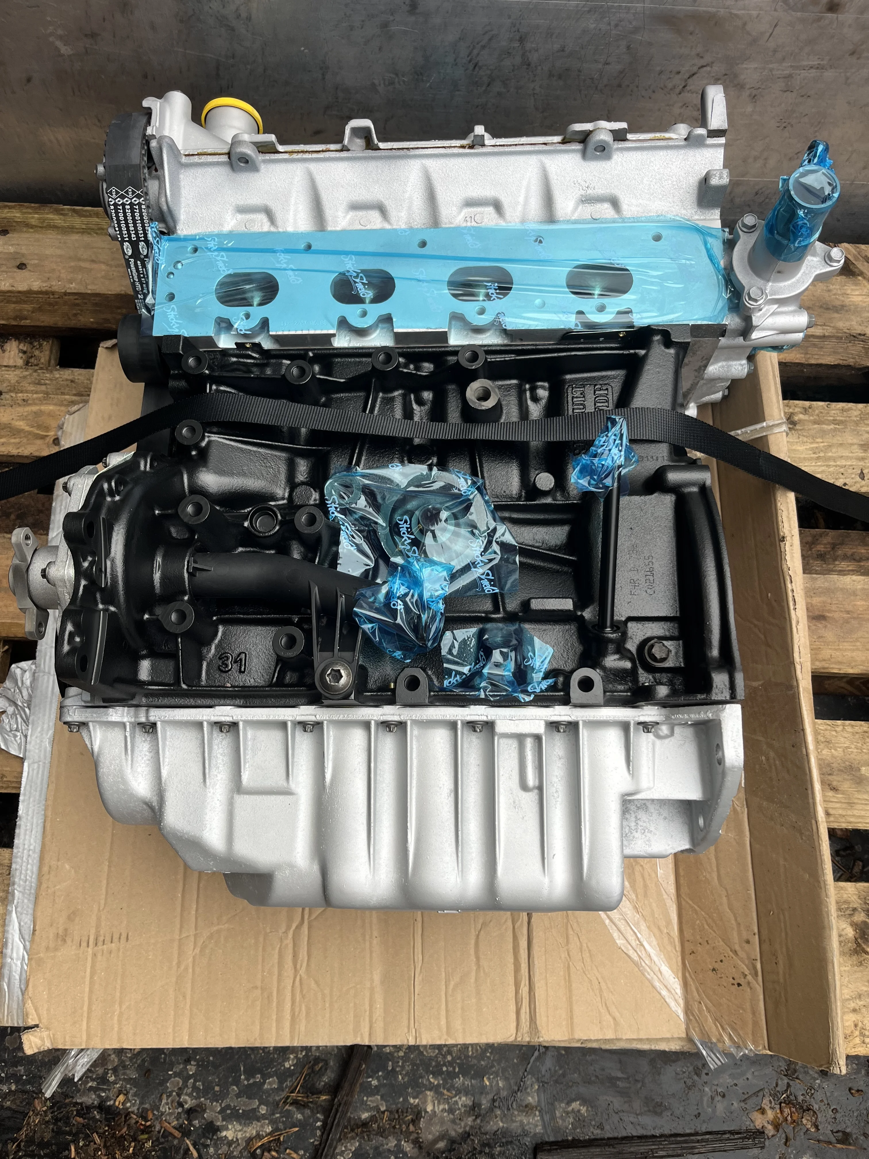

Sourced another engine which was dropped at engine dynamics for a rebuild. The condition was unknown but only needed a usable block, crank, and head. Over the last month the engine was built up with oversized forged pistons, forged rods, one piece valves, uprated springs, arp bolts, etc……
Collected the engine today and dropped over to my mates ready to go into the car. Haven’t really planned what else is going to get done as well as fitting the engine, sort of an evolving plan. So far there’s just plans to move the battery out of the engine bay to make some more room and have a larger radiator made to really keep temps down. Will try and be a bit more proactive with keeping this updated when we get round to starting the swap.
Hopefully have 240 on low boost and 280 on high boost. Once I’ve financially recovered from this last load of spending would like to upgrade the turbo for something more modern and responsive.
