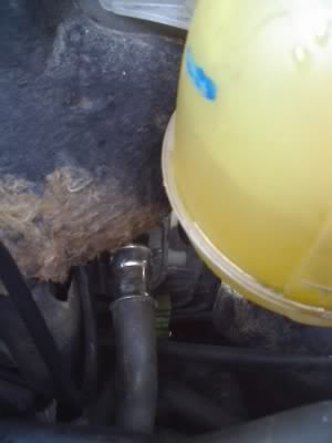

.GAZ. Car RS6+ & 40d MSport X5 Mar 18, 2010 #1 How do you get the coolant hoses off (inlet and outlet)?
F Fred@BTM Car Lionel Richie Mar 18, 2010 #2 push the wee clips in either side, wiggle and pull, bit of a fucker to do sometimes
I iimushroomzii Toilet roll king Car Transit Connect. Mar 18, 2010 #5 Cant make anything out from that pic, normally its just a case of squeezing the two cunting clips together.
F Fred@BTM Car Lionel Richie Mar 18, 2010 #6 it front of the silver bit at "3 and 9" you'll feel 2 little buttons
DannoTheGreat Car Pug 205 gti Mar 18, 2010 #7 theres small clips on the end of them buddy, its a right c**t of a job
.GAZ. Car RS6+ & 40d MSport X5 Mar 18, 2010 #8 Right, thanks! Got new ones to go on! It that a bit easier?
.GAZ. Car RS6+ & 40d MSport X5 Mar 18, 2010 #10 The new ones don't have the metal sleeve, does that make a difference?
.GAZ. Car RS6+ & 40d MSport X5 Mar 18, 2010 #12 Na, genuine Reno one mate, all attatched to the bottom pipe!
.GAZ. Car RS6+ & 40d MSport X5 Mar 18, 2010 #14 They have the black plastic clips but no metal sleeve like in the pic above!
