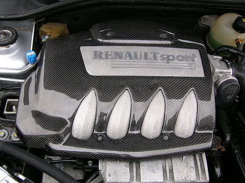

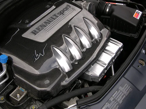

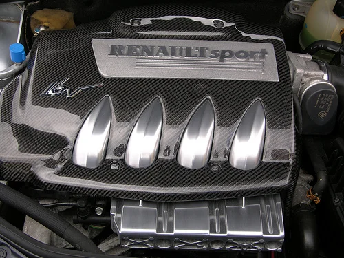

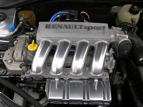

Here is some pics of my polished manifold on my Clio 172. this looks really good, but was very hard work to get it to look like that.
So what do you guys think? Was it worth doing?

It took me 2 weeks in all doing a little every night after work. I bought my self a 2nd Manifold so that I could take mine off to do it. I will be polishing the 2nd manifold and putting it on ebay in the next month or so.

wow that looks mint! i like the 16v badge on the carbon engine cover, goes good with the polished manifold.
im also interested what tools you used to do it? do it by hand?
  Clio 172 Mk2
I used Aluminium oxide paper 40 grit, then 80 grit, then go onto 200 wet n dry for ages (use it wet)
then 400 then 800 then 1200 then 1500. This can be bought at Halfords its cheap.
Then once you have done all the sanding you need to polish it with Autosol and it give you a very nice shine.

It was only £45 from ebay with postage. ive sold it on now for the same price i got it for to another Clio Sport member.
