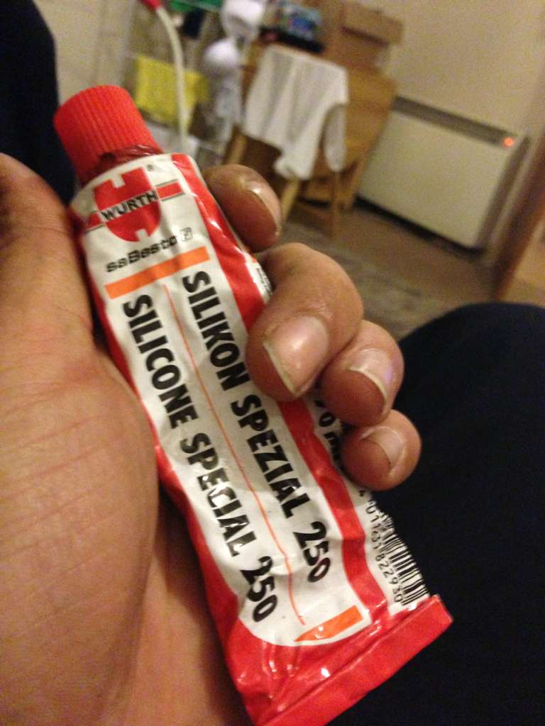

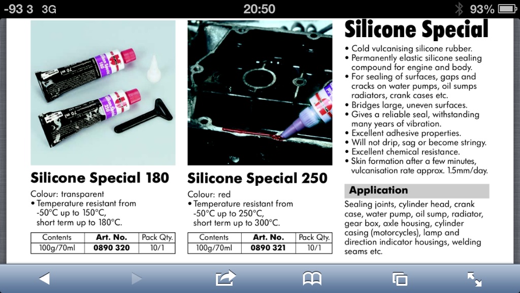

I was going to use some exhaust sealant which has been good stuff for every other exhaust problems it's just the bolts I'm missing and having trouble finding lol cheers guys
exhaust sealant causes the steel to corrode, not recommended on our systems (should've stayed in the 80's along with copper grease, horrible s**t!)
So the 2 bolts below in M10 fitment at around 50mm will do and so will this easy gasket from ECP ? ?
